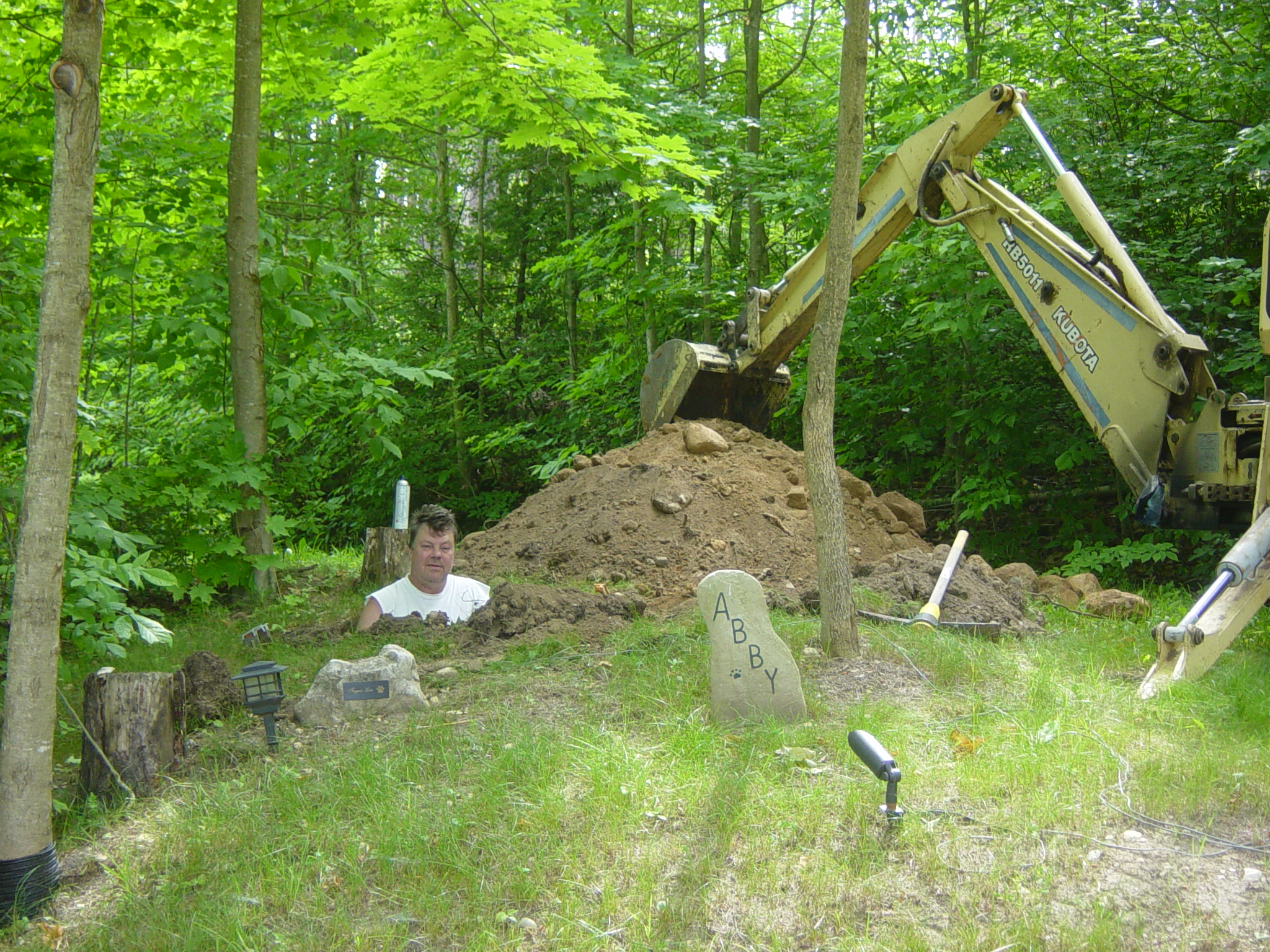

Typical little digging job around here last summer, burying a couple of pets. Put limestone sreenings back in first and then all that junk went back in. Don't remember any really large stones.
   / Should I ad a Thumb to my backhoe purchase today? #36

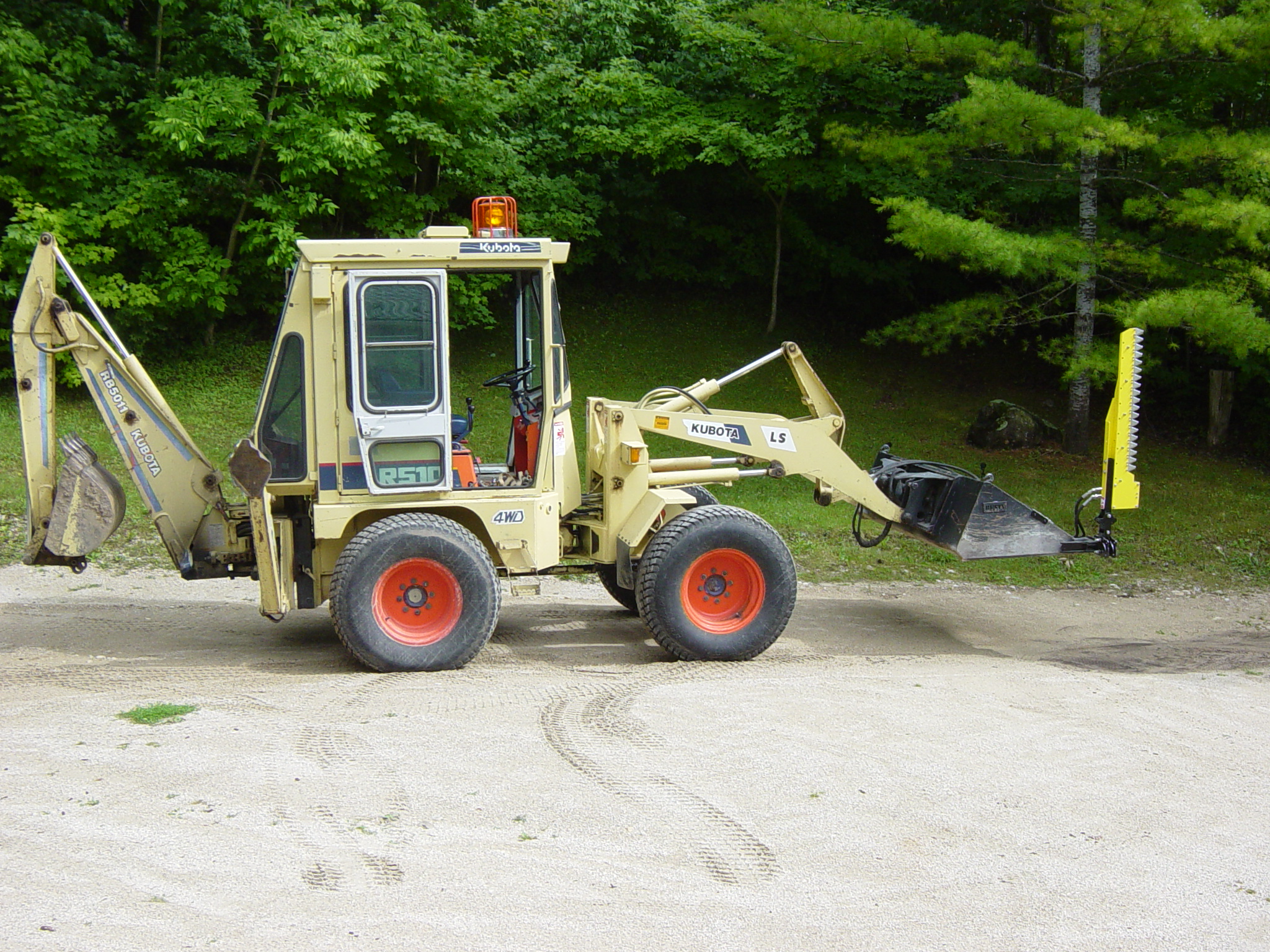

What’s that Kubota hoe? I don’t recall ever seeing one that big.
   / Should I ad a Thumb to my backhoe purchase today? #37
Yeah, a little too big. Made by Bradco. The R510 was supposed to have a smaller fold-in type hoe generally, but a city decided to order the larger hoe for a cemetary. They loaded the front wheels right to the top to try and offset the weight!
Hoe has AUX hydraulics. Painted color of city equipment. Shame!
   / Should I ad a Thumb to my backhoe purchase today? #38
What’s it mounted on?
   / Should I ad a Thumb to my backhoe purchase today? #39
It would have been sweet if the hoe went up higher against the cab. It was a bit of a rube-goldberg! It's also nothing close in size to a "real" construction TLB. Case 580 or similar.
