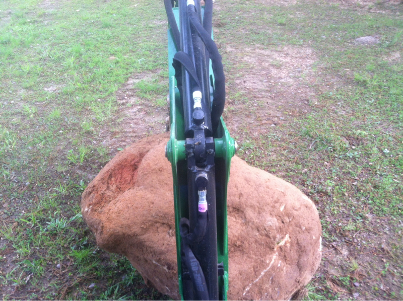

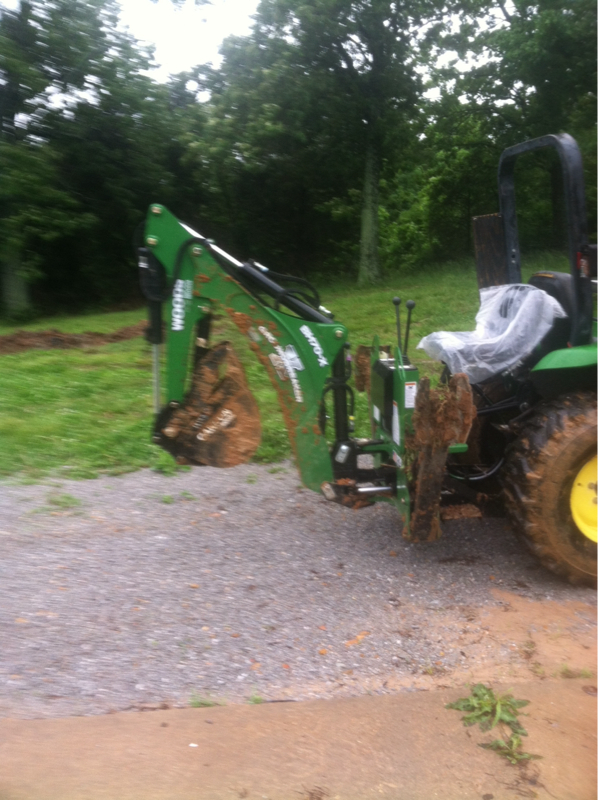

Get the thumb, I am tickled with mine! I agree with the others. 1000 dollars for a foot of digging is steep. LUTT
