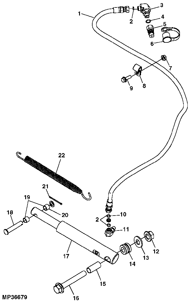

This stuff is buried DEEP!
But, here is a pic of this kit from it's instructions,,
and it does say to hook they hydraulic line into the
yellow line on the tractor, which is supposed to be
the dump circuit.

Yeah, the lift cylinder has a quick coupler, so you lose dump to raise the deck. That should be OK on this size machine.
A lot of mowing would be done with the loader removed, this is a finish mower, not a shredder.
If you did have the loader on, your probably gonna use it to pick up rocks and stuff, and don't need to dump (as much)
hey, a diverter would be nicer, but this is an option.

</font><font color="blue" class="small">( Yeah, the lift cylinder has a quick coupler, so you lose dump to raise the deck. That should be OK on this size machine. )</font>
So how do you hold the mower up with the loader coupler connected? What about mowing with the loader on? Would you dump the bucket and drive around with the loader raised so it does not drag on the ground. If they are going to do this, they should have done it with a diverter or some independant control, this does not seem like a great way to plumb the cylinder.
/ SHHHHHHHHHHHHHHHHHHHHHHHH
#51
It's just one hose,, unplug the bucket dump cylinder hoses, it shouldn't go anywhere with the hoses unplugged, and mow. when you need the loader bucked curl and dump function again, just unplug the 1 hose and replug in the 2 for the bucket... ????

When I read the first few posts on the independent mower deck lift I thought it to be like on the JD755. The mower deck lift cylinder on the 755 was operated by the curl circuit of the loader but did not require disconnecting or reconnecting hoses. With both implements attached if you wanted to do loader work without moving the deck, you raised the deck all the way (full bucket curl) and then rotated the height adjuster full clockwise (about 1 1/2 turns from the cutting position) to lock the deck in the raised position. If you wanted to use the deck with the loader attached JD provide a pin for the bucket to keep the bucket from moving. This was not really necessary because the bucket dumped only slightly when the deck was lowered.
The need to connect/disconnect hydraulic hoses on the new series seems like a design leap backwards.

</font><font color="blue" class="small">( It's just one hose,, unplug the bucket dump cylinder hoses, it shouldn't go anywhere with the hoses unplugged, and mow. when you need the loader bucked curl and dump function again, just unplug the 1 hose and replug in the 2 for the bucket... ????
)</font>
You know, some enterprising and inventive soul will figure out how to make some sort of a "t" adapter with a valve to divert oil from one circuit to the other. So you don't really lose much time if you need to "dump" while mowing all of a sudden.
Just a thought.
