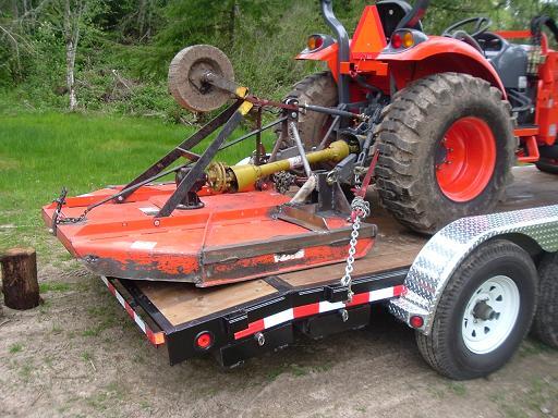

I have never broken a shear pin on this mower. Check out the photo. The yellow slip clutch is pretty cheap at agrisupply.

Swinging that wheel up saves me from a big overhang and the potential legal hassles with that. I trailer a lot of miles and like having that wheel swung up. The tailwheel doesn't pivot around either, it just sits there.
The slip clutch is held on by the former shear pin. You use a strong bolt though so that it won't shear. I ordered my RC with it so I didn't have to do the install but the PTO shaft might need to be shortened a little.
This doesn't explain why the poster's shear bolts are shearing so easily though.
