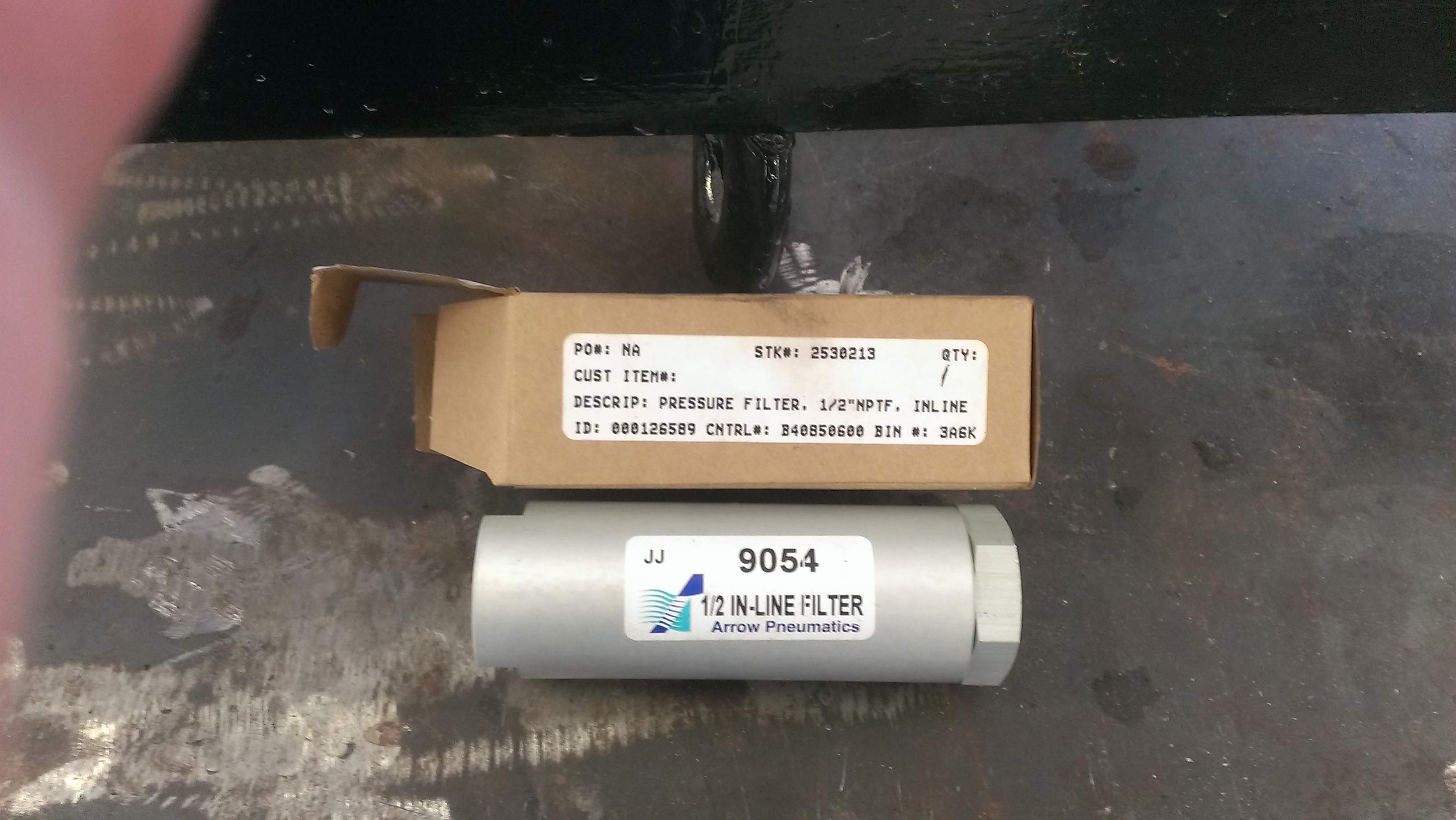

I think the fluid issue has been answered. My question pertains to using your grapple on both the tractor and SS. Is the GPM flow the same / compatible for the SS and tractor. Most SS are hi flow and tractors have a lower flow. Will that damage the grapple running it on the SS. Will you have to install in line restrictors to safely use it on the SS. Maybe JJ can answer or offer his opinion on this.
/ Sharing Implements between tractor and SS #14
Some skid steer's have a low flow and a high flow.
If so, just reduce the engine rpm for slow GPM to the grapple or use a needle valve in the circuit. A specific needle valve can make the grapply close slow, and open fast.
High flow will make the grapple much faster.

Wow, lots of new valuable info here. I tried hooking up a pressure reducing cross over valve since my supplier didn't have a pressure reducing valve. I couldn't get the pressure to drop so must have had something wrong. The pressures were reading 2500 to 2700 psi and the cylinder is rated for 2500 max continuous so I said to heck with it and just hooked it up directly. If the cylinder gets wrecked I'll get a new one rated for 3000 psi. From the info I can find on the Net this has a low flow auxiliary rated at 15 gpm and I didn't think that would be an issue. I was more concerned about the pressure but now that I've used it on the SS I think the flow may be an issue too. The lid snaps open and shut, so I just give it a short tap on the control lever to move the lid. Maybe a needle valve would be the answer or a pressure reducing valve and a needle valve. This is getting a little more complex.
/ Sharing Implements between tractor and SS #18
Needle valve or flow restrictor.
Maybe 1/4 in cyl hose.
