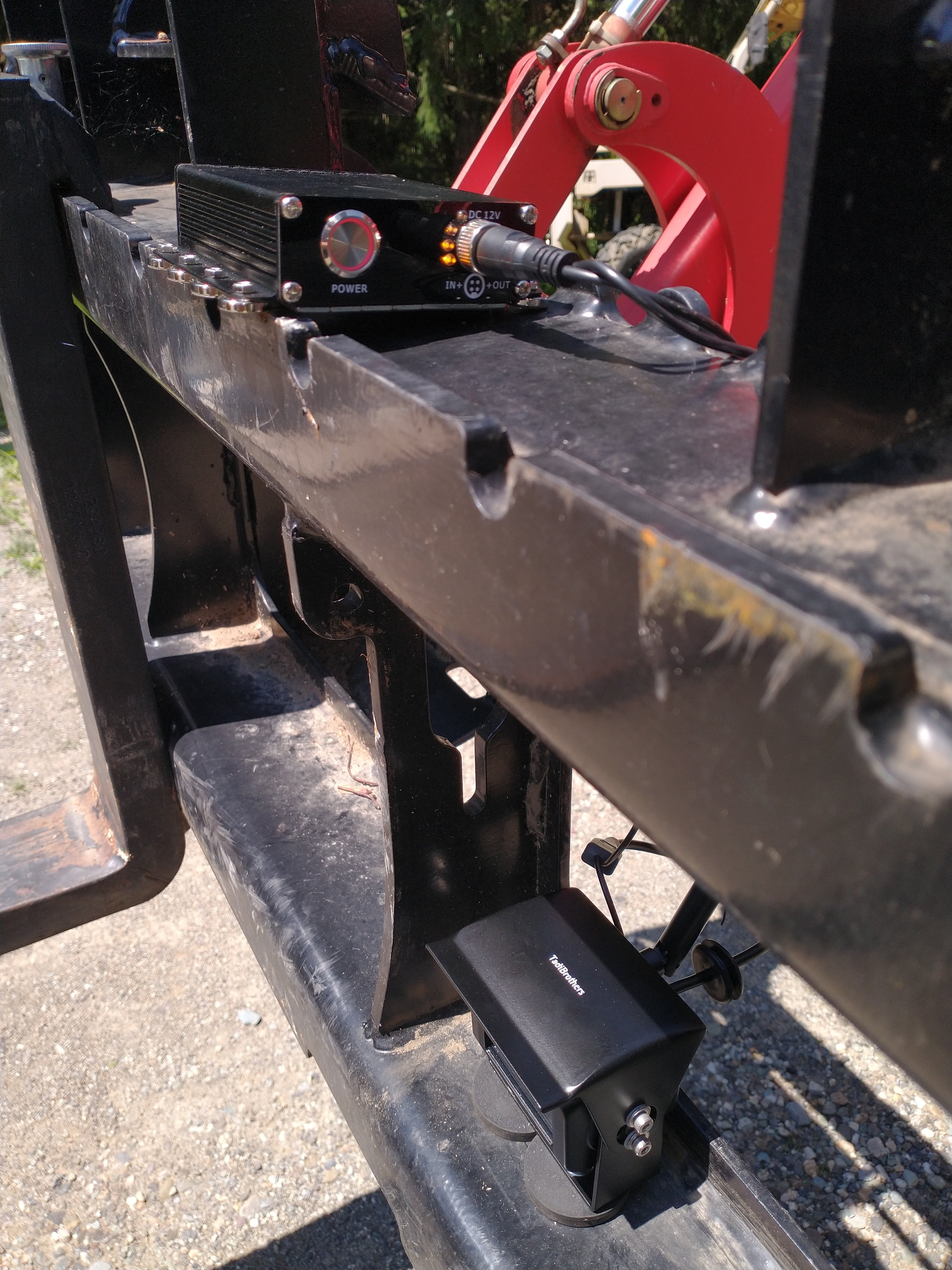

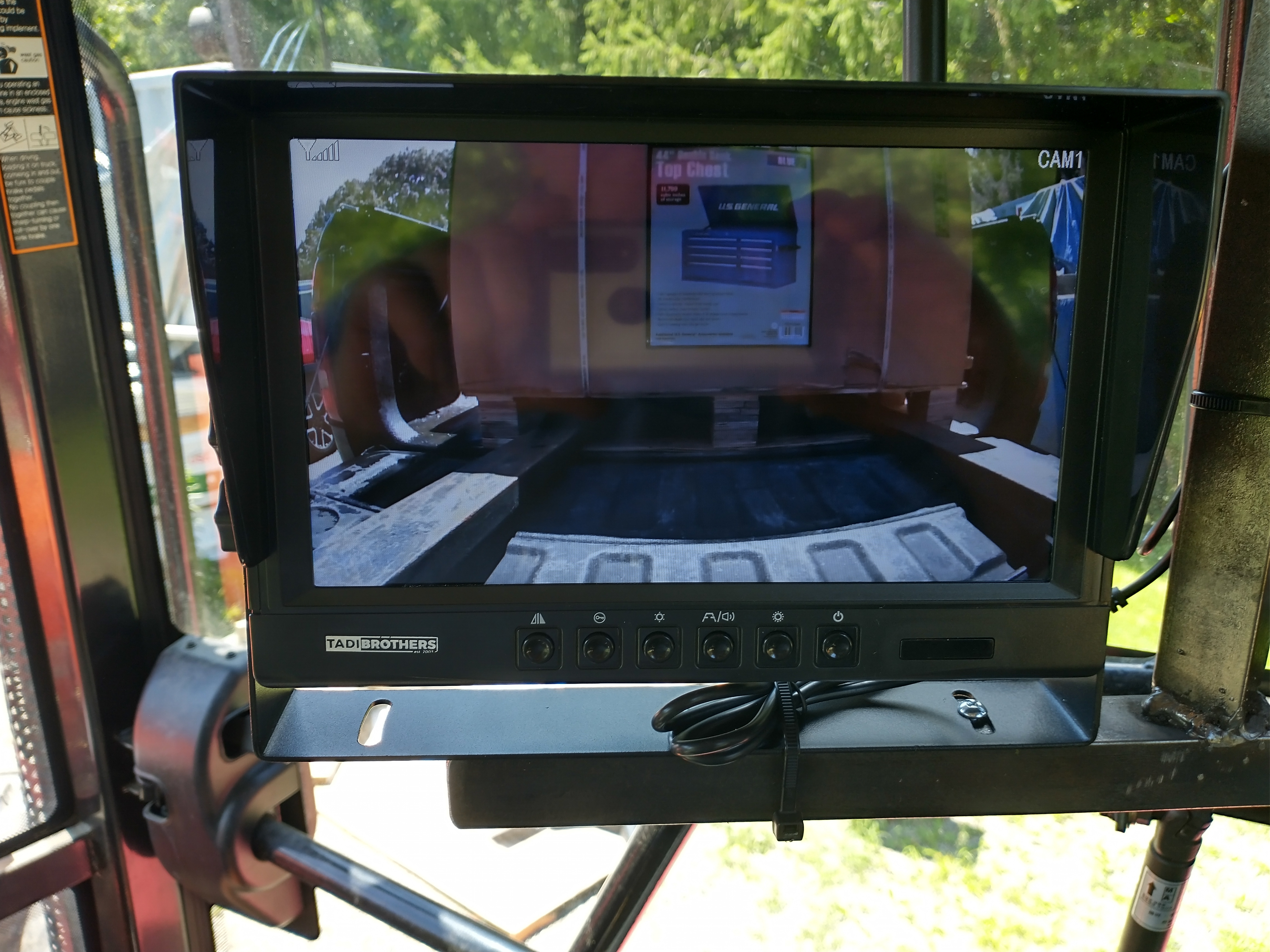

I have a wireless camera setup in my Branson that works fairly well.
There is no way I can even start to see the forks from the seat,
the camera has it's own battery power supply.

I need that. Any recommendation on brand and model would be appreciated, even if it's just knowing ones to avoid.
   / Share Pics of People Hauling or Towing Something Wrong #22,756
That one is a Tadibrothers setup with a large monitor, and the battery pak for the wireless camera. The screen along with the magnetic mounted camera and magnetic battery pak are very handy and work well. I had an issue a while back with a battery pack that failed and their customer service and so called warranty P.O'd me so much I have resorted to trying different ones.

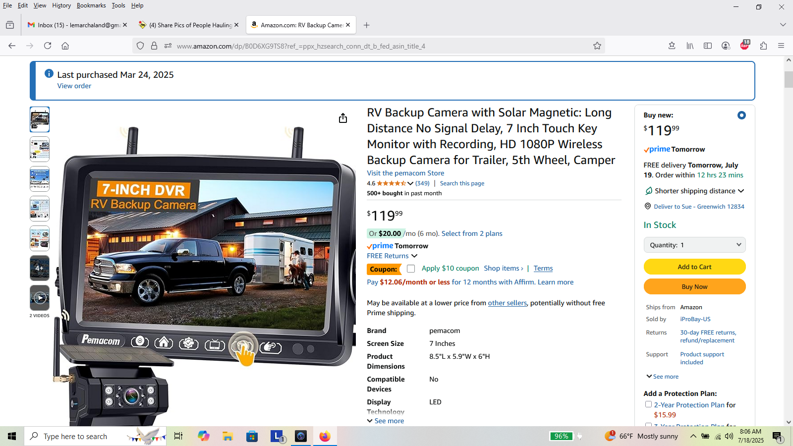

I got this one this spring to use as a backup camera on my trailer and while it's not quite the resolution of the much more expensive unit it seems to work well the few times I've used it. Normally I back the trailer around just using mirrors but occasionally it is very handy to see behind it in tight spots.

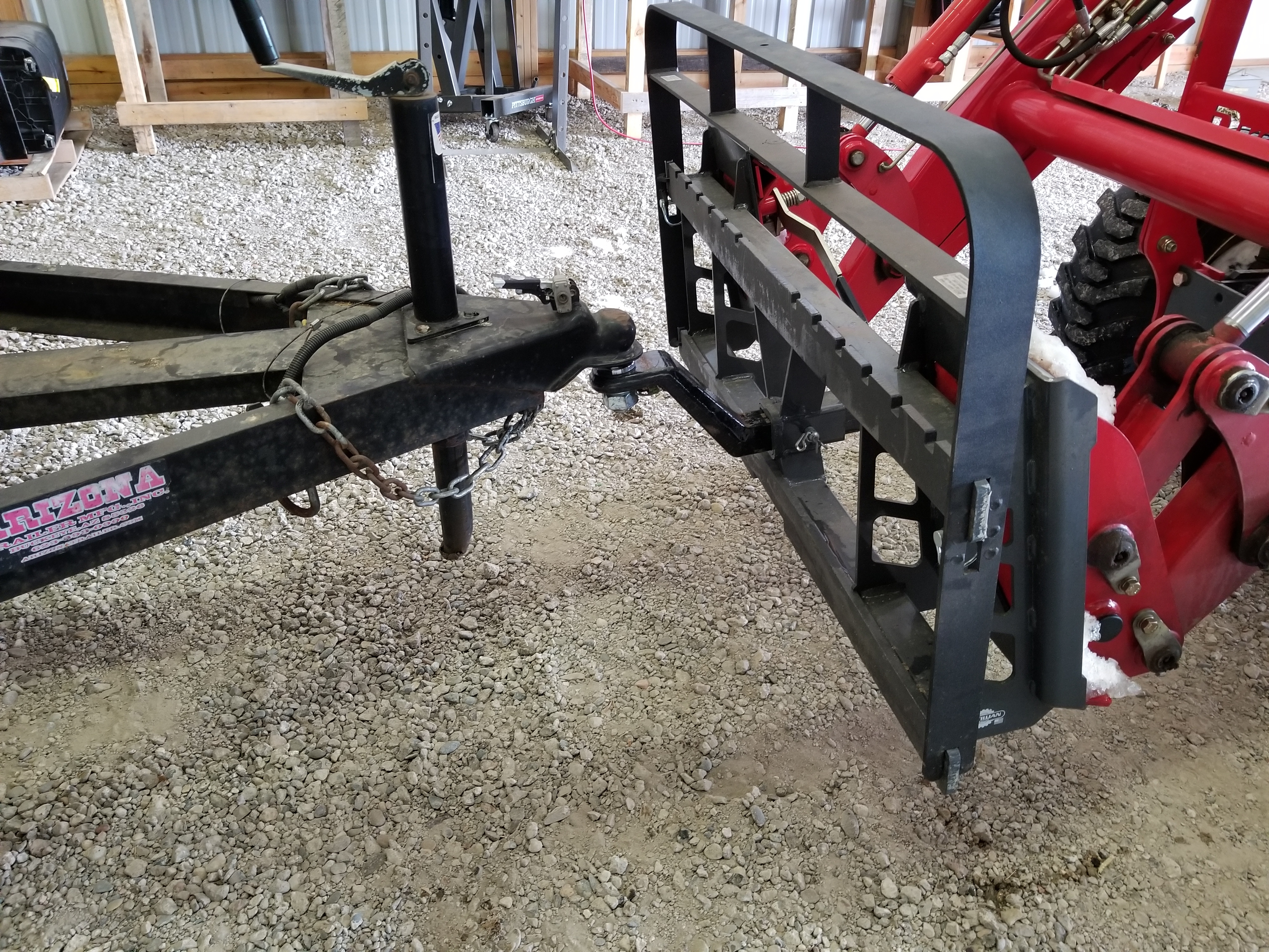

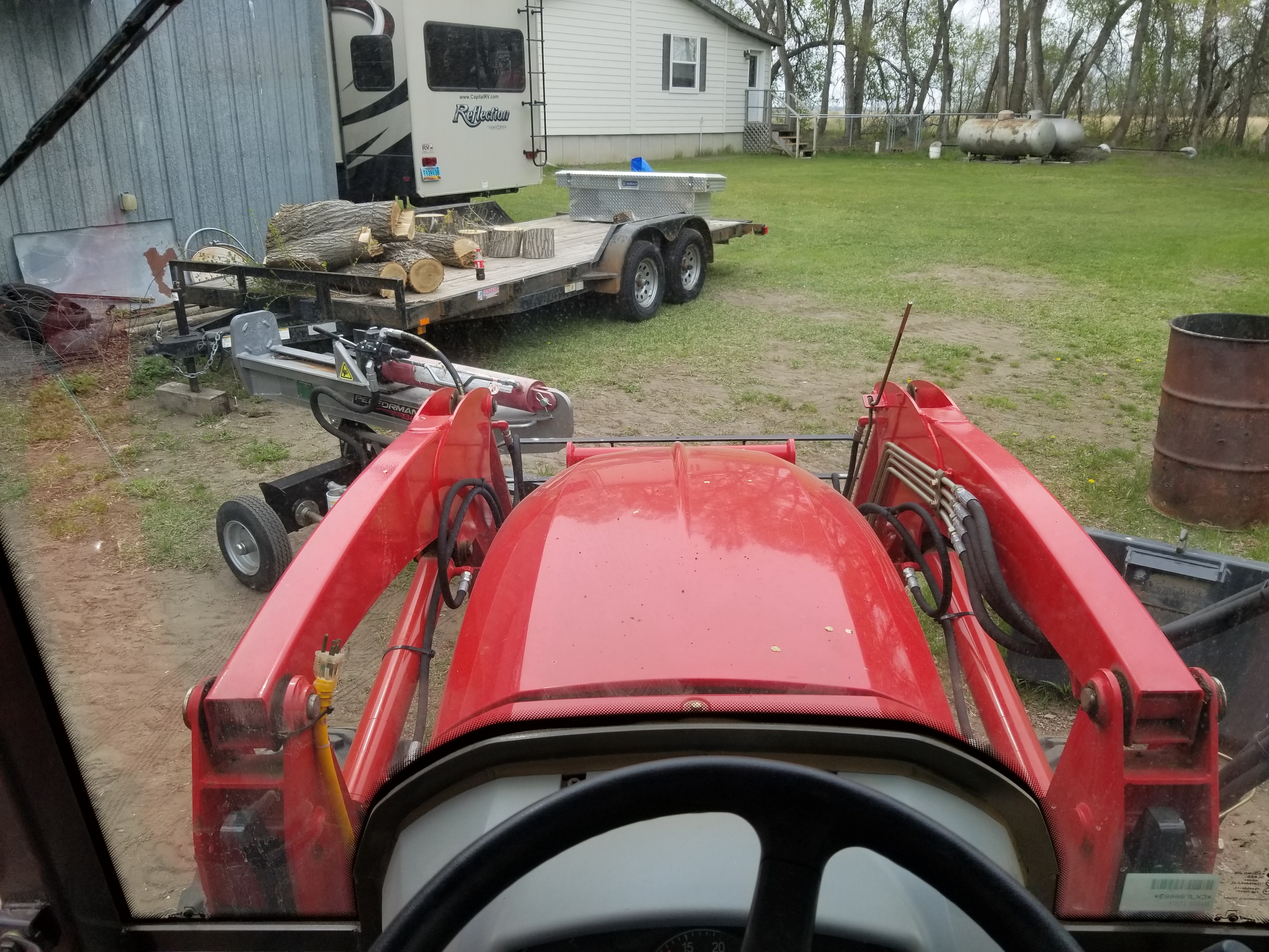

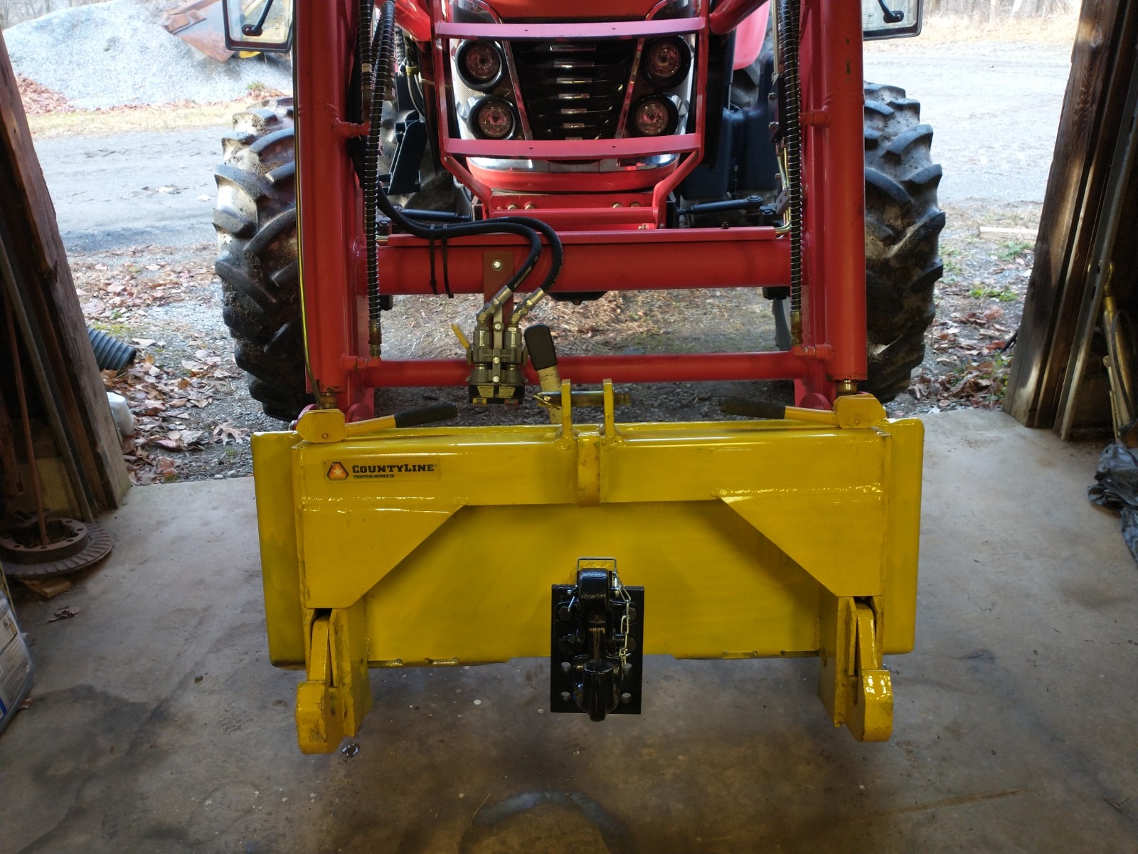

I have a similar unit;
I very seldom use it, and I quickly found out that I needed to use my camera when trying to hook up to it.
View attachment 3797669View attachment 3797670
It wouldn't help on yours, but on the more open style like mine, I find it's helpful to raise the loader up, then tilt the hitch forward. That way, I can look through the framing and see the hitch ball to line up. Once under the hitch, just raise the loader and curl back.

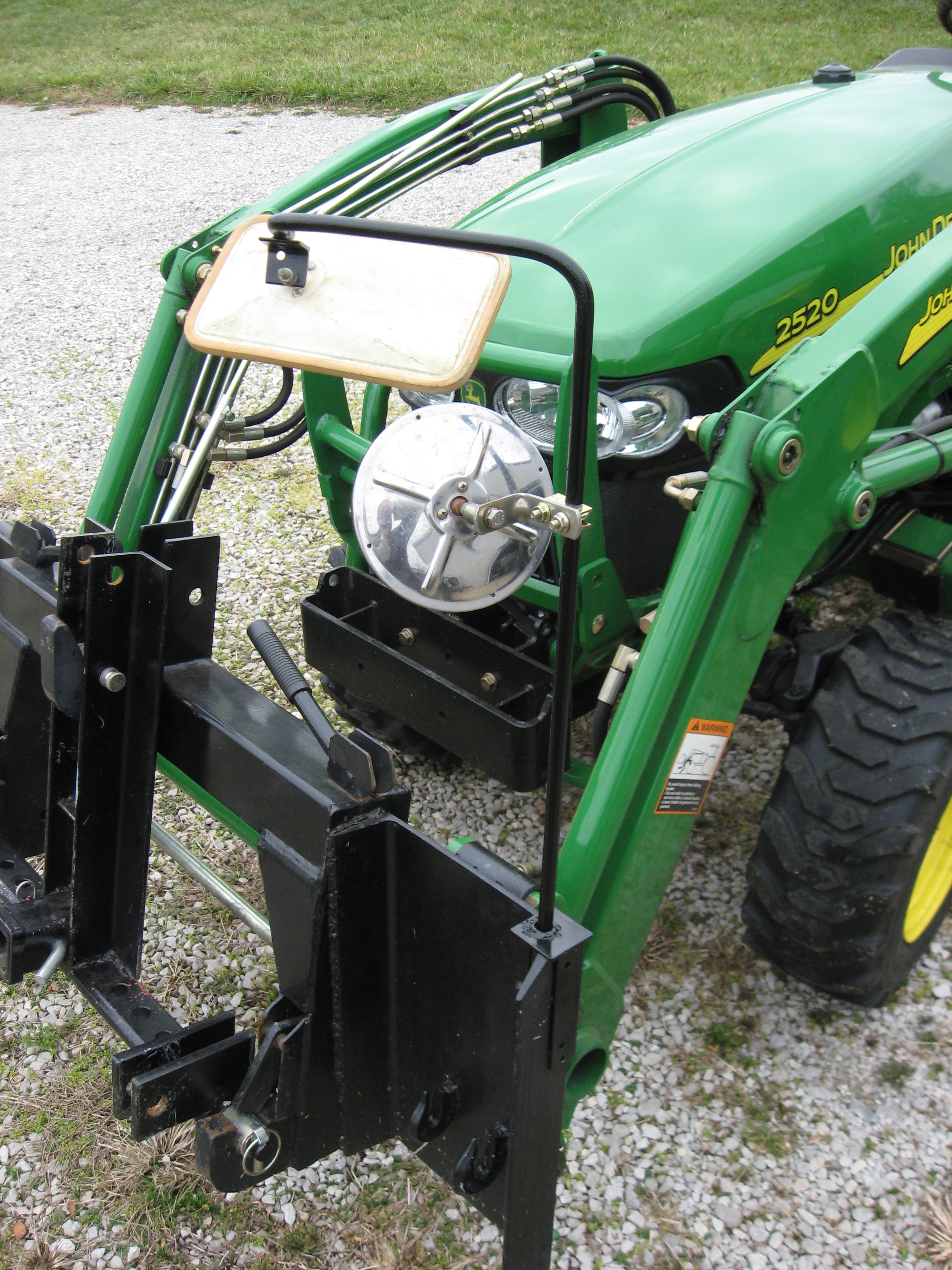

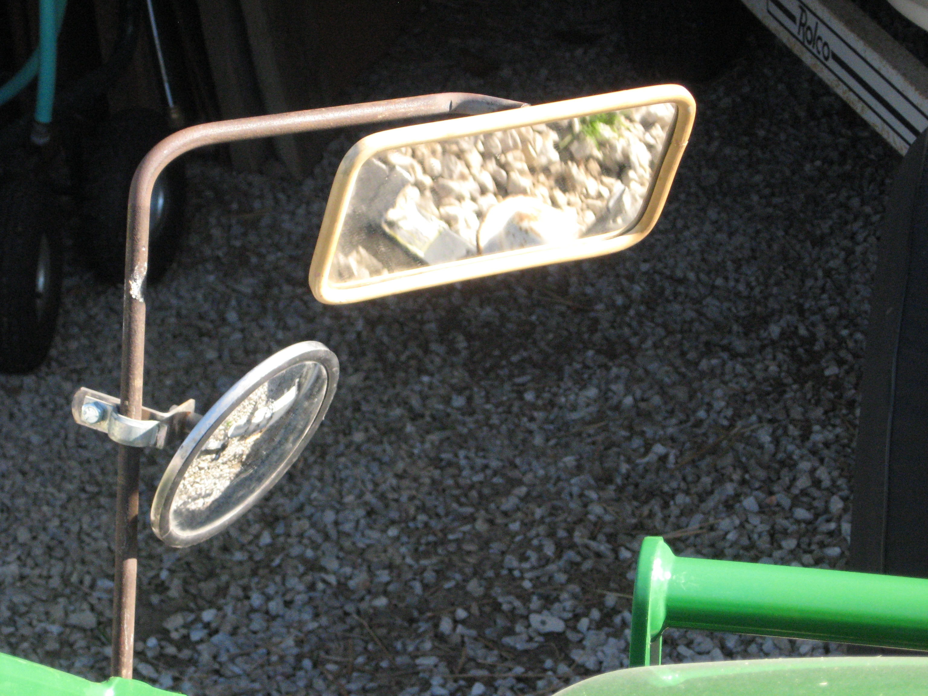

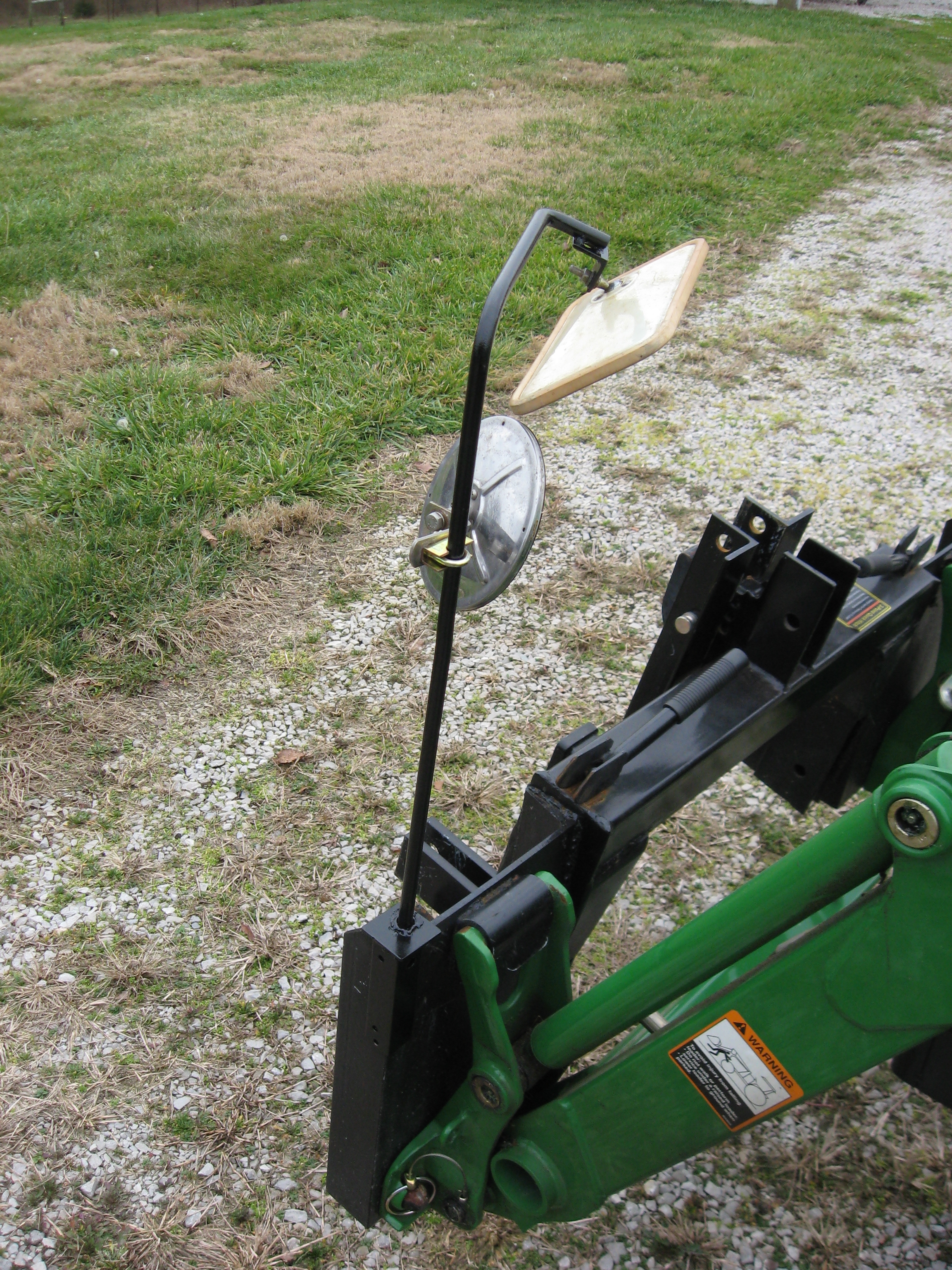

In the interest of never-ending product improvement, I even made up a slide-on front quick-hitch mirror.
It works, but not worth the effort to install/remove.
Great minds think alike? I did the same for my pallet forks. And like you, found it works great, but would require a pretty big job of moving a lot of pallets to make up for the time lost in setting it up and re-adjusting the mirror positions.
