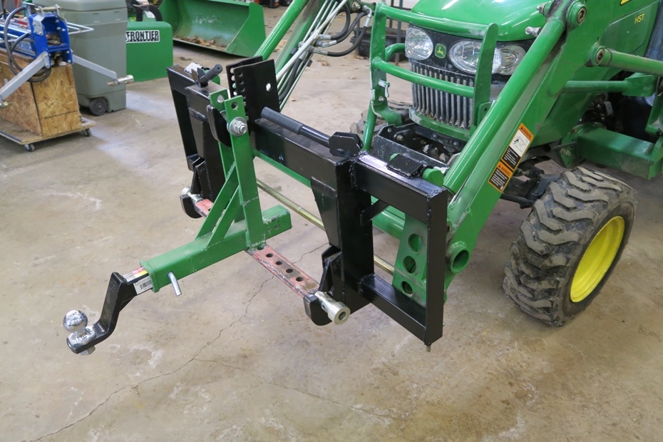

If you are concerned with the strength of the bucket for towing, it might be easier to make a loader mounted quick hitch to mount the receiver/hitch on. I pull all kind of stuff around with mine (no, I wouldn't pull a 5000lb boat around on a hill with it, but you get the idea).

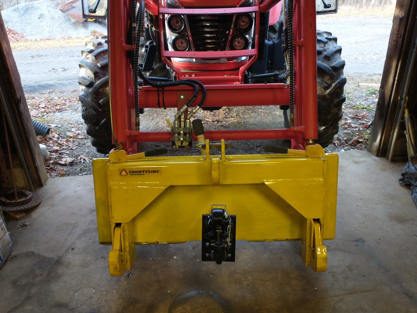

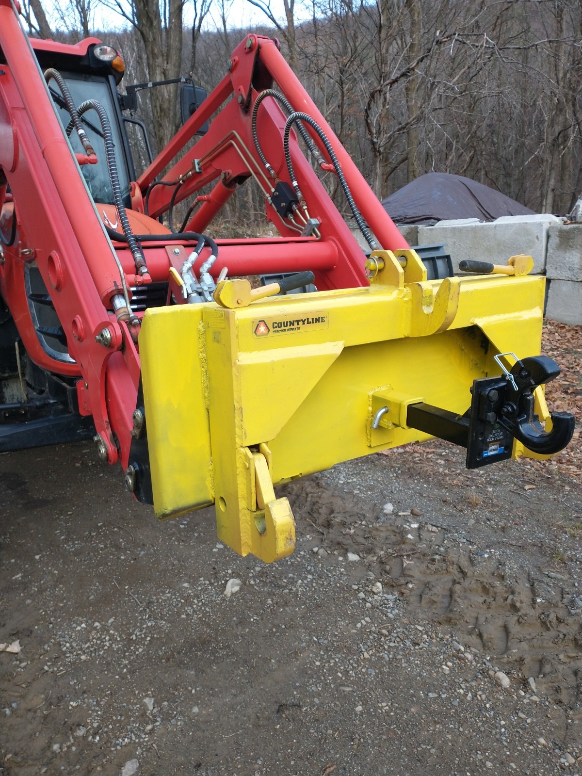

I've got a loader mounted QH for my tractor. Of course, you don't have a bucket when it's in use, but it seems about as stable as a rear hitch when towing.

I have a similar unit;
I very seldom use it, and I quickly found out that I needed to use my camera when trying to hook up to it.
