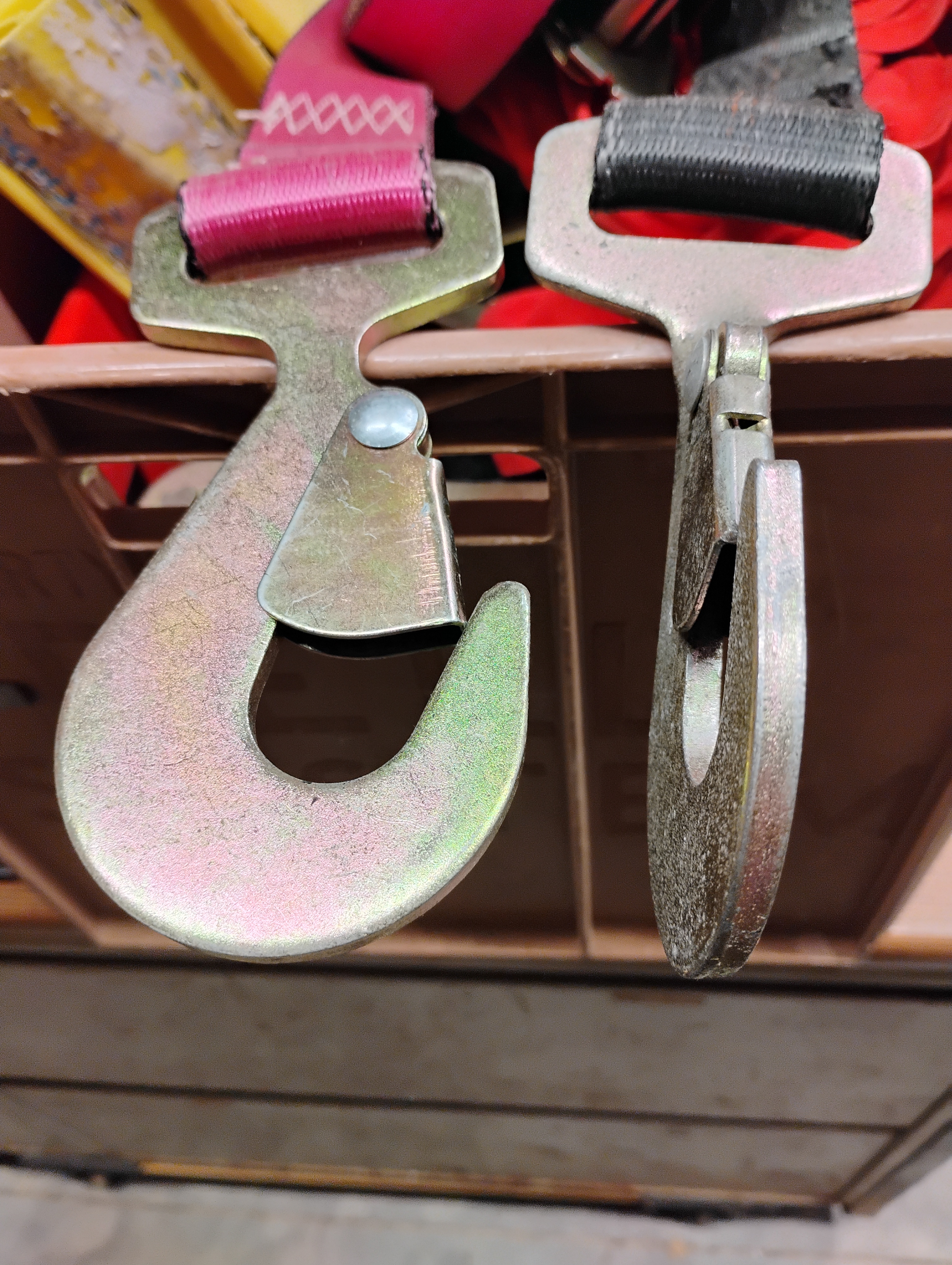

Snap hooks are great, when they're new! But I've yet to meet one that I didn't destroy inside of a few uses. I usually end up cursing myself for buying those things, as I busy myself with a grinder, converting them to regular hooks.
Are you talking about snap hooks like these two inch ones? These are six or seven years old and still in great condition. I never throw the hook. If I am going over something while tying down, I throw the rolled up webbing over.
While using them, I either clip them onto a "D" ring or run an axle strap through a stake pocket, etc. then clip the hook onto the axle strap rings.
There were times when I managed to distort the thin material of the clip, but it was easy enough to make them work again. These days I have better anchor points (like QRTRHRS) and haven't had any issues.
I still have and use my first ratchet straps from the early '90s. They must have several hundred uses on them by now. Have largely switched over to the twisted hook version, and lasso straps and/or wheel nets, but regular ratchet straps are also still used, almost every time.
Have seen way too many straps with open hooks that have come off, either along the road or as people arrive in camp - thankfully, so far with their vehicles still on the trailers.

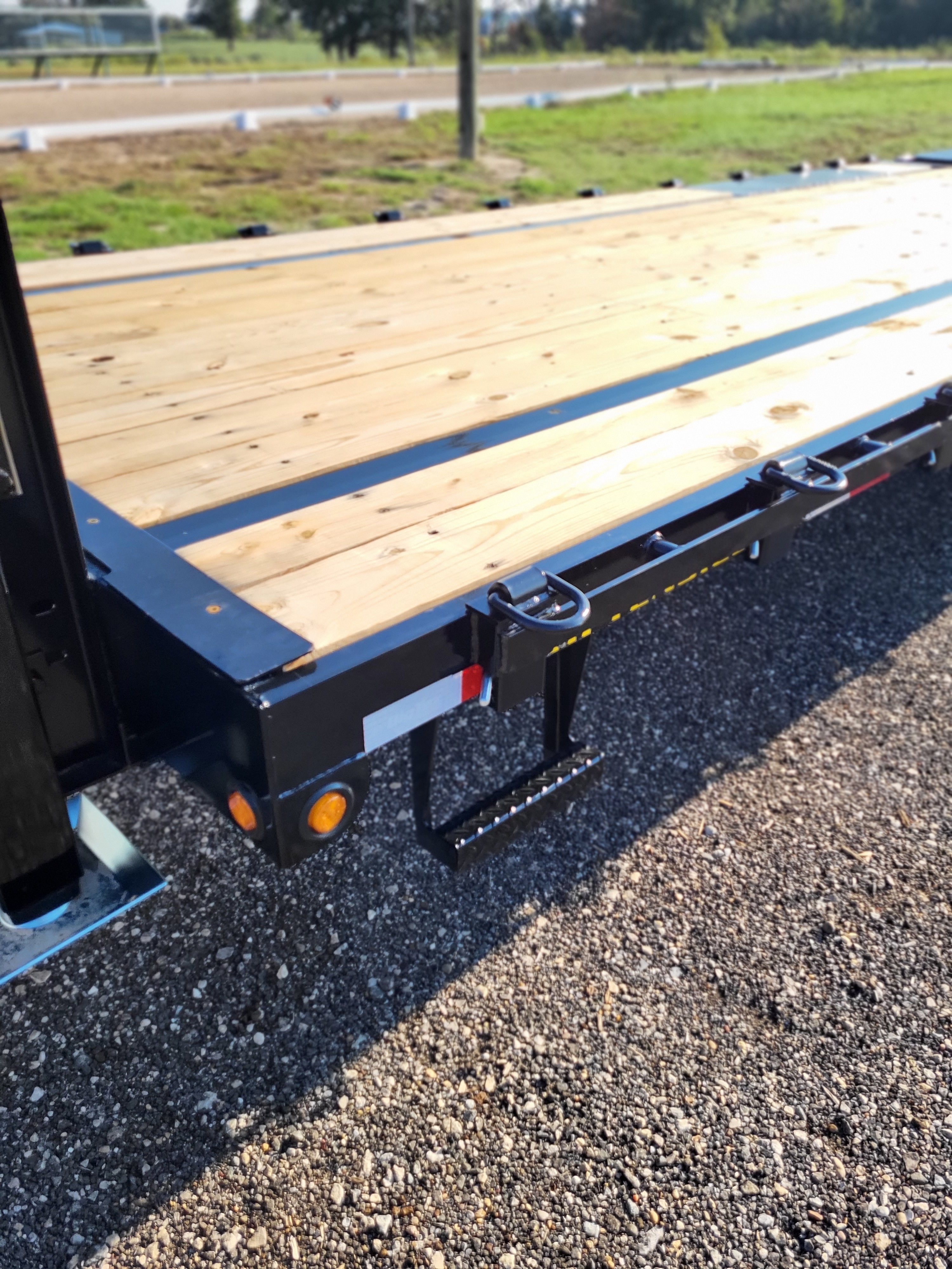

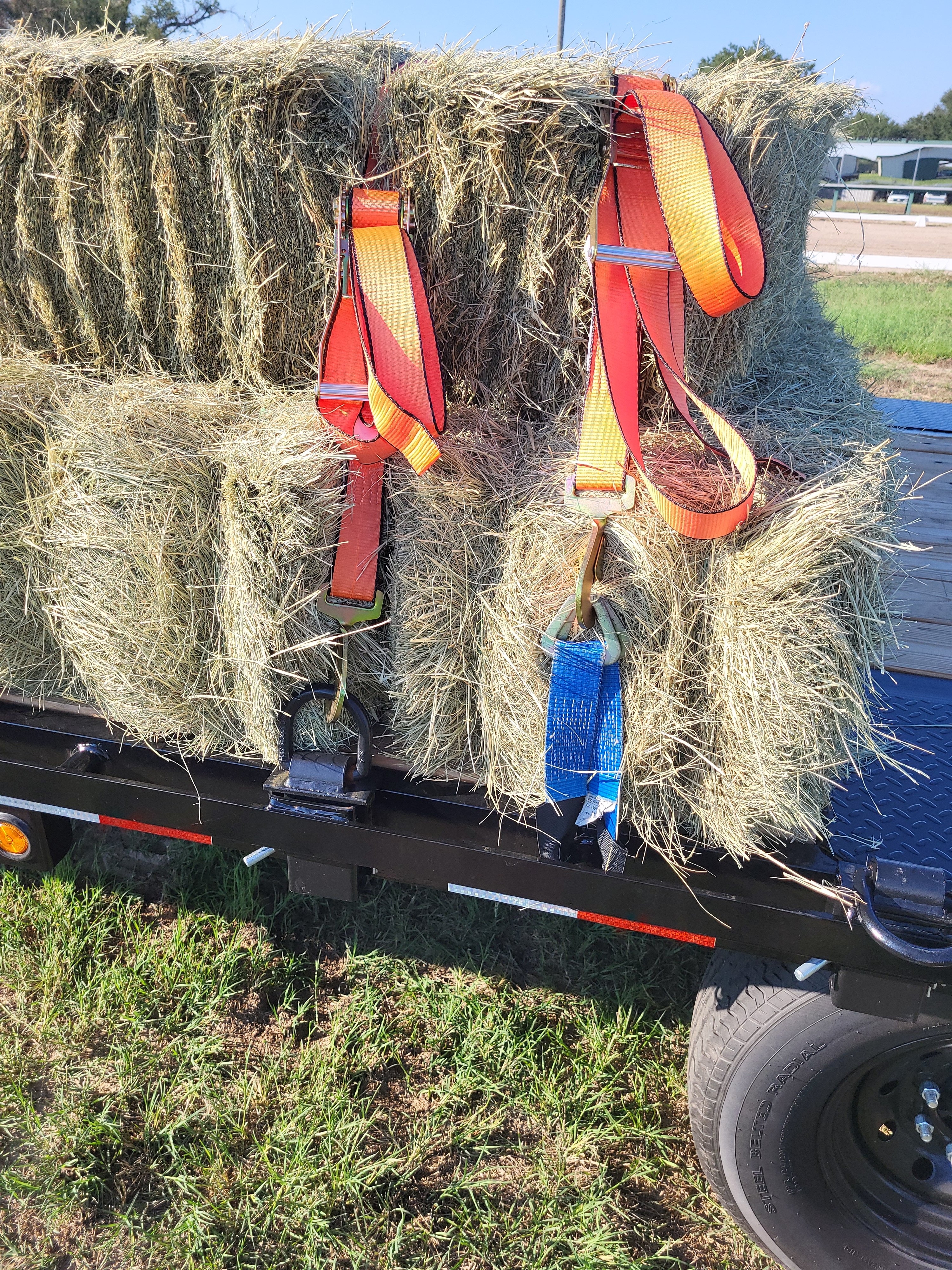

I wear out or cut the strap before my hooks fail. Mine come from Custom Tiedowns. Not cheap but worth it. I have d-rings in all the stake pockets and use axle straps in between on the round rub rail support.
