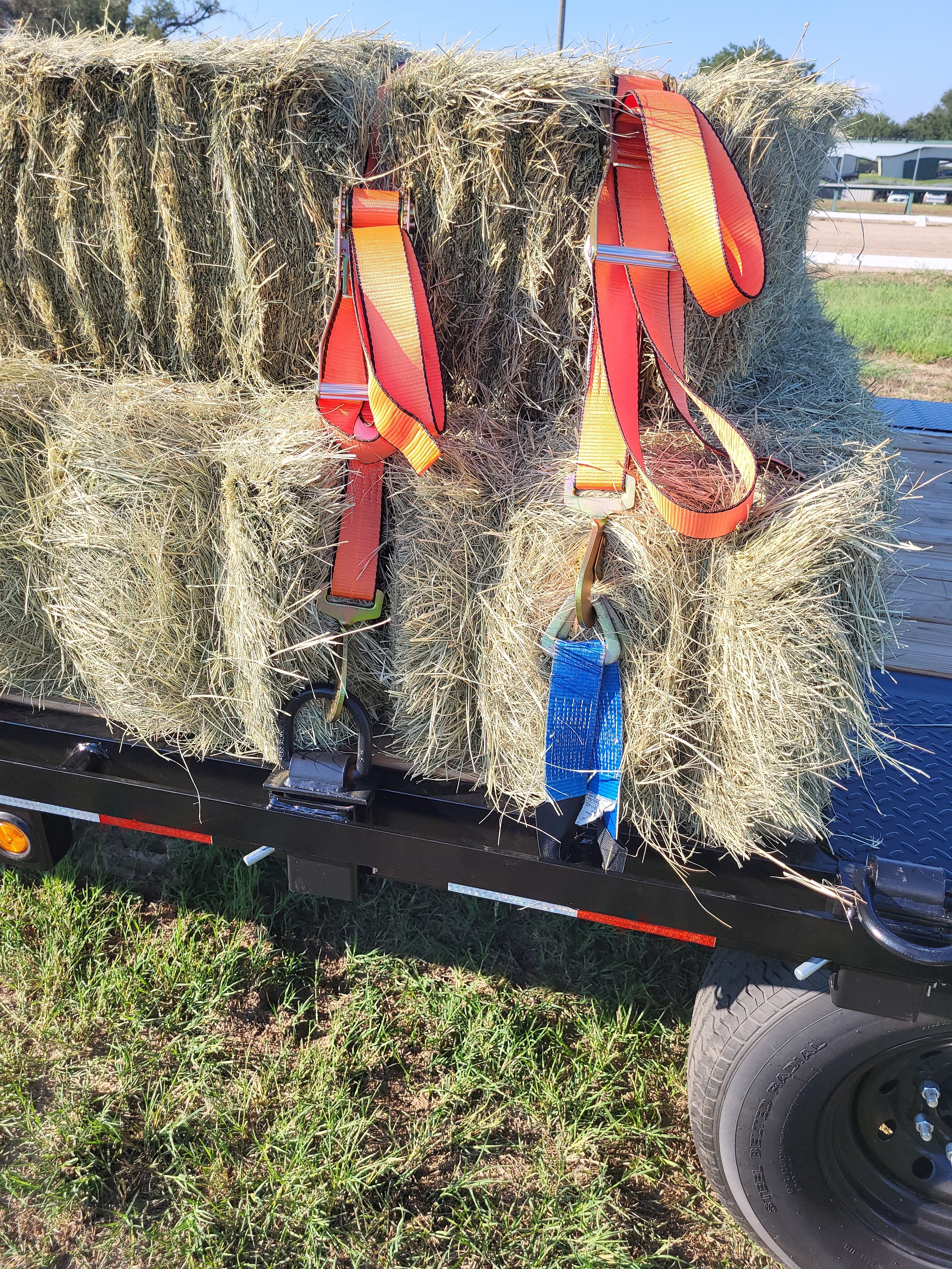

I just make some loops with the tail and slide in back thru the ratchet. Then I lock the handle down. Never have issues.
Don’t want to go down interstate with hay bales, but at any speed I wouldn’t want those loose loops flapping.
If a tight strap is not flush with a surface it helps to have a half twist so it doesn’t fly/flap in the wind. Such as when securing a motorcycle to the trailer.
If they have the large loop where the strap is sewn to the binder, I'll loop the excess and slide it through the gap and the tighten the binder.
If not, I'll roll the excess up and slide it between the strap and the load before tightening.
On sketchy stuff that needs a little extra something to secure it, I'll tighten the ratchet strap down and use the tail to lash around the load and tie it off for extra load securement.
I do this especially for my propane tanks to keep them upright and stable.

Carry rolls of "electrical tape" to take care of those loose ends. Can also help with the storage of straps.
Small bungy cords work well for this as well and the bonus is tou can reuse them.
