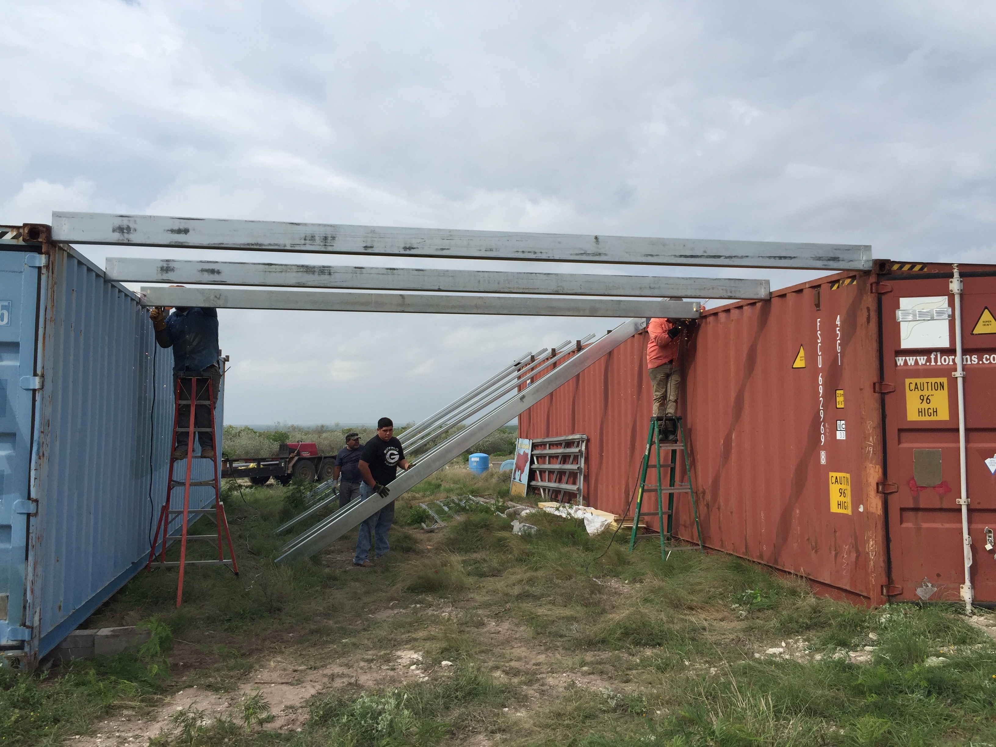

Setting some trusses

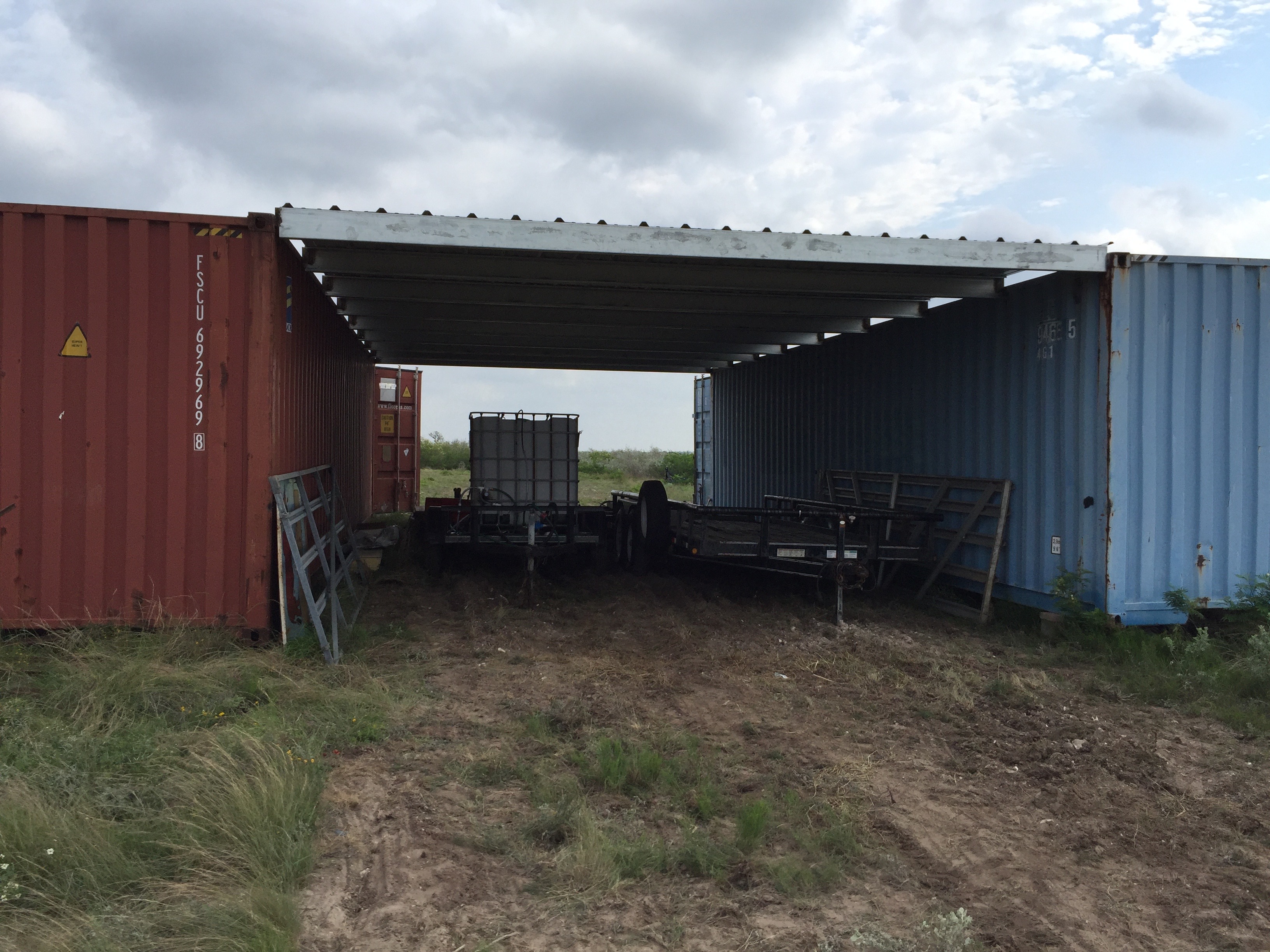

That turned out really nice!!!
   / Setting some trusses #16
Very Nice... Wish I had the budget to do that between my containers..
I had too poor boy it..

Why did you weld to the side of the container instead of resting the beams on top of the container and then welding them in place there?
   / Setting some trusses #18
We used 20’ 8 inch purlin. Fit perfect in the space. We welded Clips to the containers to hold the purlin..
Again... On a poor boy budget...
