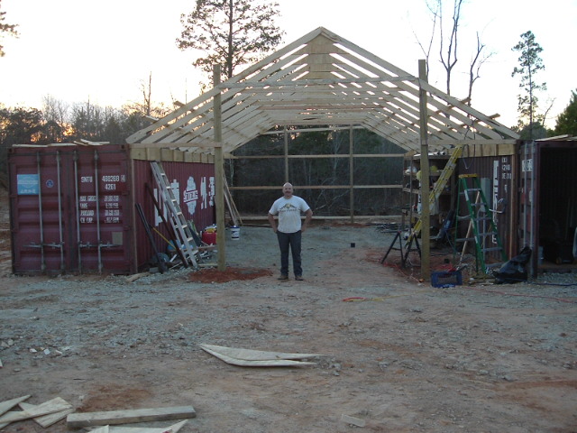

I thought I'd post this video my wife took of us setting some trusses over a couple shipping containers. My idea is to extend these trusses to the far end of the containers to completely cover them. The crane was made with receiver stock (2" x 2" x 10'). with two 3" x 3" x 3' pieces of steel tubing just slipped into the space between skidsteer mount and loader to provide tension. The 10' pole slips into the receiver end on the skidsteer mount. Attached to the pole is a Harbor Freight 2500lb winch which I picked up on sale for $50. It comes with a remote control, which makes it very easy to use from any angle. The hook was just a piece of 1/2" steel rod bent in a position allowing me to unhook it without having to climb anything. Excluding the receiver mount, my total costs for this crane was less than $200. The job went very well, maximum weight of trusses was 202lb.

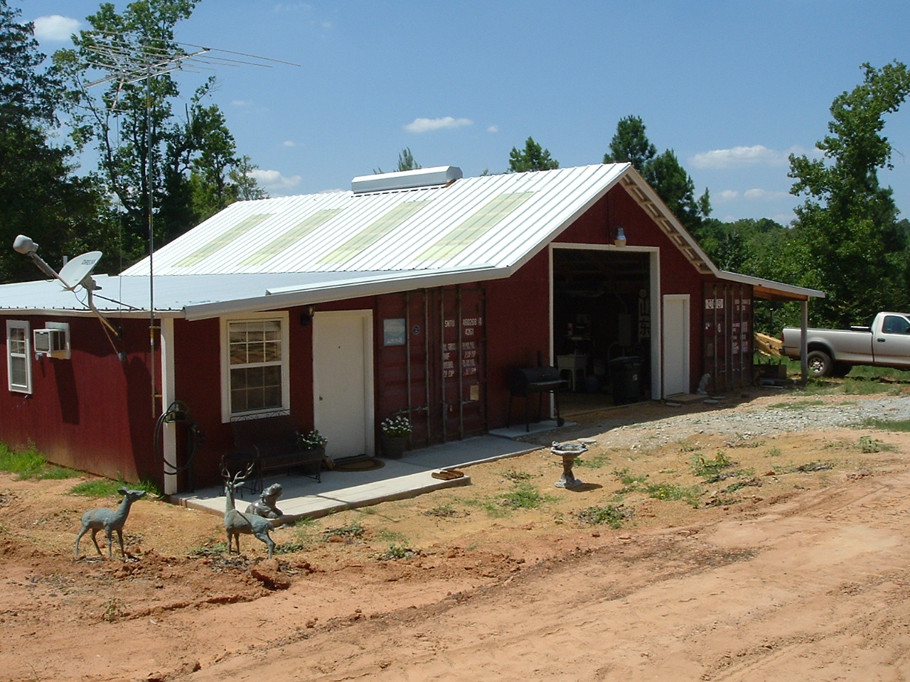

I did something similar about 15 years ago. I set the containers 24 feet apart and then attached a 2x12 to the tops of the containers with carriage bolts to give me something to attach the trusses to, and make sure that the trusses where perfectly level. Getting two 40 foot containers perfectly level proved to be harder then I expected. I was close, but they where both off a little bit. Then I extended the trusses with joists over the containers, and off of the outer side to get another 12 feet of open storage on one side, and a one bedroom home for me to live in off of the other side. I liked being able to lock up stuff in the containers while I was living in town and not able to keep an eye on my stuff. I also like the instant wall that the containers gave me and not needing to pour a foundation or set poles.

I'll post pictures as soon has I get the ends finished. I ordered the trusses from a local company, 24' was the longest I could carry myself. There wasn't a way for them to get a boom truck in. Metal roof being ordered today. On top of each container I welded in bracket to hold some 32' long glulams, they extend out the back 11', giving me storage behind each container. I'll use these to park trailers, tractors, etc.

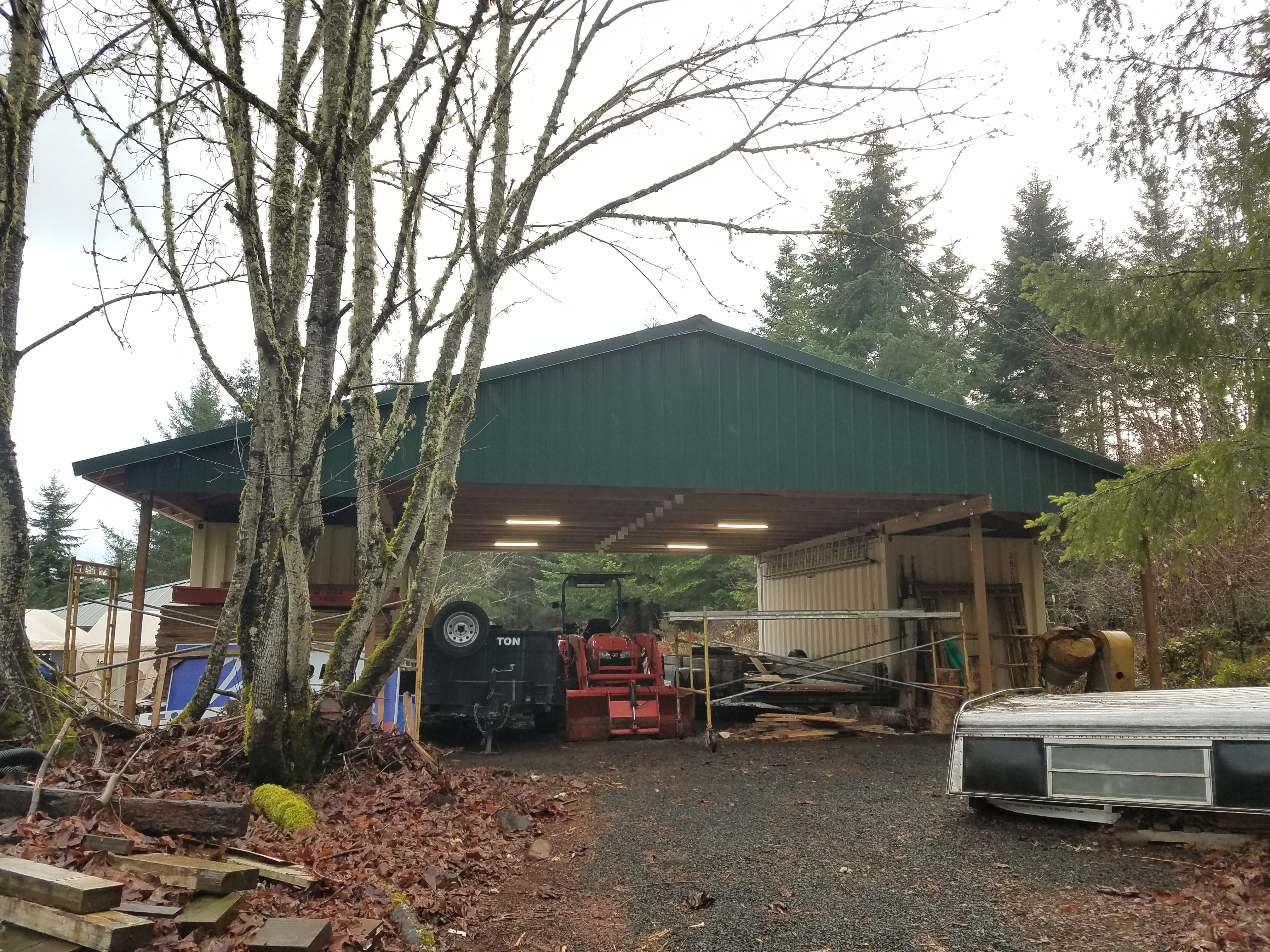

I paid $2.88 a linear foot. Don't forget all the other trim/screws that completes the job, that'll boost the final price tag. I live in Washington state, so on top of high construction costs, add another 10% for state/local taxes (They can never have enough taxes here).

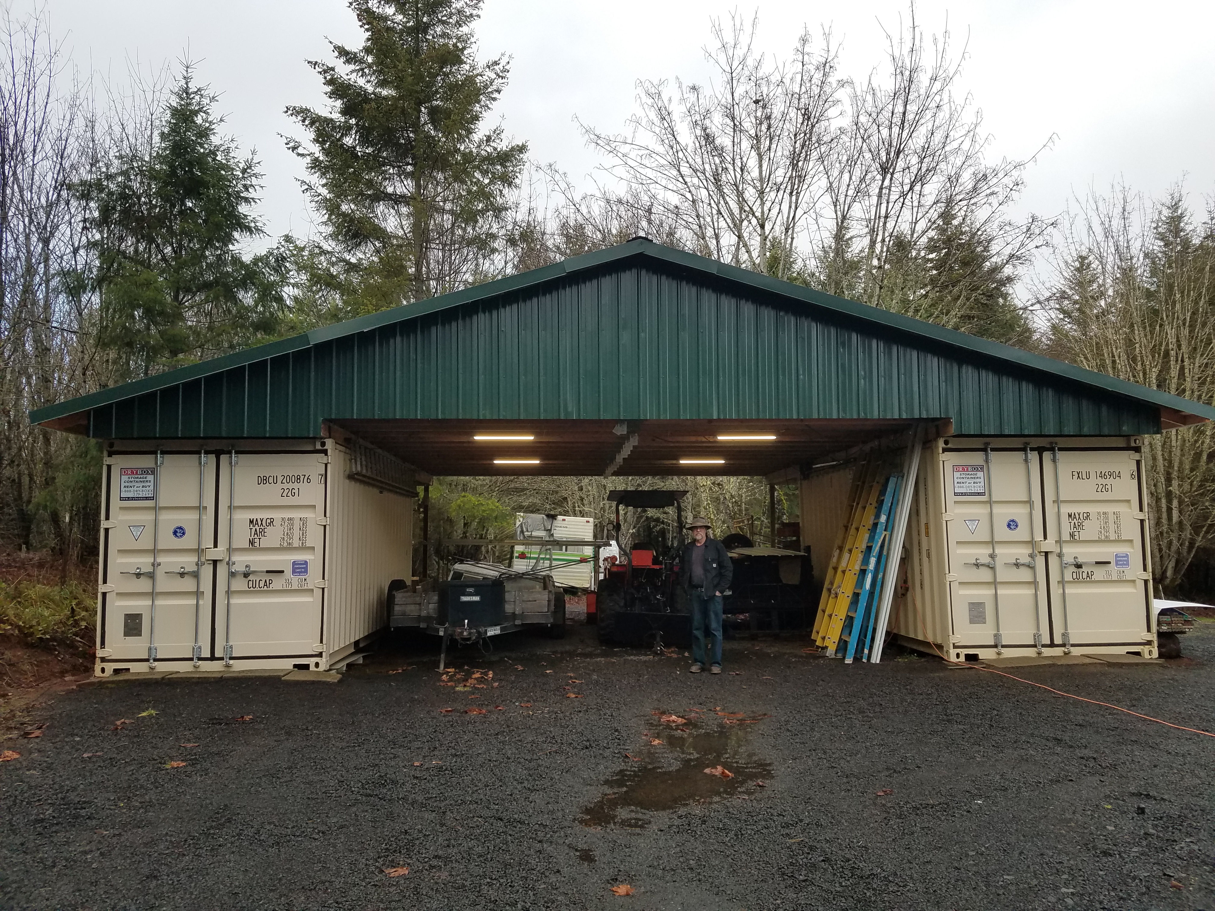

I had too poor boy it..

Why did you weld to the side of the container instead of resting the beams on top of the container and then welding them in place there?
/ Setting some trusses #18
We used 20’ 8 inch purlin. Fit perfect in the space. We welded Clips to the containers to hold the purlin..
Again... On a poor boy budget...
