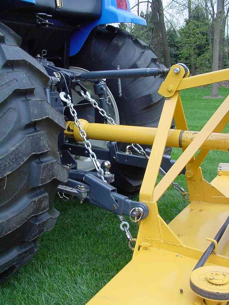

OK, I understand. For reference, the chains on my mower deck (and brush hog) are attached to the lower portion of the deck rather than the three point. See attachment.
I don't know who posted the picture your referring to, but I do seem to recall such.

</font><font color="blue" class="small">( OK, I understand. For reference, the chains on my mower deck (and brush hog) are attached to the lower portion of the deck rather than the three point. See attachment. )</font>
djradz,
Maybe I'm looking at it wrong, but in the picture, it looks like lifting the 3PH puts the top link in a severe bind.
/ Setting Rear Height on Brush Hog #47
Setup as it is.. the rear of the mower should be able to drop down and follow terain if he drives over a hill. if that pic is on flat land.. IMHO.. I would shortent he toplink so that the flaoting link was in the middle of it's travel.. etc.. that way it had play in either direction.
In any case.. the mower should still be able to be lifted with the floating link cammed over like it is in the pic, or extended(short)..
soundguy
/ Setting Rear Height on Brush Hog #48
Not sure why you would think there would be binding. As soundguy notes, I probably should have the top link a little shorter, so there's more play/travel when going in a valley, but the length it is give me a little more float when going over a hill. With it long like it is, in a valley it will bottom out and then the whole deck will ride on the rear deck wheels, causing both the front and back of the deck to come up. I really wish the mower had a bigger top connection or one with greater movement, but this has worked for me for about 20 years now, so I guess I'll keep it.
If I've missinterpreted you comment, please explain further. /forums/images/graemlins/wink.gif
