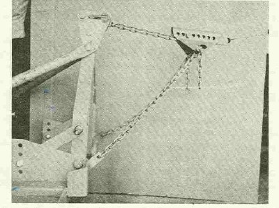

/ Setting Rear Height on Brush Hog #24
sidewinder, or whoever owns them now, sells an adapter to do the same thing, except the chain hooks on a place on the top link, so you can make changes quickly, i'll see if i can scan the pic and add it to this post..
heehaw

/ Setting Rear Height on Brush Hog #26
wow, i'm impressed..but then i'm pretty easy to impress..
the toll free number is 800-343-5825, they call this a chain bridle..
heehaw
/ Setting Rear Height on Brush Hog #27
Well,I'm one of those who say it is unnessacary,,,,,your lift arms hold the front up,,if using lift arms only,,lift arms don't lower,,they just go up when 3 point is set,they don't go down unless you make them or they leak down,,,,so you got them holding the front up and then you got those check chains holding front up,,both doing the exact same thing,,,,nither one will let front of mower lower,both will let mower front raise,,can not for the life of me figure out what good those check chains are doing,, I will tell you this,,,if you like it you ought to get rid of solid top link and go with a chain instead,,,you'll really like it than,,,,thingy

</font><font color="blue" class="small">( ......the rear of brushog comes off ground with rigid top link,,,,so maybe in the steepest part of climb,you went from carrying half of brush hog weight to all of it,,,,now that COULD make front end come up alright,, )</font>
IMHO, a tractor should be setup with sufficient front ballast to completely and safely lift their 3pt load.. especially if they need to run it in transport ( up ) mode... if lifting your bushhog of fthe ground makes your tractor front light.. you don't have sufficient ballast.

</font><font color="blue" class="small">( Well,I'm one of those who say it is unnessacary,,,,,your lift arms hold the front up,,if using lift arms only,,lift arms don't lower,,they just go up when 3 point is set,they don't go down unless you make them or they leak down,,,,so you got them holding the front up and then you got those check chains holding front up,,both doing the exact same thing,,,,nither one will let front of mower lower,both will let mower front raise,,can not for the life of me figure out what good those check chains are doing )</font>
Thingy.. you are only thinking baout tractors with good- non leaky lifts, and position control on their 3pt lift. You are not giving any thought to the hundreds of thousands of tractors made with draft hyds only.. no position control. Ford 9n, and 2N come to mind, as well as fergy TX-20, 30 .. etc..

Well, "the guy" wouldn't do without the chains. For those who choose not to believe, I have no answer, but for anyone else, here's the reasons.
- Yes, if you have old or leaking hydraulics, the setup would be nice to keep the position constant.
- However, it keeps the position, on a new tractor or one with good hydraulics, at the same point every time you lower the 3pt arms. No looking back, no wondering if you've set it exactly the same as the last time.
- Even if your tractor has a little set-screw stop or some other means to make a set 3 pt stop point, this is still easier and eliminates removing the stop point for the lever every time you switch implements.
- The chains allow for precise side to side level setting. This is very handy when you have a 6 foot or larger deck.
- The setup does provide superior "float" function than can be maintained with just the lower arms and a toggle or flexible top link or top link connection. (I recently created a small model of this and found that the connection of the lower chain to the deck front, at a point several inches lower than than the pins, is key to the scissors action.)
I'm not selling this setup. I don't get any benefit, whether you use it or not. When I bought my Woods mower, it was already there and briefly described in the manual. As I said, I wouldn't do without it, but no longer wish to debate it. I posted originally for the benefit of others only.

OK guys, lets get past the fact that the check chains only hold up the front of the mower. The chains that Woods sent with the mower and the bridle that Sidewinder has pictured (although I haven't figured this one out) are designed to hold the mower more level on uneven ground. The rear axle is the pivot point of the hitch as the tractor front wheels follow uneven ground. The lift end of the lift arms are about 2 feet beyond the rear axle. If the front end lowers a few inches, the arms raise the front of the mower, leaving longer grass in that area. If the front of the tractor raises, then the mower drops and either scalps or slides on the runners. If the front of the mower is supported on the check chains that are hooked much closer to the pivot point, the up-and-down pitching of the front of the mower is much less. Thingy touched on this briefly. I found a picture of a setup (Ford or Dearborn if I remember right) that uses a chain over a rigid top link to support the front of the mower. I'll try to find the picture and post the link, or maybe some will recognize and repost the picture. I think this would be better in that it would counteract the up and down pitching. I'd try to experiment with the triangular suspension, but would much prefer to buy one that is already thought out. Has anyone seen such an arrangement for sale?
/ Setting Rear Height on Brush Hog #38
I've never had a problem with a set of check chains from the toplink connection point to the lift pins, a rigid toplink and a couple from the toplink to the mower that allowed a few inches of play.. Most manufacturers either have a slotted attachement point for this.. or a "U" shaped couple piece that allows for a few inches ov movement.
I set my mower height this way. Decide on mowed height.. st the front at desired height using lift arms and no toplink. then adjust tail wheel to get the rear of the mower 1-2" higher than the front.. .. then install and adjust toplink to be in the middle of the 'play' at the desired cut height... adjust check chains if using them. Out of 5 different style/brand and configuration of mowers.. after a a bit of practice.. the all mow nicely... Only rare odd teraine features will cause deck to ground contact.. like wheels falling into large depressions.. or high areas like ant mounds.. etc.
