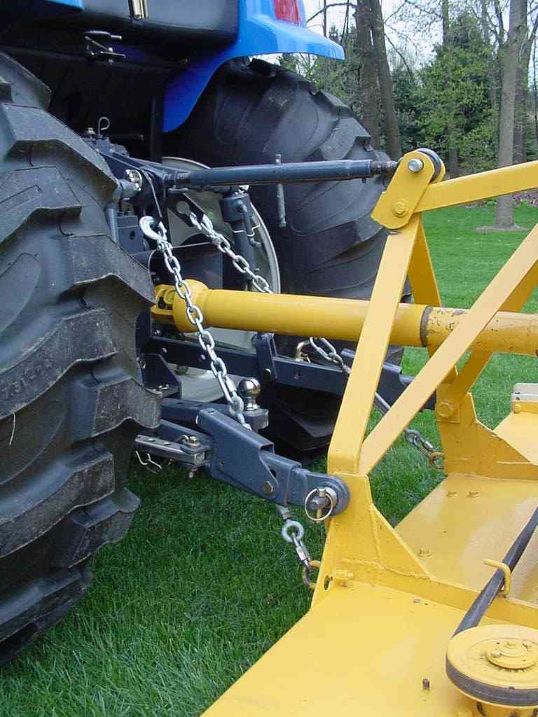

You can get a long pin for the bracket where the top link fastens to the tractor, and using clevises, hang a couple of chains from it. Fasten them to the arms of the three point and adjust them so the bush hog bottom floats over the ground. Constructing a simple A frame at the rear can give you a way to adjust the height of the rear wheel. /forums/images/graemlins/wink.gif
/ Setting Rear Height on Brush Hog #3
Like so?

/ Setting Rear Height on Brush Hog #5
</font><font color="blue" class="small">( Like so? )</font>
DJ,
That's the nicest setup I have seen so far. That's the way I will do mine, if I may steal the design from you.
Now for an igernant question: /forums/images/graemlins/smile.gif
The chain is on nearly a 45 Deg. angle, which puts a tremendous strain on the chain and top link bracket casting or weldment. Aren't you a little bit afraid of popping it with a large heavy cutter?
I know the check chains work, (because a lot smarter people than me say they do) but I'll be doggoned if I can visualize how. The 3 point arms limit how low the cutter can go, and allow floating upwards just like the chains. Please enlighten me!

They are used primarily on older tractors where the three point leaks down or on tractors that don't have position control.
/ Setting Rear Height on Brush Hog #7
If your 3ph doesn't droop over time, you don't need the check chains.
I guess you could use them to make sure you dropped the cutter to the same height every time if you don't have position control.

/ Setting Rear Height on Brush Hog #9
</font><font color="blue" class="small">( The chain is on nearly a 45 Deg. angle, which puts a tremendous strain on the chain and top link bracket casting or weldment. Aren't you a little bit afraid of popping it with a large heavy cutter )</font>
it's not as bad as you think. These check chains are common. TSC sells them.. as do the CNH dealers. i made a set for my fords. In fact, the 9n and 2n ford had draft hyds only.. no position control. A set of these chains were almost -mandatory- in order to run a mower.
Remember.. the rear wheel is still carrying some weight.. and those cast top link connection points are strong like bull.. after all.. they are a connecting point for lifting an implement.. possibly much heavier than a mower. My lift on my 8n is rated for about 800# before the front end gets light.. that 500# mower is no problem.

I use check chains (similar to djrazd's setup), but that seems to only affect the front height. Am I doing something wrong? Maybe I need to adjust the dogbone??

Thanks for the picture. Sure is worth a "thousand words". I have read numerous threads where people have referred to check chains and just could not picture it in my mind. /forums/images/graemlins/shocked.gif

</font><font color="blue" class="small">( use check chains (similar to djrazd's setup), but that seems to only affect the front height. Am I doing something wrong? Maybe I need to adjust the dogbone?? )</font>
The check chains are for the front height.. the top link won't effect front height much.. except that if you have it too long.. you won't be able to lower as far.. and the back of the implement will be pushed down.. too short and the rear is off the ground.
Youve already stated that your rear wheel is not adjustable the way it is currently setup. As it is you can now ONLY adjust front height.. I'm not sure what you are asking.. if you are asking how to adjust rear of the mower height.. then it should be obvious as another poster stated.. that you need to modify your tail wheel to be adjustable again.
