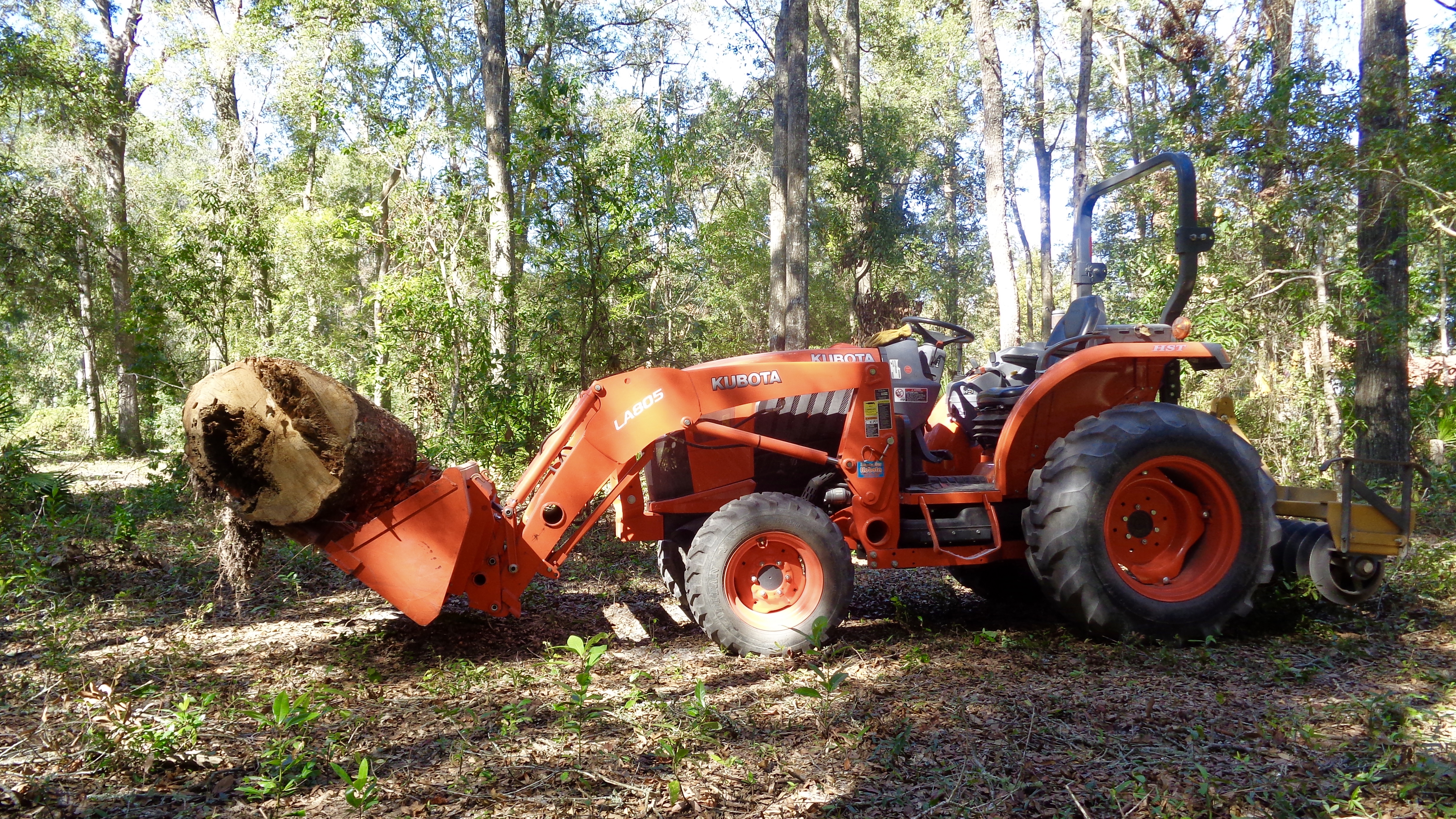

The optimal way to shop for tractors is to list your tasks first, then determine bare tractor weight you need to SAFELY accomplish your tasks. Bare tractor weight is a tractor specification easily found in sales brochures and web sites, readily comparable across tractor brands and tractor models.
For most tractor tasks greater chassis weight is more important than tractor horsepower. This tractor fundamental is difficult for people new to tractors to comprehend. In subcompact and compact tractor categories it requires a 50% increase in bare tractor weight before you notice a significant tractor capability increase. It takes a 100% increase in bare tractor weight to elicit MY-OH-MY!
Heavier tractors are built on larger frames with larger wheels/tires. Heavier tractors with large diameter tires have more tractive power pulling ground contact implements, pushing a loader bucket into dirt and pushing snow. Larger wheels and tires mean more ground clearance, enabling a heavier tractor to bridge holes, ruts and downed tree limbs with less bucking, yielding a less disturbing passage over rough pastures and woodlands.
Safe hillside operation demands more tractor weight than flat land operation and requires four wheel drive (4-WD). Greater mass of heavy-chassis tractors increases tractor stability when transporting loads in the FEL bucket, the most rollover prone of routine tractor tasks. Heavier tractors have adjustable rear wheel spreads; wide rear wheel spreads reduce tractor lateral instability.

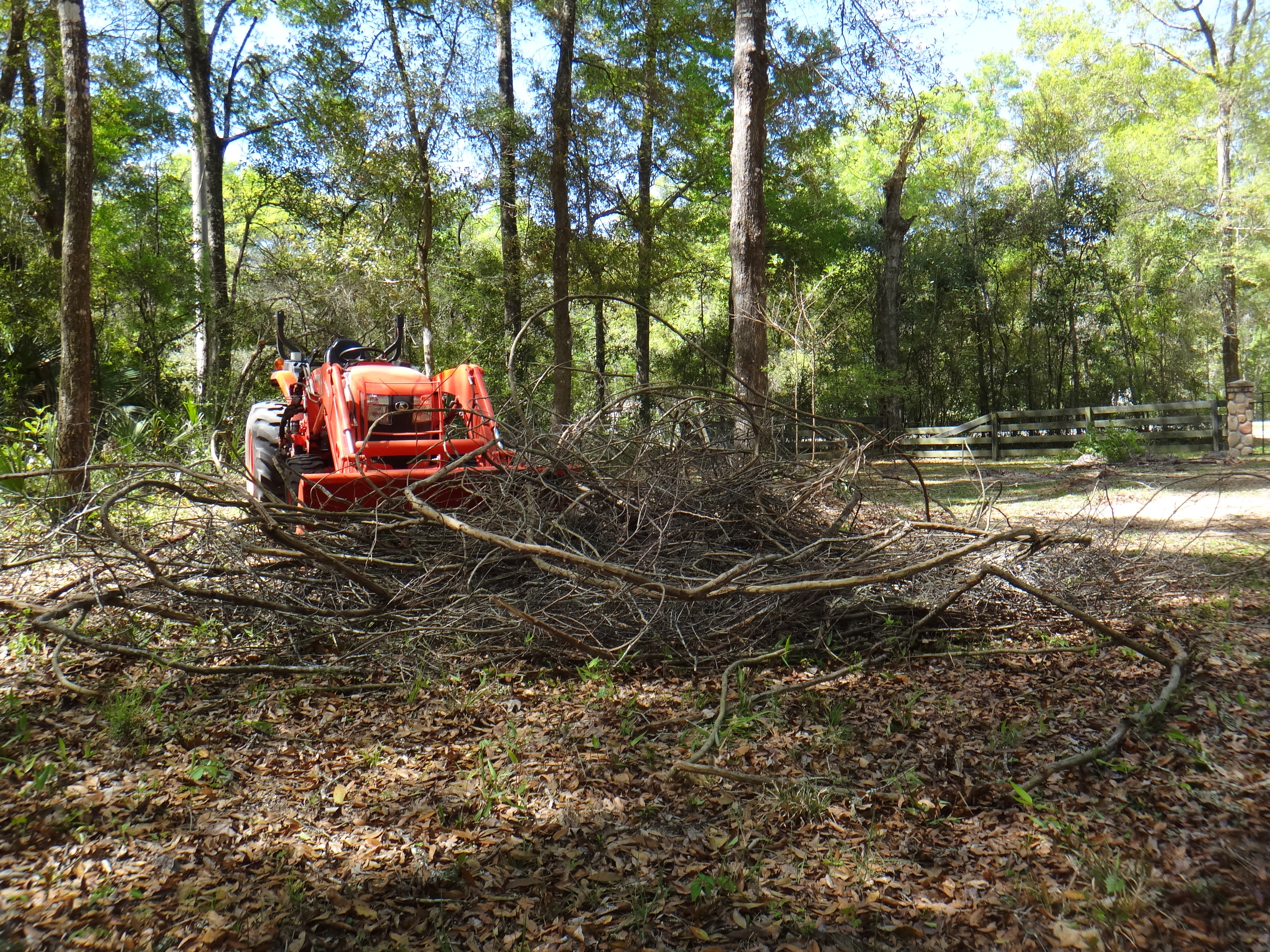

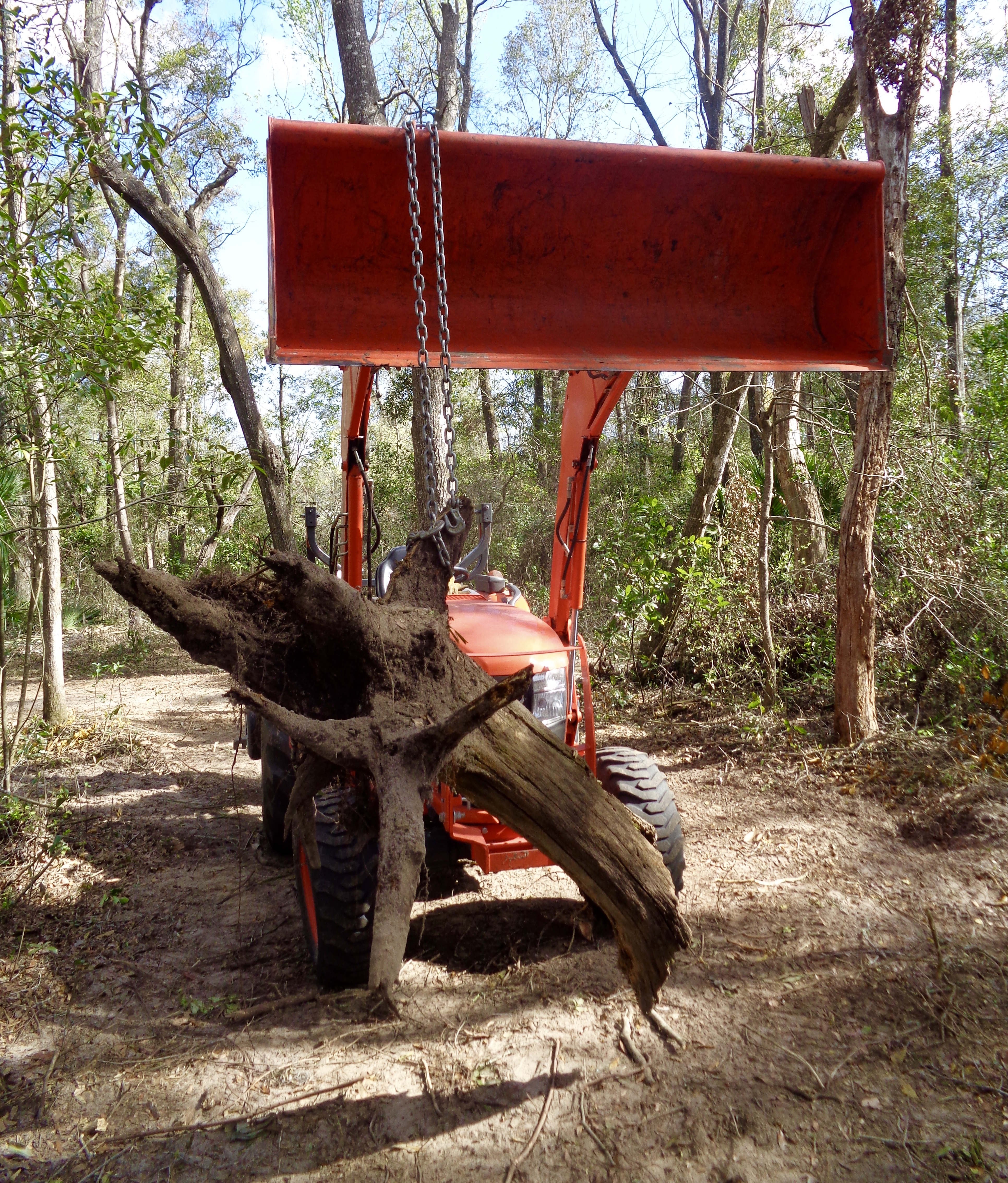

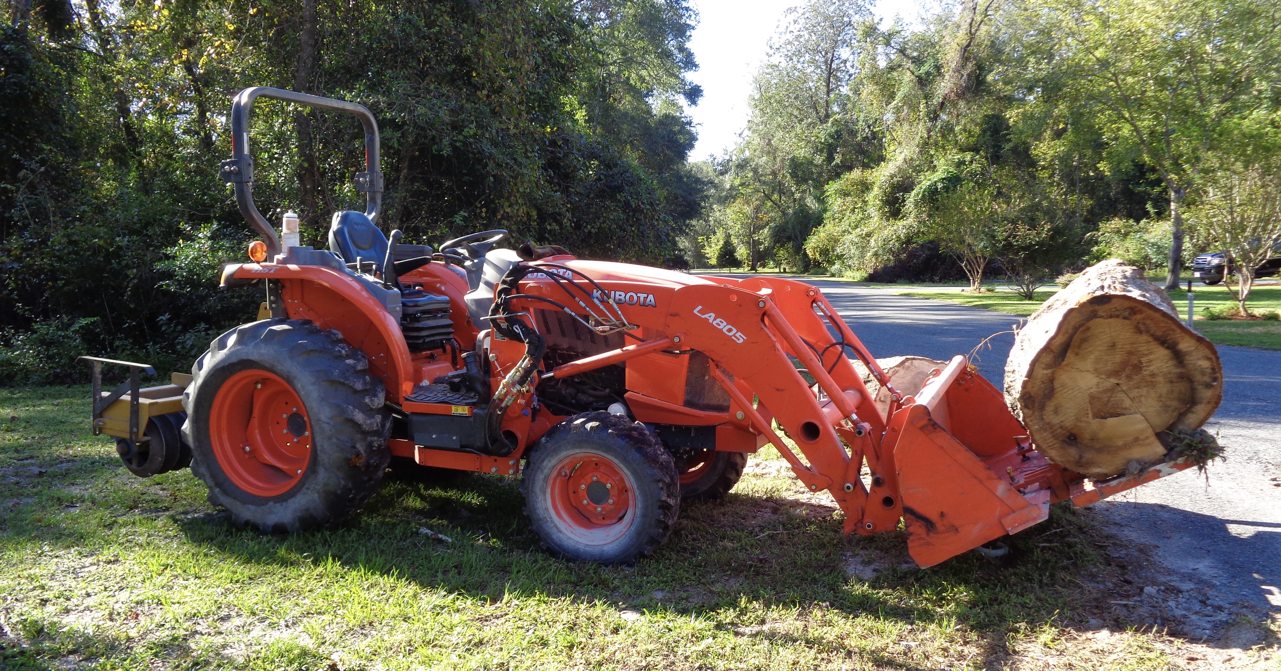

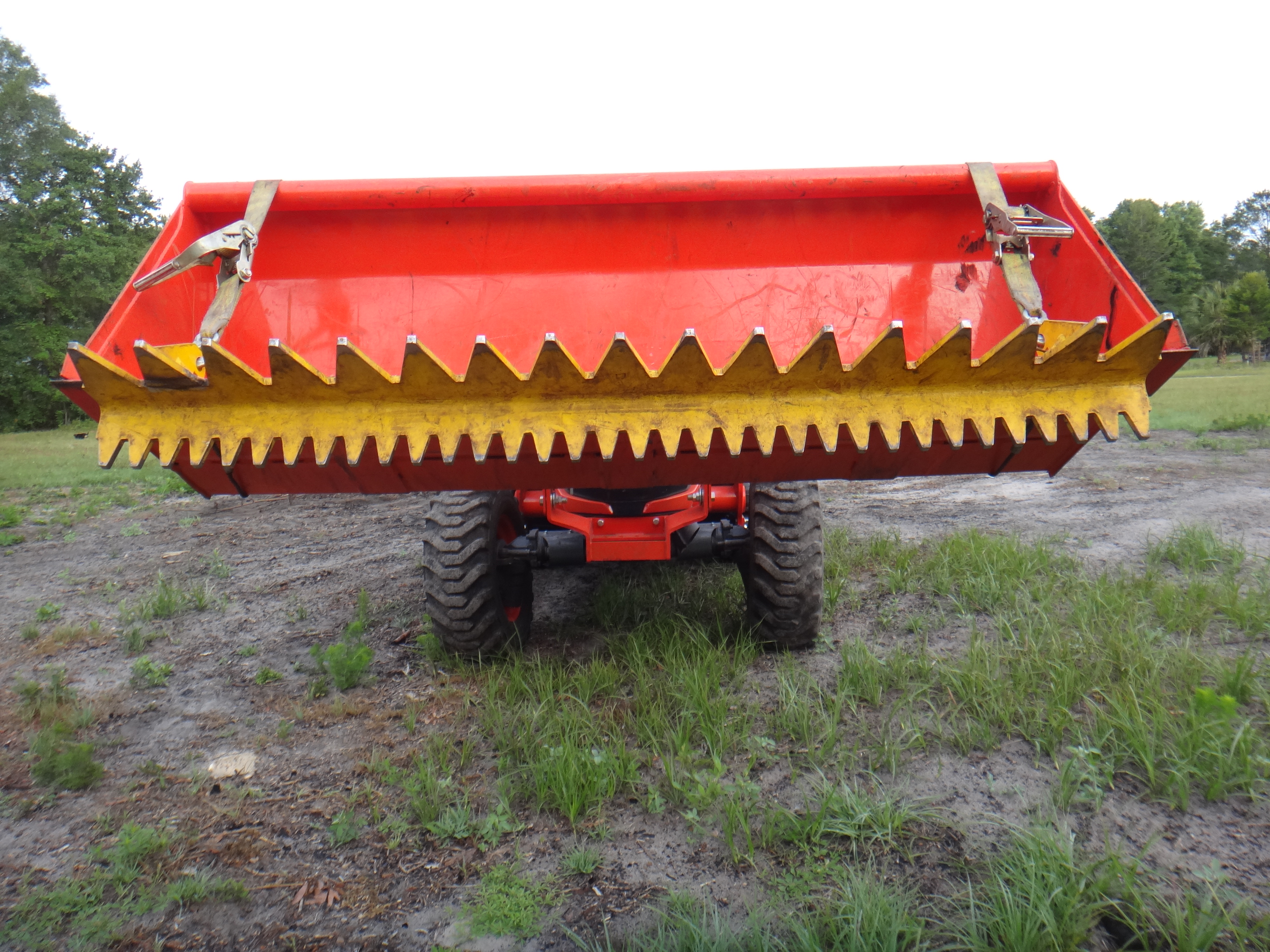

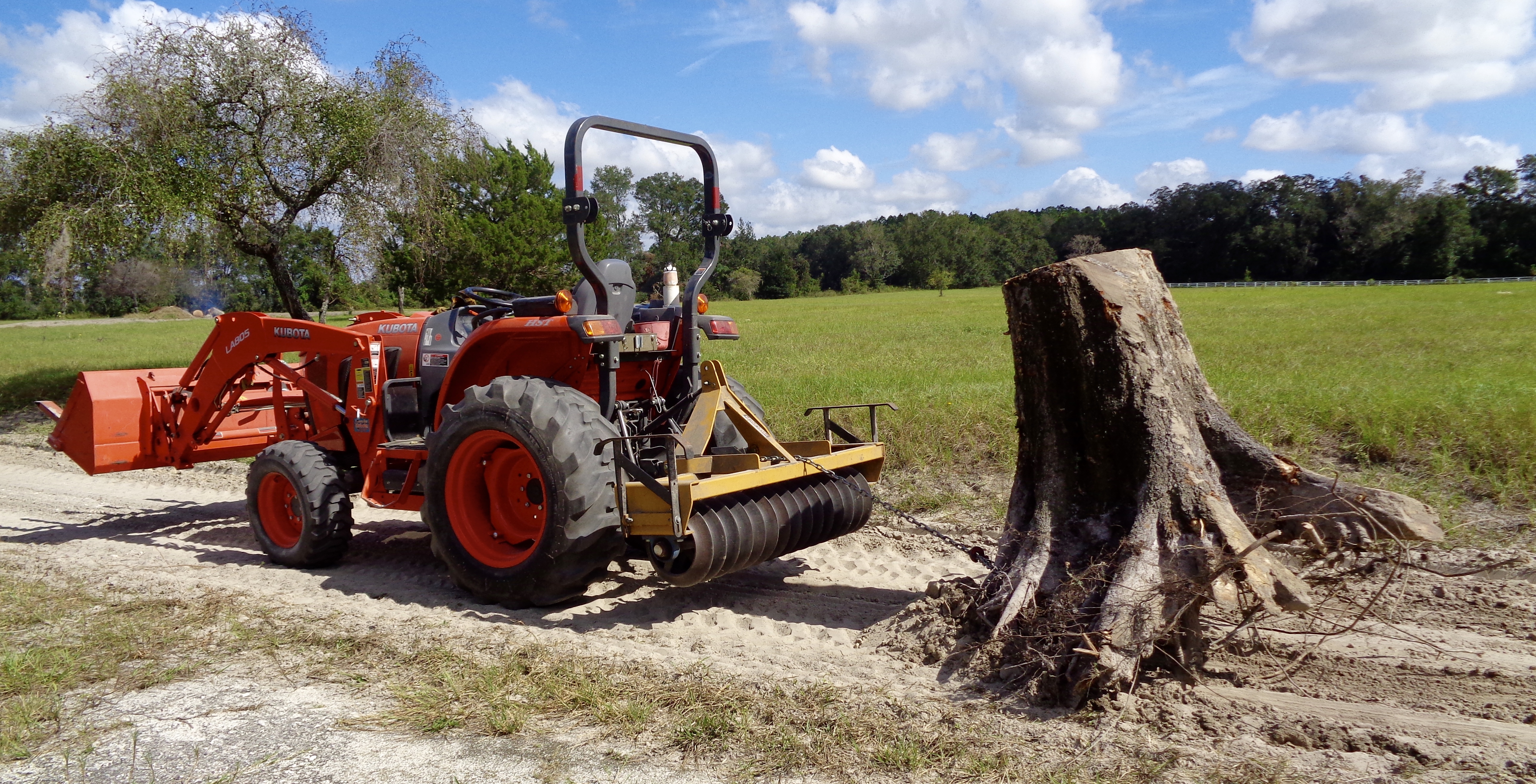

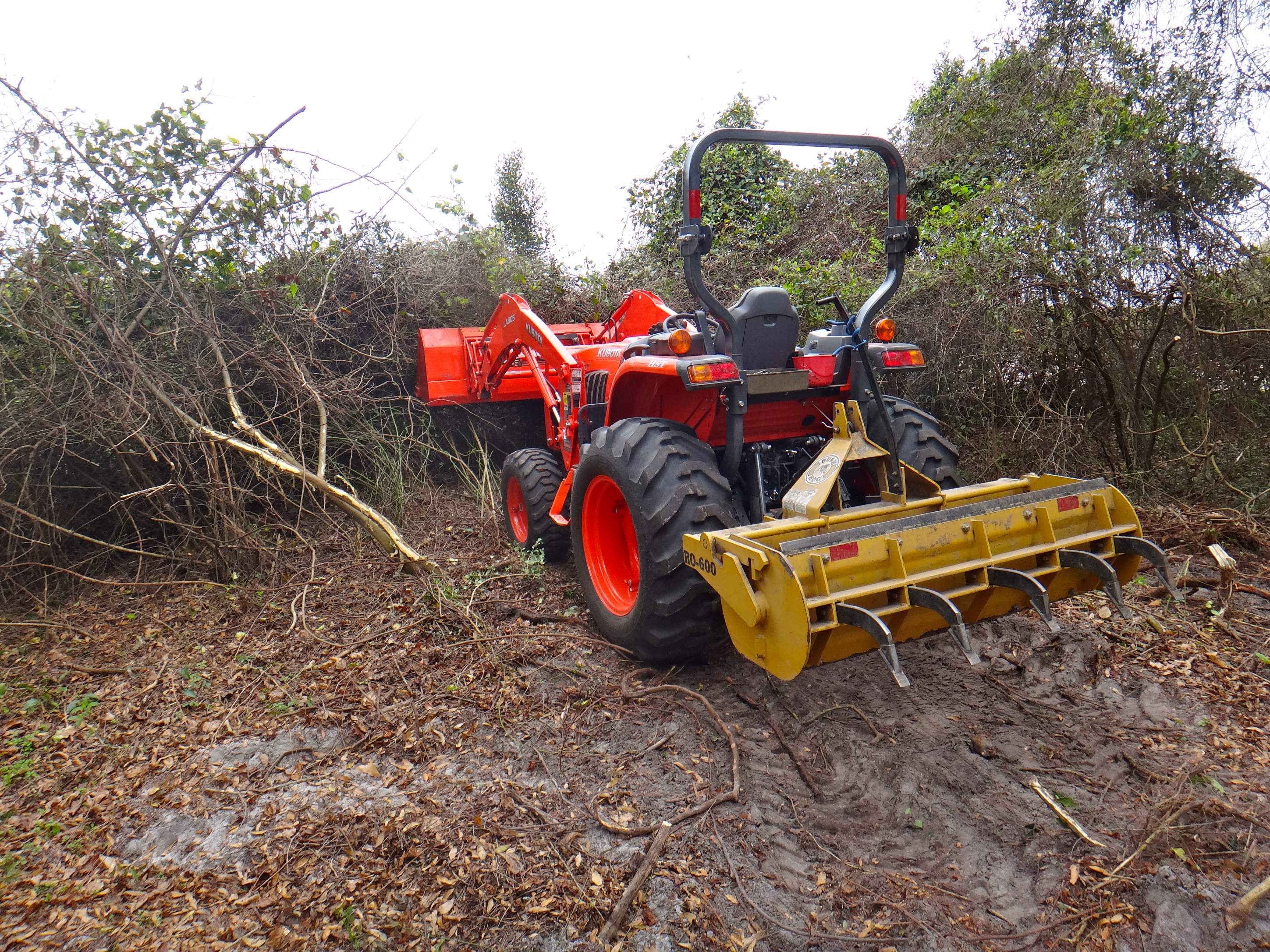

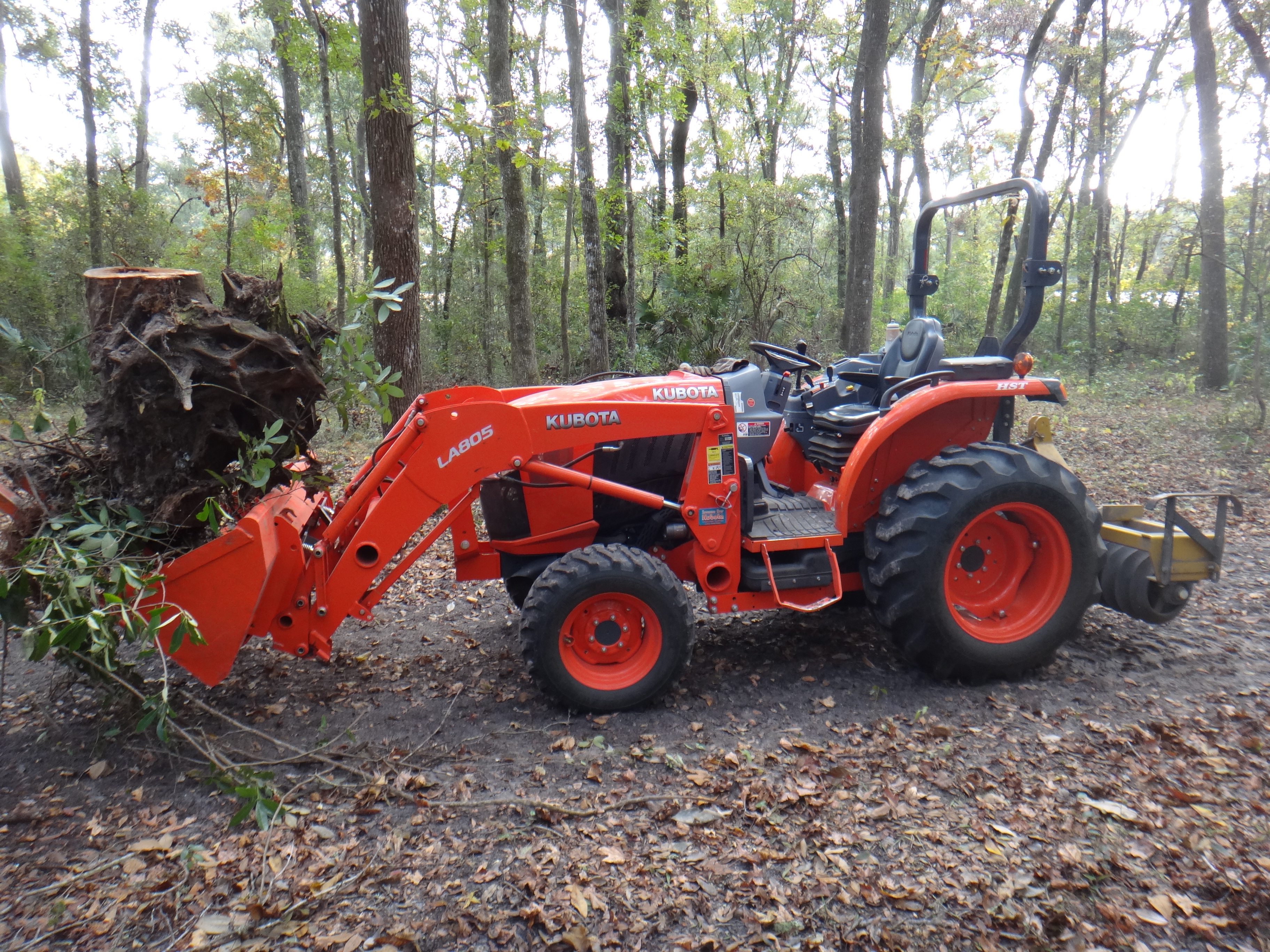

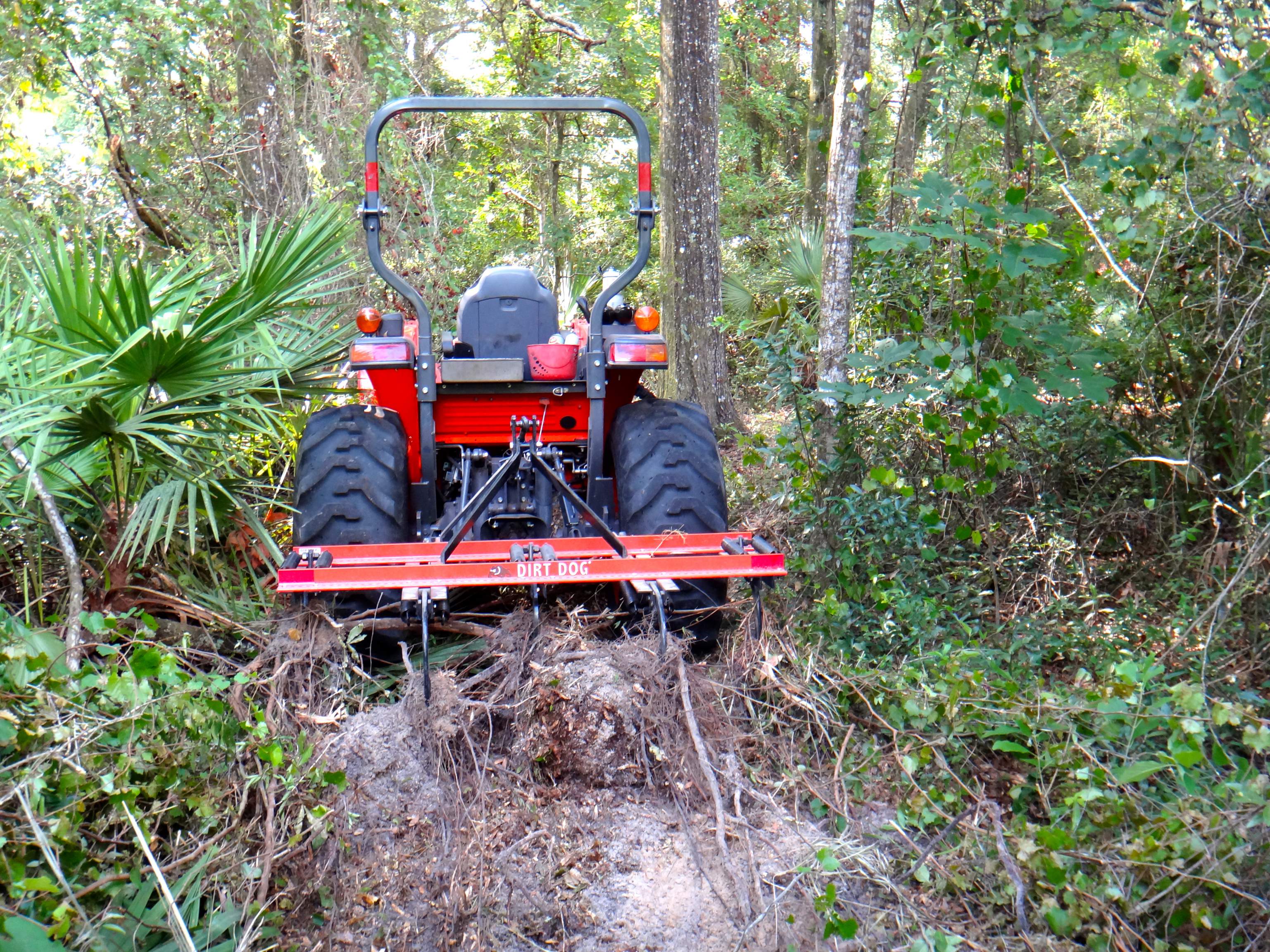

I'll start by laying out what I'm looking for: 25-35hp, 4x4, Hydro Trans, FEL, Backhoe, R4 tires, if used, below 500hrs and a front remote for a grapple. I plan on using it to clear some acreage, dig stumps and move logs around.
VIDEOS (2): Kubota Standard L-Series. L251 L331 L391 L471 features and operation. - YouTube
Kubota Grand L Series VS. Kubota MX Series - YouTube

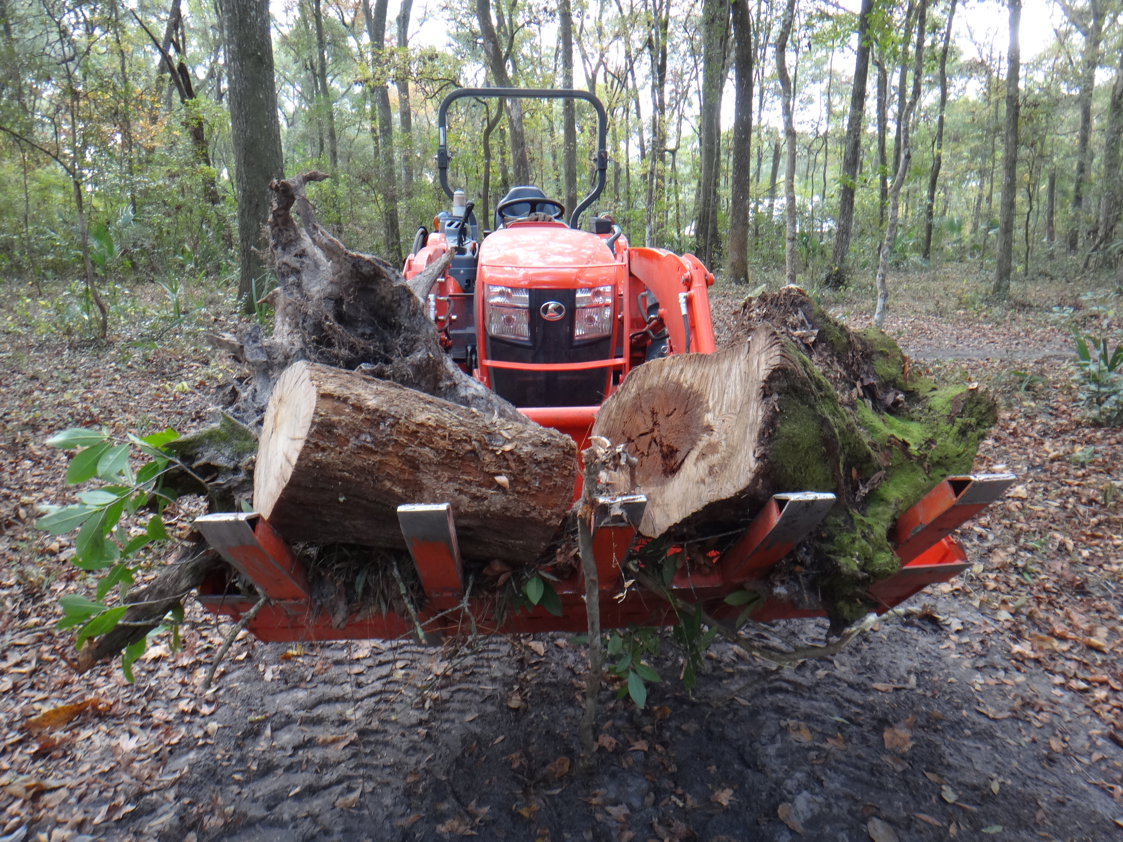

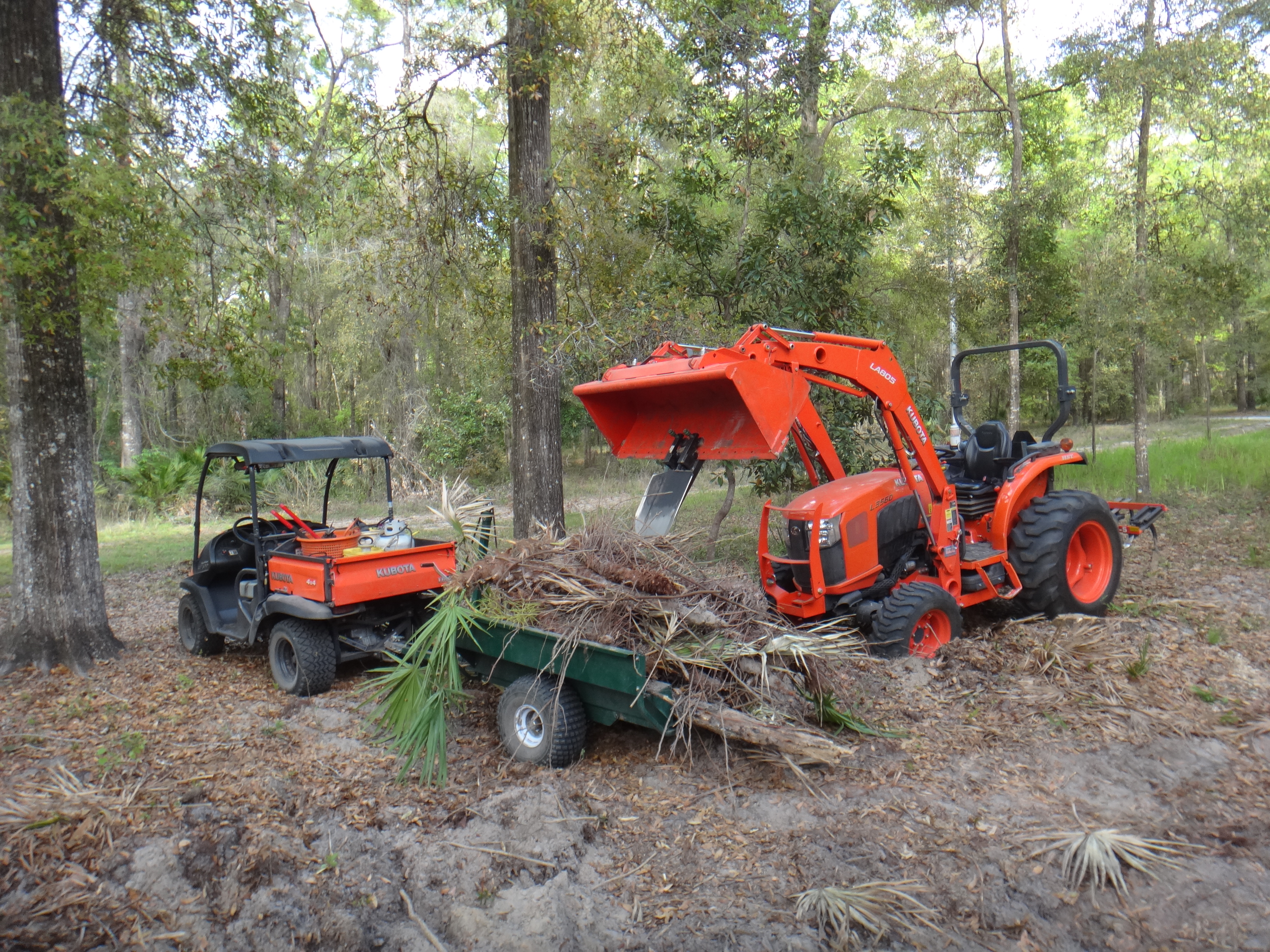

The universe of 25-horsepower tractors begins at 1,700 pounds, bare tractor.
Most 35-horsepower tractors will weight around 3,500 pounds, the heaviest, 5,000 pounds, bare tractor.
