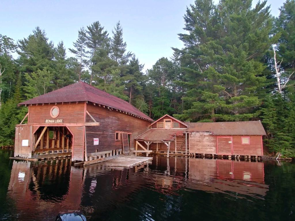

Now if only I could get rid of them pesky attack beavers that keep setting up shop under my big old boathouse...
