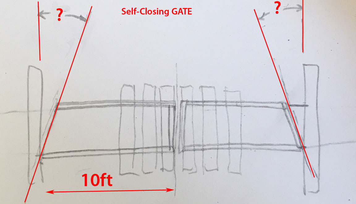

Does anyone have experience with self-closing gates? Want gravity to close it, overcome friction etc. I might have to let the wind blow thru it. If you know of one can you measure the angle for me?
Here's how I envision it, but there are probably several ways. I know you can do it with a guy-wire coming down at an angle (from a longer post).
THX!

I have a 12ft tubular gate set up to have gravity keep it open when unlatched. The hinges are about 30 inches apart and out of alignment only a small amount. Maybe less than 1/4 inch. It works very well.

I have done something similar by making hinges from a piece of steel tube cut at an angle with a pin through the center, but nothing that big. A steeper angle makes the hinge more likely to close (and stay closed) but also more difficult to open. A 45 degree cut is a good starting point to experiment and thicker wall tubing works better.

So just 1/4" on 30" works? OK I'll start small! Thanks.
I've seen the 45* cut method before but didn't think of it being able to close a 10 ft gate. Buy anyway the bigger hinge pin provides more closing power. I think I'll use that in addition to my hinge angle, like the final detent to hold the two gate halves aligned together. If theres a way to adjust it, would be a nice addition.

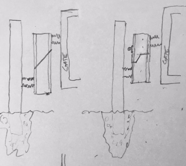

I'm making this gate to be lightweight as possible. It just signifies that it's a "private drive" not a security gate. It should just "appear" locked from afar.
I think the way to go might be..... The 45* angled pipes method used as a detent. Not using the entire 45* so the 45* only comes into play at "almost closed". Where the hinge line being adjustable for the "closing speed". Then I can simply adjust like Bruce's if I want it to hold open. Or move the the hinge line the other way if I want it to swing closed.
500376d1488383759-self-closing-gravity-gate-angled-gate45-jpg
Have to figure out ow to allow for all the "adjustments". There's hinge line angle and then the detent closed position where the two gates meet up.
