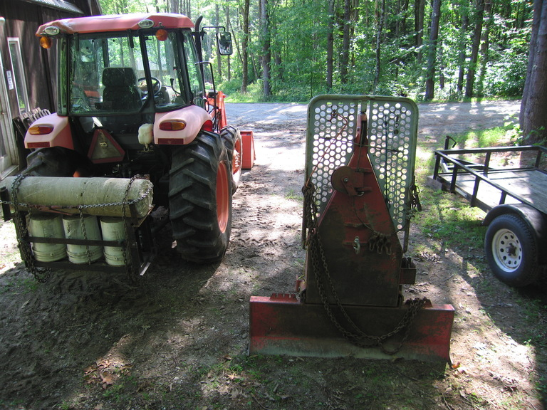

I just kept looking on CL and FB Mkt daily until a Norse 450 winch showed up in the next town.
It was a little beat up but still fully functional. Got it for $2250, had to replace the cable after I buggered it up but still a good deal and it has more than paid for itself as I am using it to harvest 8 acres of hemlock to sell.
