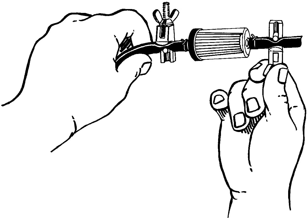

656020d1589770926-securing-mini-x-remote-location-lisle-hose-pincher-jpg
Get a hose pincher and put it on the fuel line.
They're small, maybe it can be hidden.
Might want to test it, verify you clamped the correct hose.
Don't clamp it so tight it ruins the hose.
It just has to run poorly (very poor).

I would recommend a in line tap, they cost around 20 dollars and can be spliced in anywhere in the fuel line, hidden discretely, the unit will start but only until the fuel in injector is used up a couple mins idle, did this on a 420 bobcat, on that machine it never was a issue having to bleed the lines once it stopped, same thing with taking voltage from the pump
