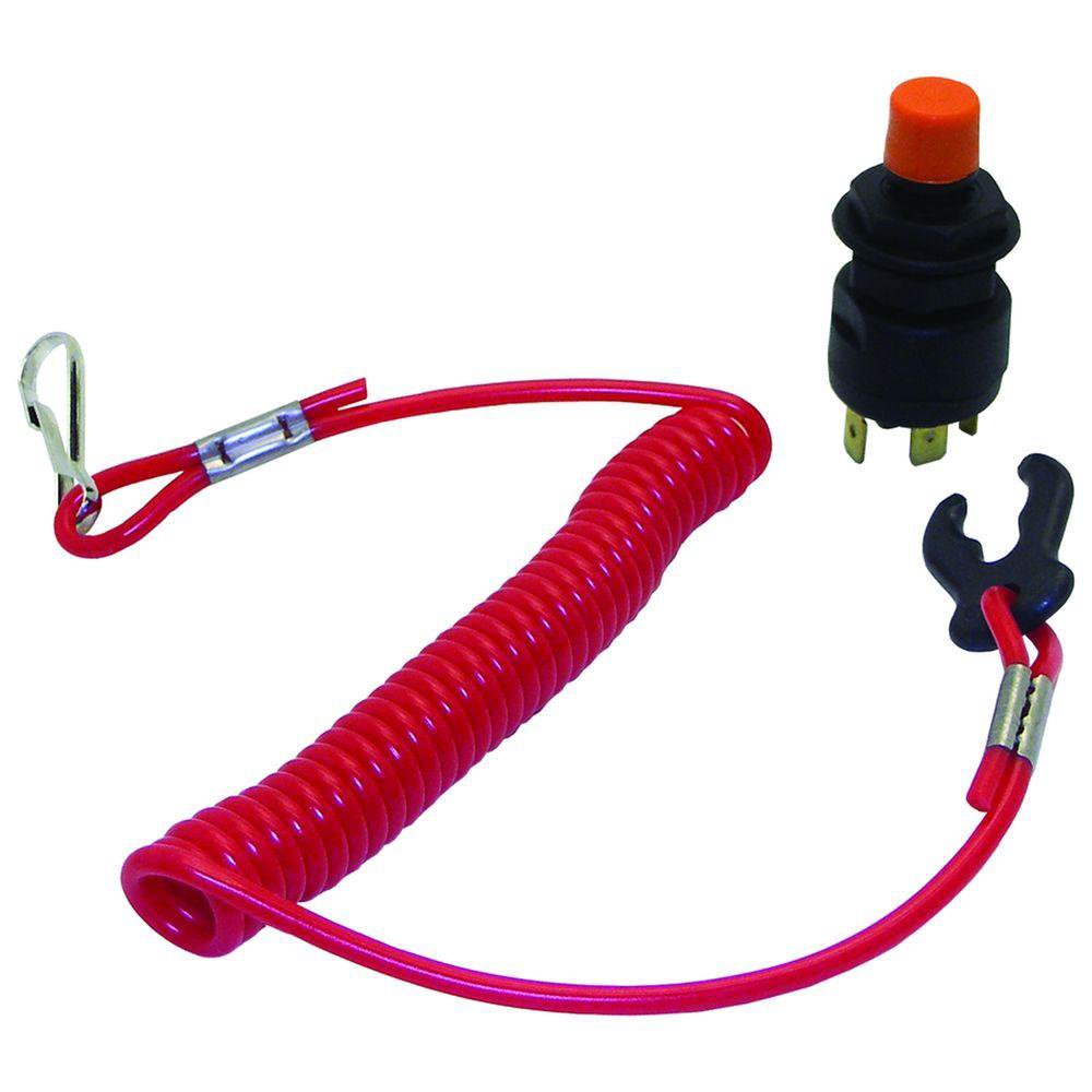

Get a coil cord and have a socket that completes the circuit like a boat kill switch lanyard (or like on a treadmill) . You can use a 1/4" jack with M/F to do this. You can buy one from home depot also.
The coil wraps around your wrist while doing tractor work and if you ever get thrown it will pull out and shut off the engine. When you need to leave the tractor with pto running you simply remove the coil loop from your wrist and leave it plugged in.
/ Seat switch #$#$$#$#% #29
This is a winner....
