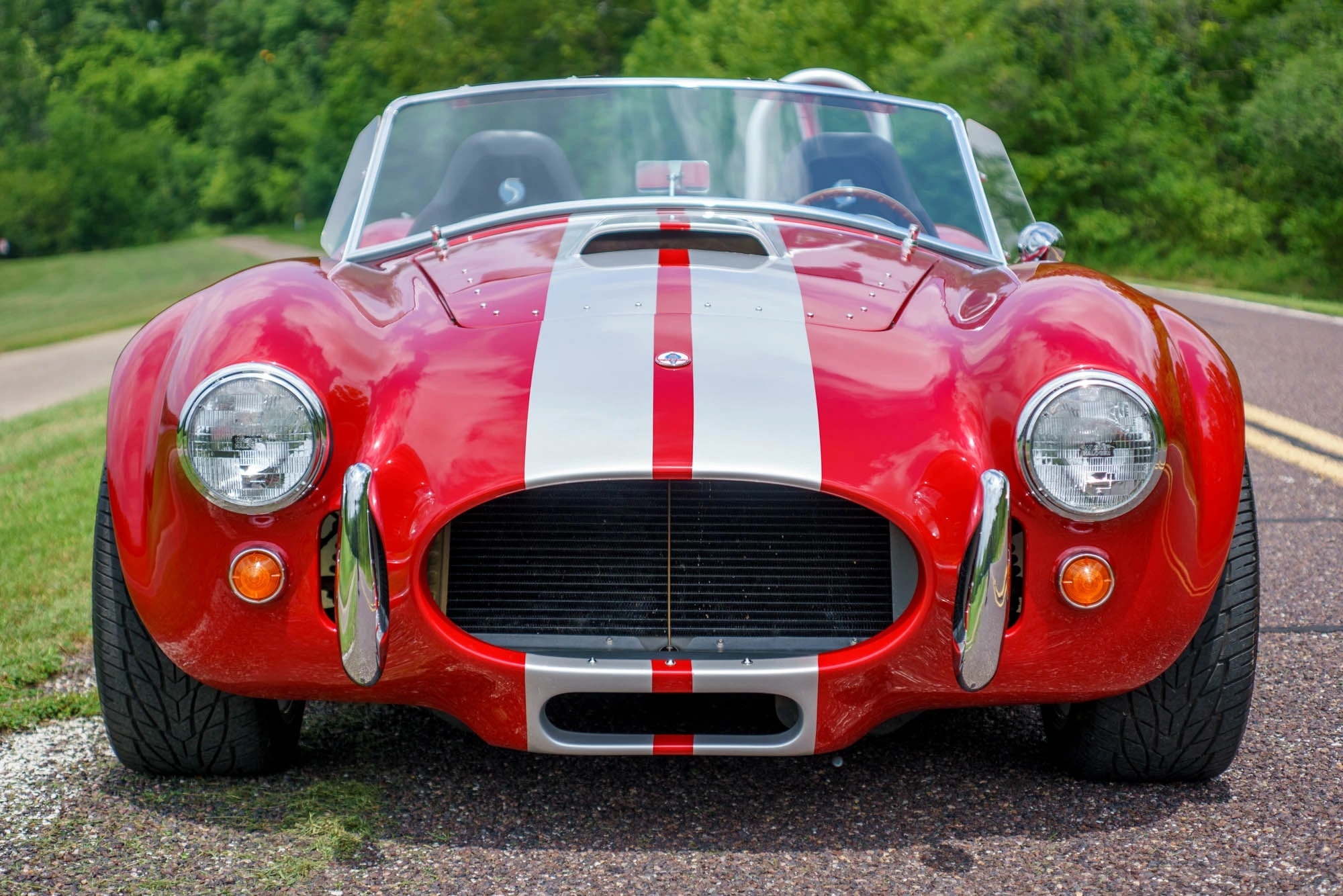

I hope your cousin gets well soon. I've never owned a stick shift tractor. I do have a dangerous piece of equipment with a stick. It's fuel injected and it has zero safety Nannys. You can bet your bottom dollar I check the shift lever before I reach in and turn the key
