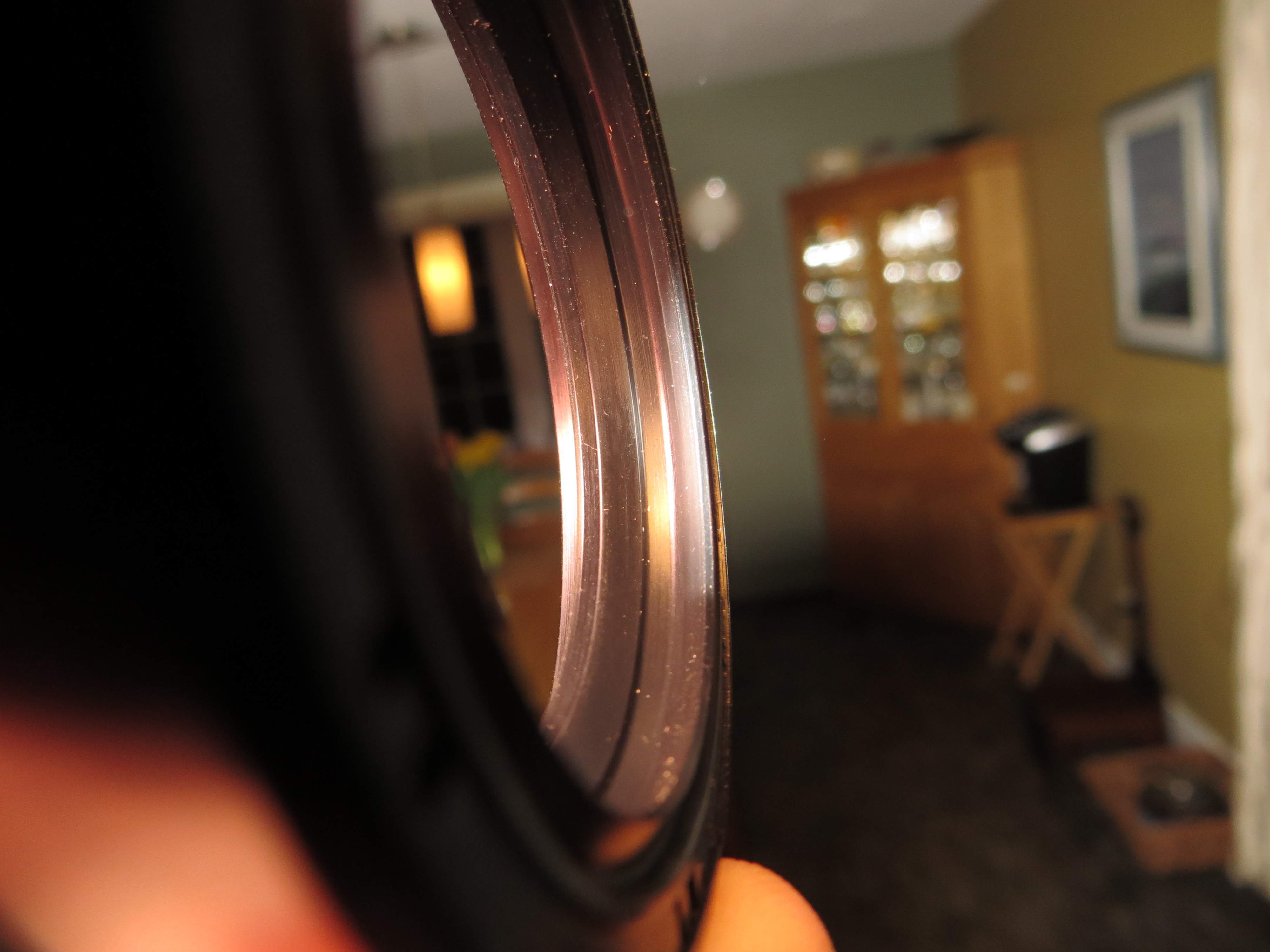

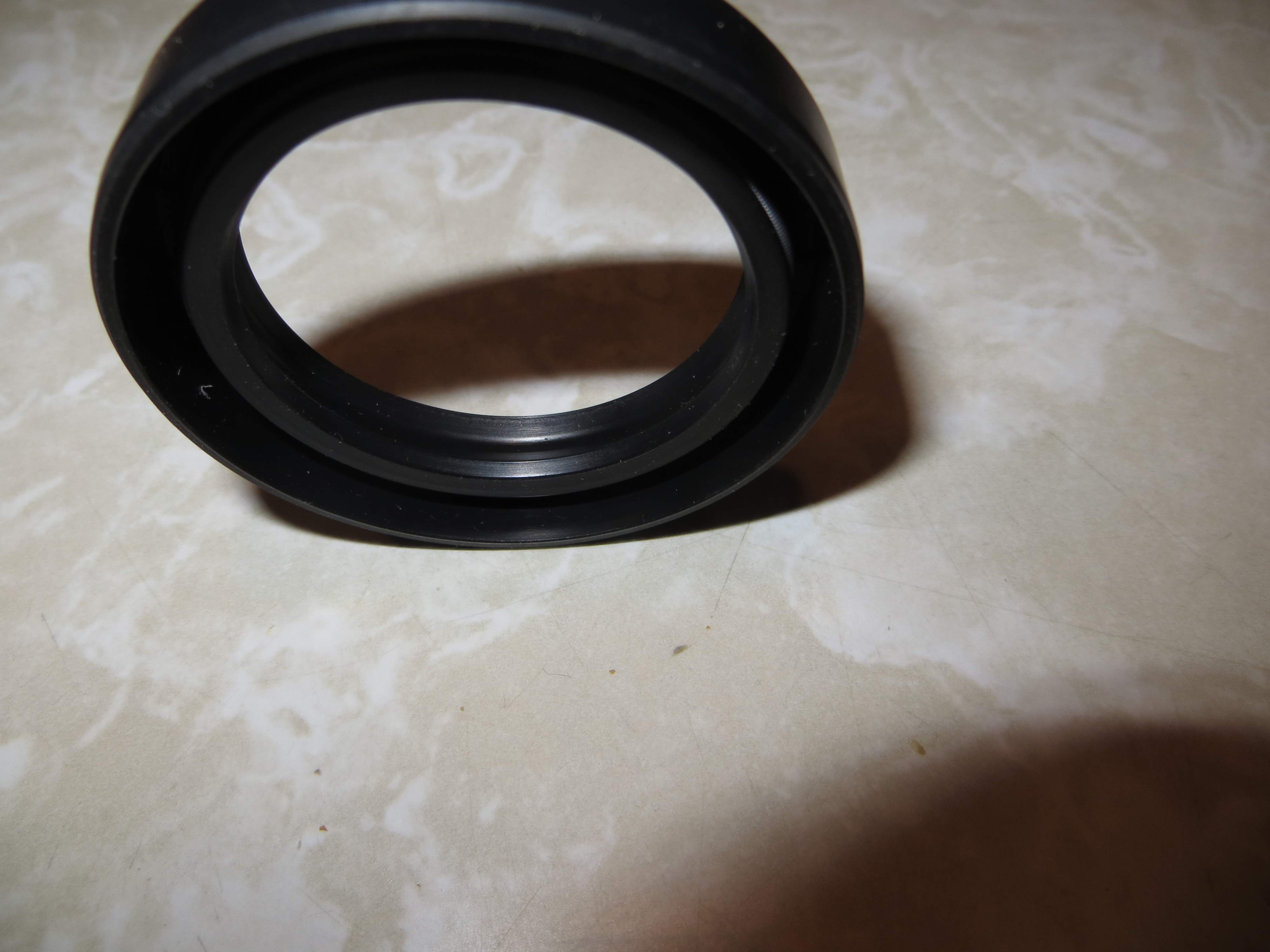

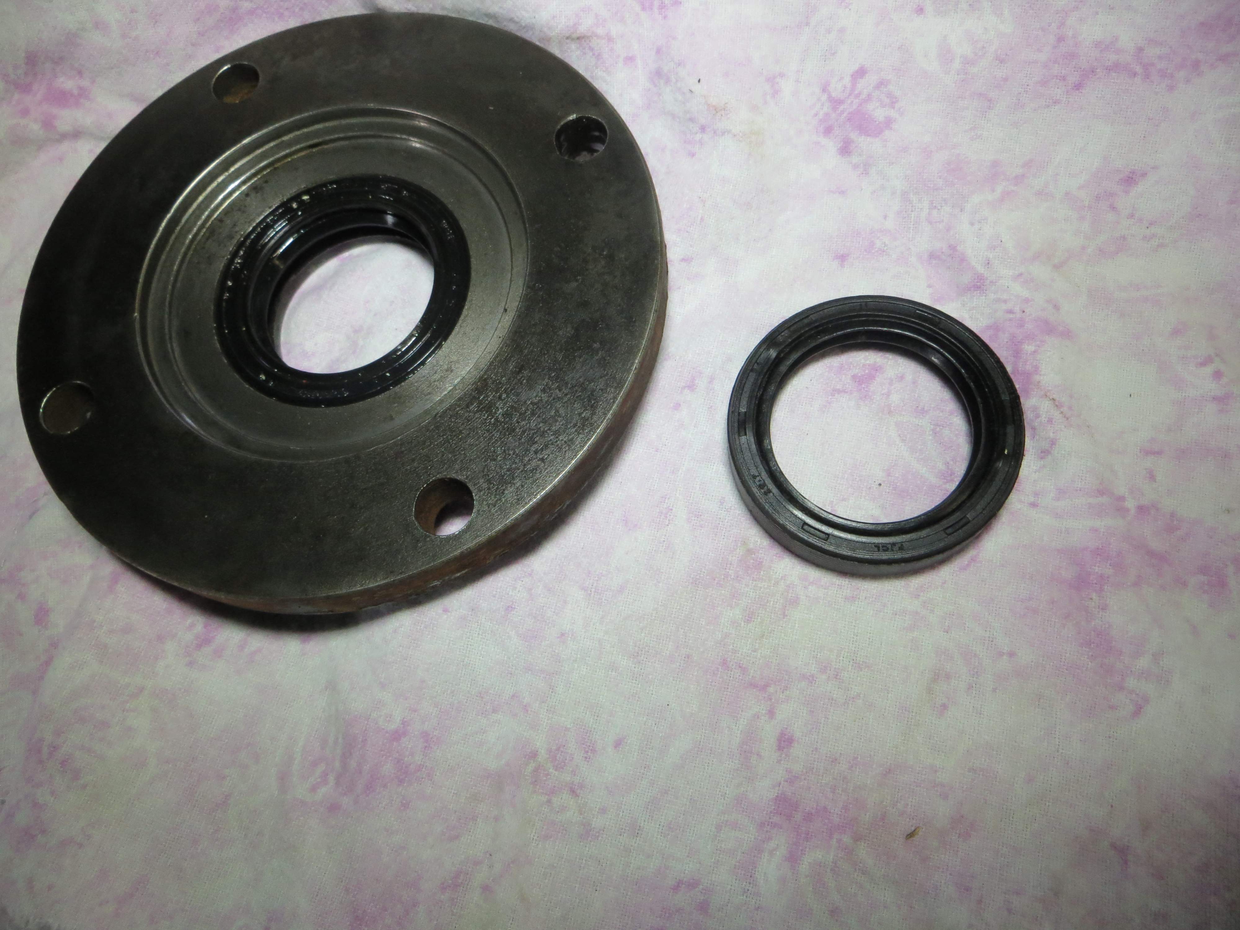

I'm replacing the output seal on the button of my Howse 4' bush cutter. It was leaking and since I just bought it use, I'm questioning if it was install correctly. I'm sure it was at the factory, but it could have been change afterward. Usually to my recollection, when you install a seal, the face of the seal is on the outside, but in this case it is facing inside the gearbox. Anyway, I took some pictures of the way it is set-up but I'm really not sure this is the right way. Please take a look and give me your feedback. The way it is set-up, their is a space between the endcap and the seal. This space was fill with grass and whatever manage to get in there. Suspect that this could have been the reason for the leak. Edit: Forgot to mention, this is a double lip seal.

In that case, it would be install correctly. Also I forgot to mention but this is a double lip seal. On this pic you can see the small lip turn outside so with any kind of pressure the lip would push again the shaft.

Ok, so I took a run to my garage and had a better look at the seal. First, yes there is a spring inside and it is on the inside lip in other word if you are looking at the seal with the # facing you, it would be the second lip inside. That lip is also different than the other one. It is made more like a V shape. The other lip closest to you or I should say closest to the face of the seal with the # is more like a wiper lip and is shape going outside. I took some more pics. So if logic stands, the lip with the spring, shape like a V should be the oil seal and the other lip should be the one stopping the contaminant from going in which mean the seal is wrongly install. Your thoughts please.

The side where you can see the spring defiantly goes towards the oil.
/ Seal, which way should it go #19
You are correct in what you are saying, this is indeed a double lip type seal, the open side of the seal should face the oil or grease. the other outer lip is to prevent contamination from entering the seal and bearing area.
Before installing the seal I would check the bearing and shaft for any excessive wear that would make the new seal weep oil. Another thing to check here is that the vent/ breather on the housing is clear and that there is no chance that pressure could build up within the housing.
