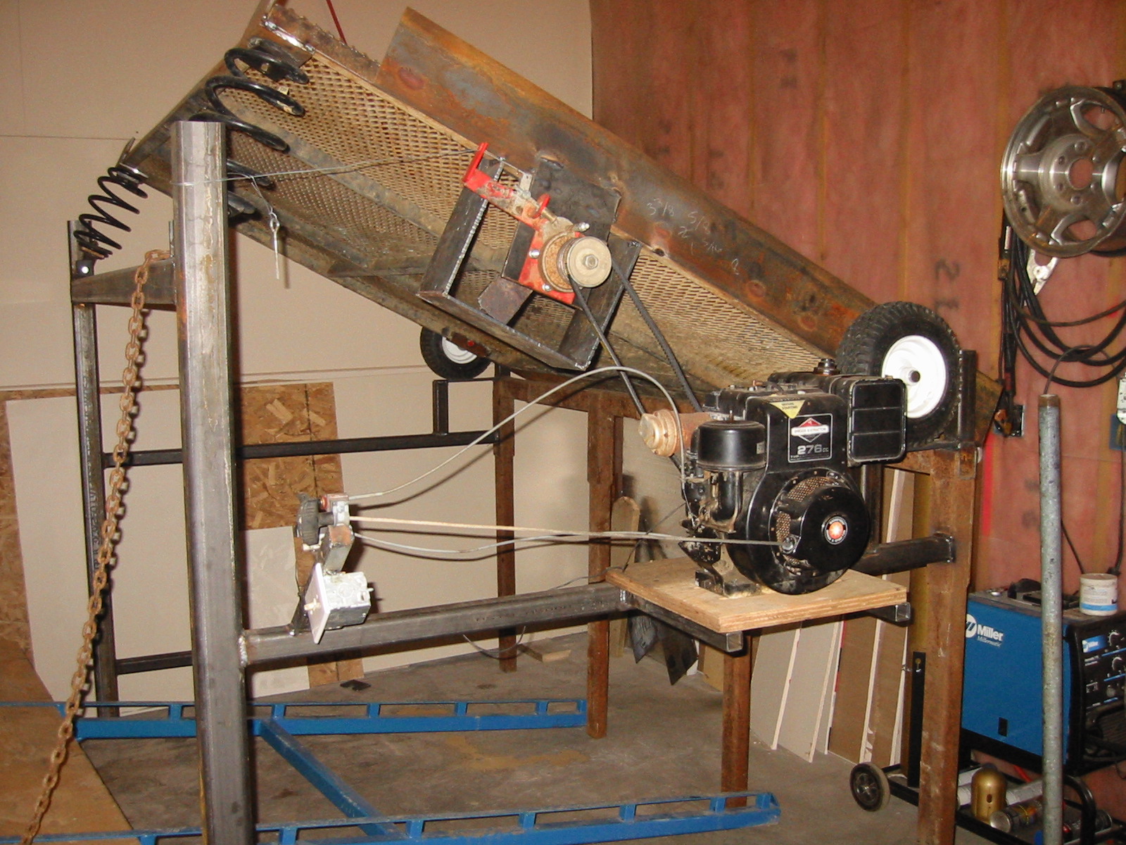

I have the need (want) for a screening plant to screen topsoil, when they first built the road in front of the property that I own they piled 3-4 hundred yards of rocky topsoil on one corner. The last couple years I have built a new house and shop, now it's time to landscape (actually going to use my tractor for it's intended purpose):) . I have done some searches on TBN and have got some good ideas. Anyway this is what I come up with, a combination of stuff I had on hand, and a little new steel (so the local supplier could feed his kids):) Wow is steel expensive:eek: Before i clean it up finish and paint, I wanted to test it, but the weather went back to winter like:mad: so I will have wait a few weeks. Let me know what you guys think.

Wow! Looks great! Wish I was that far along.
Is the angle adjustable on the table? Too me, it looks very steep, I would think I would want mine flatter, but will be watching the project with interest.

No, but I have a plan if need be.... for now the cross bar holding the springs is welded in place but if need be I can move it if I need to go down (flatter) or change the spring bases if I need to go up. Years ago my dad owned a pit and a screening plant that had a hyd. adjustment on the angle. These days my "forgeter" works better than my "rememberer":( . If I remember correctly we adjusted the angle depending on the product, very flat when making mason sand and fairly steep for maiking septic rock. So right now it's a big science project, that I can't wait to try! I added a pic of the cross bar and spring bases so you can see what i'm talking about.

I will be watching with interest because I could use one of those for the projects I'm woking on. How big is it (dimensions)? Bill
/ Screening Plant Project
The Screen is 96" by 64" No particular reason for that size, it use to be a roof rack off a van that I bought at a auction. The bucket on my tracror is 72" so I think it is about the right size. the front of the screen is about 90" off the ground, which will just be high enough for the FEL full up in the dump position. The old Briggs and and other pieces are off an old "ruff cut" mower that was given to me. The motor hadn't been started in 15+ years, I checked for a spark put some gas in it drained a little through the carb, 3 pulls it started :eek: a little fine tuning and it runs like a top! I'm not much of a small engine mech so I was happy I didn't have mess with it much.

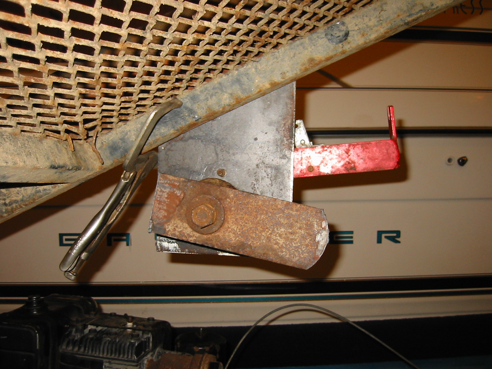

Hey Mike
Here is a couple pics, the vibration unit is part of the old mower, I simple cut off the blade and added a counter weight (3/8"x2"x3") to one side. I'm sure I will have to experiment with amount of weight, however it shakes pretty well as is, I even stood on the screen to see if that changed the amount of vibration and it didn't seem to. So it should be good for testing. As soon as it thaws out:mad:

Looks good for a try. thanks for the pic. I saw on the weather that it had truly turned winter again there. We have daffodils blooming and the fruit trees are starting to pop. But we had a VERY mild winter.
It will be interesting to see how long that spindle can take an out of balance situation.
Mike
PS. You will of course put an OSHA approved cover over everything moving or rotating, right? ;)
