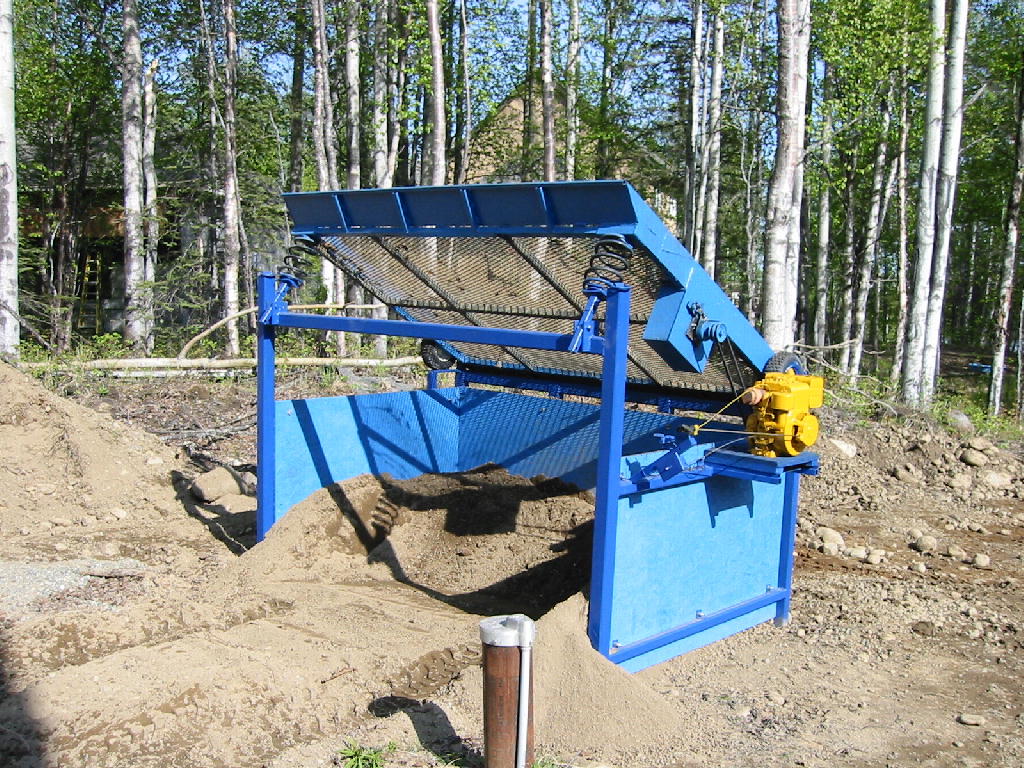

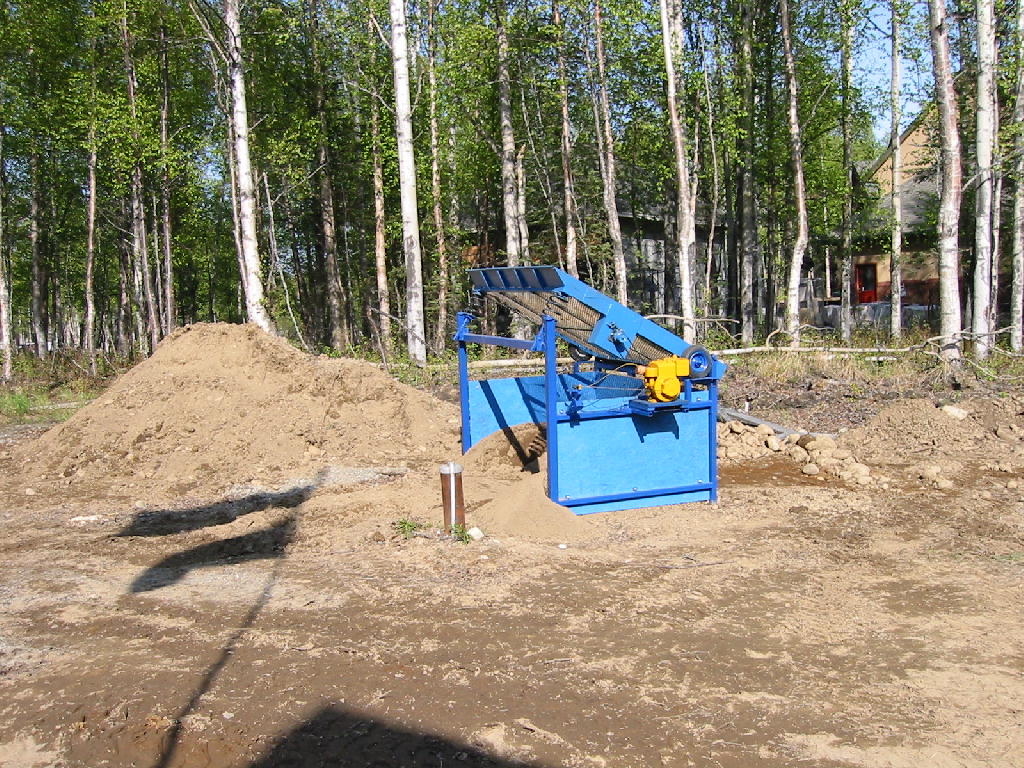

Well, I'm finally done and it works great!! I've screened 30-40 yards with no hiccups. I think I will build a engine guard, to keep an errant rock from hitting the engine.

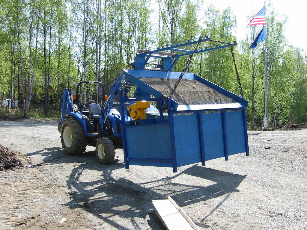

I had several hundred of topsoil that was grubbed off the land at my girlfriends cabin that was mixed with tree stumps, roots and rocks. All this wonderful topsoil was trucked away and dumped in a pitt. I saw AK's screener and thought it was a wonderful idea to recover this soil rather than pay $300 a tandem for topsoil.
I added a few touches to the screener in order to pick up and move the screen with my JD 2210. Still a few bugs to work out and have to add wings to get rock, sticks, etc from hitting the motor,
Overall I am pretty pleased up to this point

Very nice job. I saw a manufactured one that sits higher but has a sled under the screen for the good loam to slide off into a pile and the same for the rocks/debries farther away.

Caper90,
What sizes of steel did you use, and for what parts? It looks mostly like 2x2 HSS, but segments look a bit bigger (maybe 2x3 or 2x4).
What about on the screen, did you use HSS or Angle Iron?

My entire screener is built from salvaged scrap metal. I went to the local tractor dealer and they were going to throw out all the metal frames that the tractors are shipped on prior to being assembled. It is mostly 2x2 tubing with some 1x2 tubing for bracing.
The screen itself was saved from the scrap yard, it was off an industrial screener and was cut up in sections. I build the frame for the screener out of the 1x2 tubing and welded the pieces of screen to it, then I put angle iron around the edges to lock it down so it would not vibrate free. The segments look bigger just from the angle the photo was taken.
I have screened a lot of dirt with this and have not had an issue with structure or welds. (blew the motor - my own fault for not checking the oil level).
I plan on making a slight change in the design some day. I would get a off balance weight on each side of the screen to maximize the vibration, I found that with the weight on one side it was not vibrating as much as i would like, I messed around with different amounts of weight but still need that extra bit of vibration.
If you have any other questions, fire away. Hope this helps

how about using an axle all the way though from one tire to the other and fixing your pulley to it. then add a shaker weight to the center. you could raise and lower the angle without having to adjust the belts and both sides would be shaken through the axle. just a thought.

Your design appears to work well. What are you supporting the rear of the screen table with...springs, rubber mounts? What is the mechanism of your off centered weight to create the vibration. What size of motor are you using.

The back of screen table is supported with 2 coil springs off of a small car, they were cut down so they were not so high. They are just sitting in a piece of pipe on the bottom and I used the rubber bushings off the car for the top part as they sat in perfect. The mechanism I currently have for vibration is an old impeller off a snowblower with weights on one side to make it off balance, I made sure to put a housing around it so I did not have to dodge flying rocks if they landed on the impeller. As mentioned in an earlier post, I would go with a counter weight on each side to add more vibration. The motor is just a 8hp snowblower motor.
Modifications will be made this summer. I'll post new pics when I finish them.

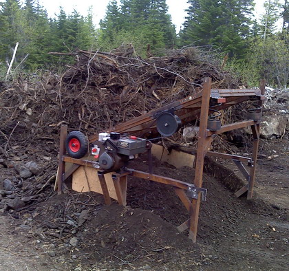

I'm late in reading this screener build and thread. Saw a couple of comments and questions relating to springs for the screener so I thought I would re-post my video on my homemade screener where I used sections of car tire for both springs and hinges. The ideas has been working great without any problems related to the use of tires.
