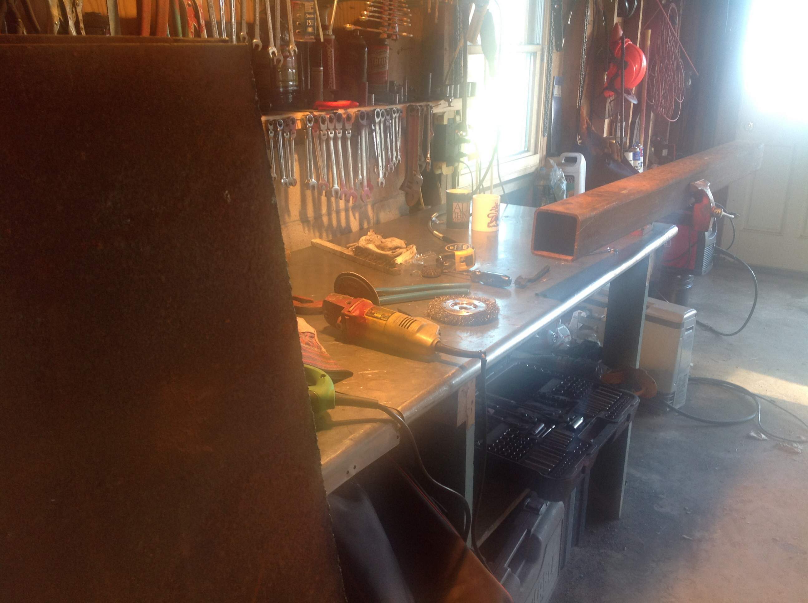

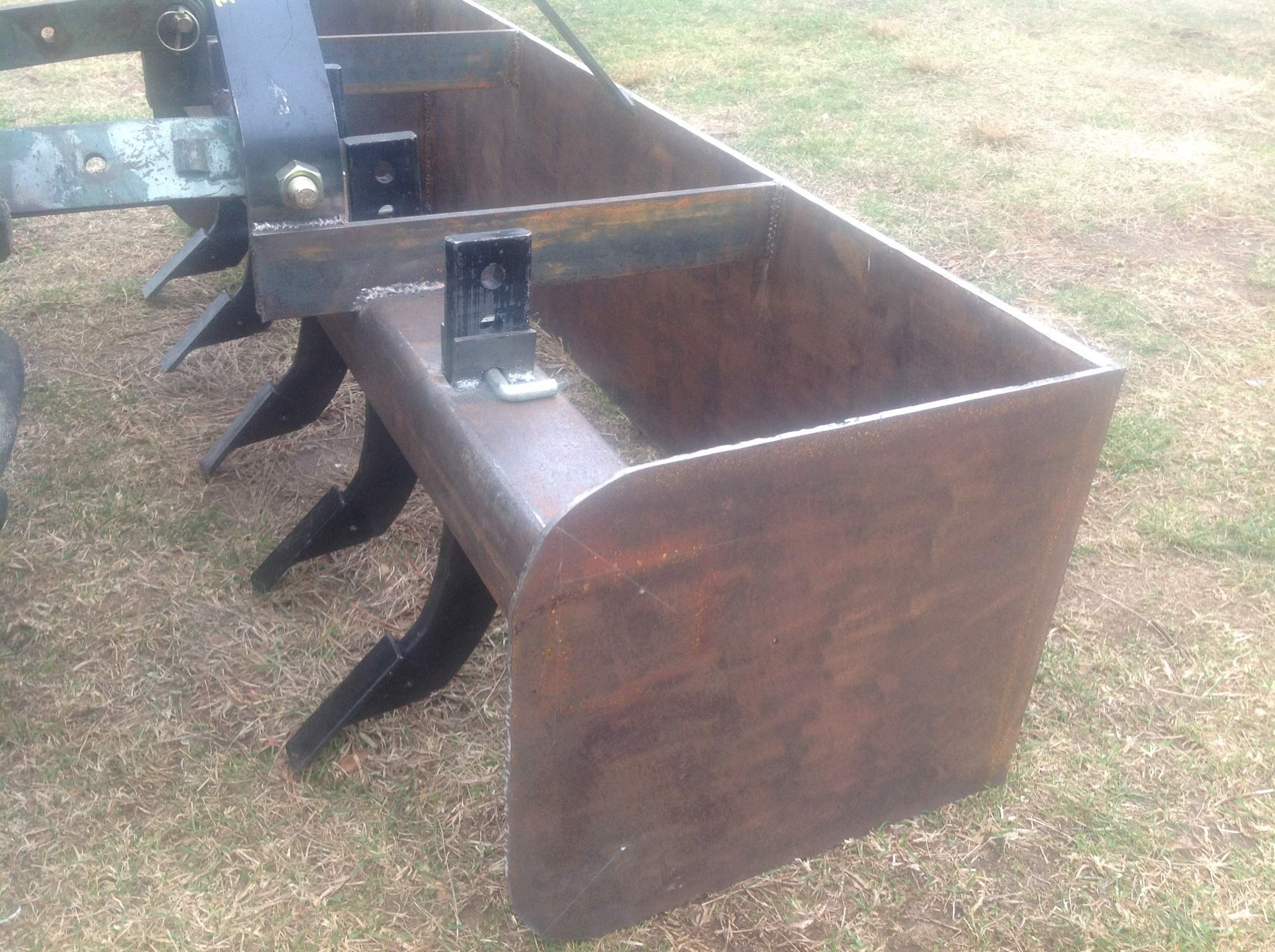

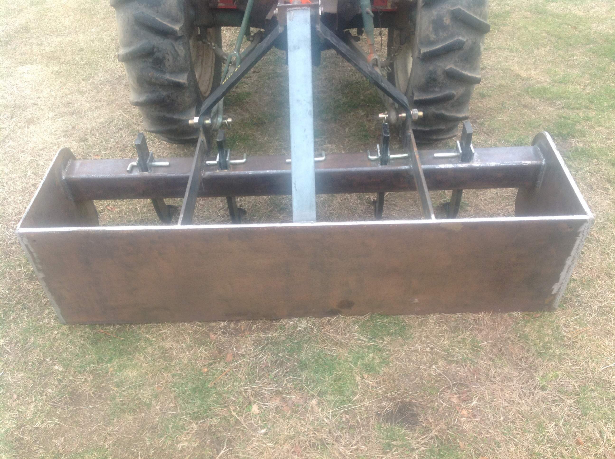

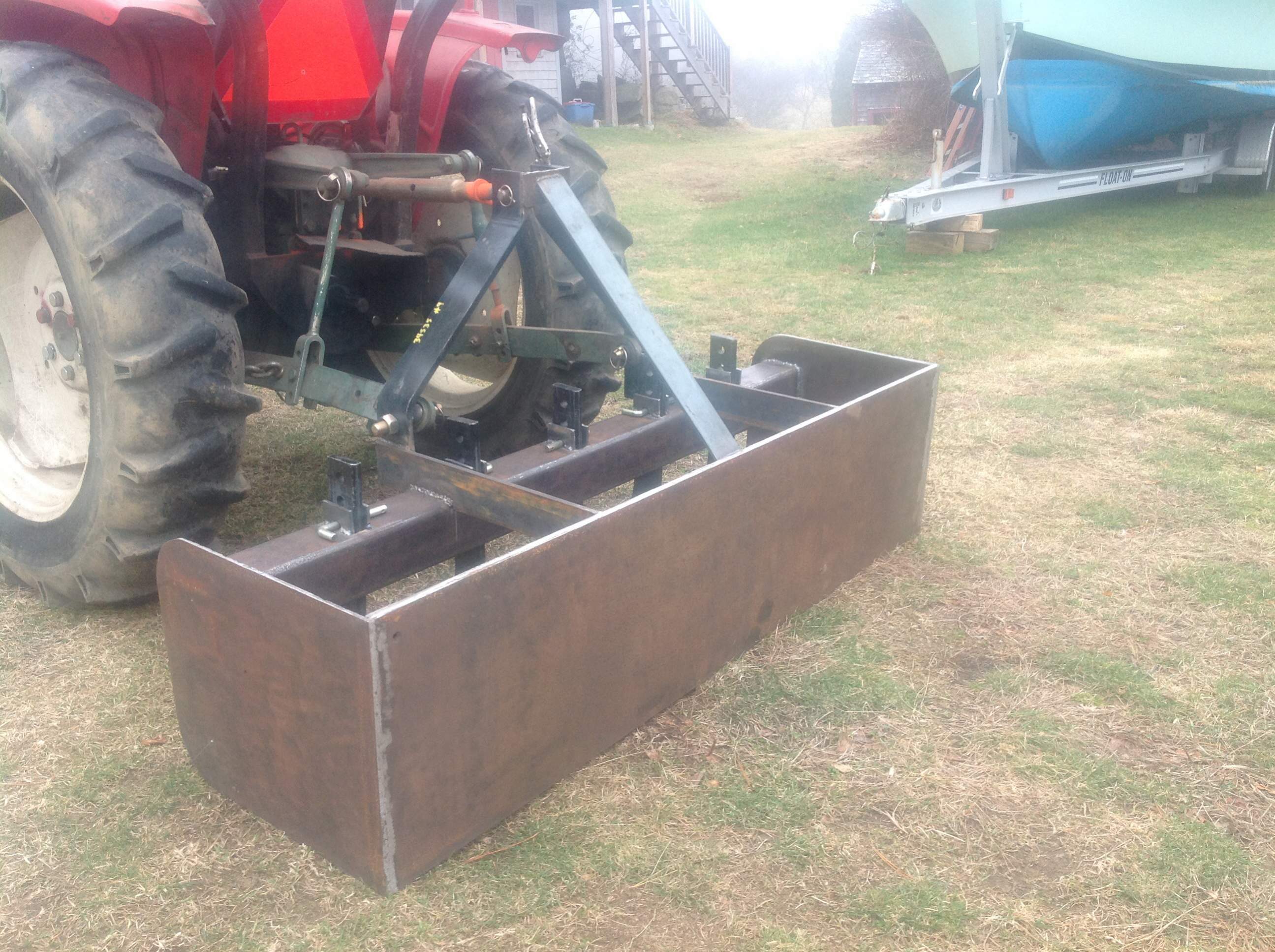

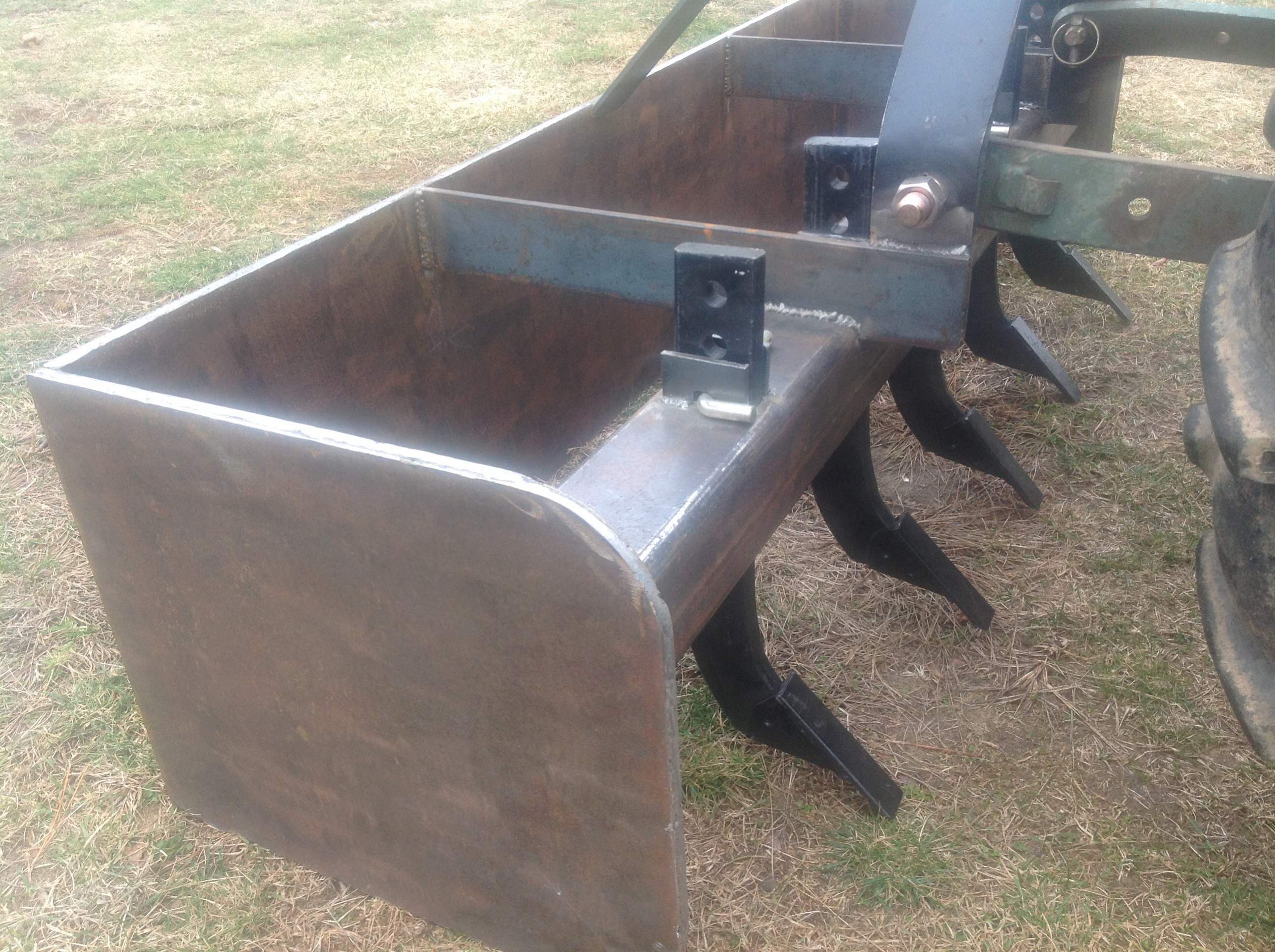

I finally did it!:cool2: It still needs: a second 1/4" plate on one side (the back and other side are made up of two 1/4" plates welded together) and the front and rear cutting blades.
I lucked out the day I went to the scrap yard, they had a 60" 4"x4" square tube and a piece of 1/4" plate steel that was about 59 & 3/4". I got the scarifier shanks and teeth from Agri-supply, as well as the A-frame support.
In order to start I had to get the old beat up Cutmaster 38 I got off of ebay working. I finally got the right torch, and inline filter, the correct consumables, and a cutting guide. There was a learning curve just to get the thing cutting right.....too much air, not enough air, no pilot arc (wrong amperage tip) power turned up too much, bad ground. My garage only has 110v, so the machine wasn't operating at full power. It was plenty for cutting 1/4" material though.
I didn't have any plans. What I did was to google "Box blade images" and to carefully study all the photos of box blades for dimensions, ratios, and other features/techniques.
The blade is on the tractor so I could weld with it in the air, and not hunched over the floor. I thought I was building it heavy, but it doesn't even come close to the weight of the 30 gal. barrel counterweight I made. Any guesses what this thing might weigh?
The steel didn't cost all that much, the scarifiers and other stuff I bought new was relatively cheap. It sure is a good thing I didn't have to pay anyone to do this...it would have cost a ton!! Even though it's not quite done, it sure is a nice feeling building your own (sort of large and heavy) tractor attachment. I learned a lot.
I wanted help with: (a)how to cut the forward (inside) cutting edge. Since it's a little less than 60", and the blade will be 60", I'll need to cut it. Can you plasma-cut hardened steel without it losing it's temper? (b) is it better to hinge the rear cutting blade, or not? (c) method of obtaining the 30 degree angle required for the cutting edges; can I weld some steel angle on to do that?
Oh. And yes, the welds are a little rough. AND....made with a little Lincoln 125 (gasp!) flux core welder. Interestingly enough, it was a **** getting the welds apart the couple of times I had to re-weld. It was NOT easy......them welds were *strong*. Now that I have used my tractor grapple to move big-*** stones for a few weeks without the welds I made attaching a new 1/4" top to the bucket cracking I have confidence in them.

Don't worry about cutting the edge. I'm assuming you'd be cutting off one end. you aren't going to weaken it at all. I'd cut with Plasma if you got it.
I prefer a hinged rear blade that can be bolted/pinned if needed.
Most blades have an angle iron welded into the frame that the cutter edge bolts to. I've saw some where the front and rear cutters were bolted to the same angle iron.
Looks real nice. I love it when a guy invents his own equipment without plans!!!
Keep in mind that when the scarifiers are down the box wants to dump real bad!!!! In other words it will put a lot of compression force on the piece of flat iron you have welded to the back wall of the box and the top of the hitch triangle. If it fails or buckles, it will also twist and distort the flat irons that create the triangle.
As it appears now your box assembly is a LOT stronger than your hitch triangle. May be fine, I'm not familiar with your tractor so don't know it's weight. HP is secondary. Tractor weight is what will test your box blade.
Again, nice job!!! :thumbsup:

Looks pretty good, few things the top edge (back edge without some bracing will bend.)
Here is a close up pick of mine which is BENT at the top 90 degrees to reinforce the top AND a 2x2x1/4" angle welded across the top back INSIDE the box area.
(NOTE: this was taken because I added the Receiver tube to my Box Blade. I USED to have a plate welded to that 90 degree bend and had a ball bolted in but had to un-bolt ball every time I wanted to switch from one ball size to the other (I have all 3 sizes of balls on different trailers.)
and INSIDE of the box back plate w Receiver tube welded in. note this reinforces the box blade a lot too the tube was A HF 18" one paid 12 bucks for it.
The BOTTOM of my box blade is a 3x3x3/8" angle welded on point to the 1/4" back plate. there is no cutting edge that is removable. SOME use the 3x3 and then drill and bolt hardened plate to the base. the angle is upside down between the side plates. On your's you would have to cut out the back plate some to install it.

Looks good. Definitely add the angle on the bottom. It provides a lot of stiffness to the bottom edge, and also is perfect for bolting a cutting edge onto. I'd replace the flatbar rear support on your 3pt with square tube, or at a minimum, weld another piece of flat on it to make it a "T" shape. The flat will bend in compression. Also consider stiffening the top edge of the back of the box by welding a piece of angle (or flat) to it, too, like this:
_
You don't need to grind the "point" off the angle... after you cut the rear plate off up higher (have fun!), butt the angle to it and fill the gap with weld fillet. When butt welding, you always want a notch to fill so you get good penetration into each piece rather than just on the surface.
It's surprising how heavy these things get after adding all the bit together, isn't it!

I'm with Mark on everything except welding the nuts. I don't recommend that for long term use.
It will take you quite a while to wear out your cutters. So when, not if, when the day comes that they need flipped or replaced the bolts/nuts may be rusted to the point that the bolts twist off or eat the threads out of the nuts on the way out. Usually caused by a couple threads of the bolts sticking thru the nuts and exposed. If you've welded the nuts, this will be a disaster to fix and will probably require cutting your flats loose so you can get at the welded nuts.
Additionally cutters usually have square holes in them for the bolts. Designed to use carriage or plow shear type bolts which require the nuts be turned to remove them.
I suggest using triangle braces between the cutter bolts and leaving the bottom open so you can access the nuts. Then when it's time to change the cutters, if needed, you can cut the nuts off with a torch and replace them without having to disassemble the cutter holder assembly.
