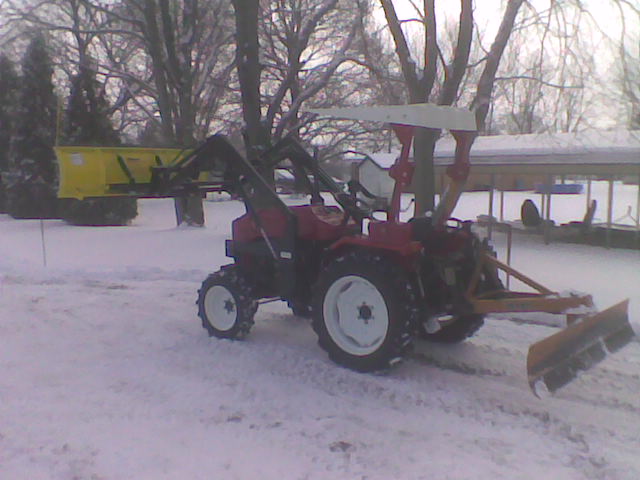

Chris, when you are hooked up to your Woods rear blade, what height do you think that the 3pt ends are at? Any chance of any pictures?
Not sure. I have never moved them in 700+ hours. It works fine with my BH, Bush Hog, Finish mower, Blade, and Post Hole Digger.
Here is the only pic I can find with the blade on it. I will take one tomorrow.
Chris

/ scraper blade ? #18
I just went out and looked it over. Too dark to get a picture. The lower 3 point arms have 4 holes drilled in them to accept the lift arms. It has the lift arms pinned into hole #2 if counting from the tractor out to the implement. I never paid any attention where it was because I have never adjusted it. I guess the closer to the implement its pined the more it will lift but yield less lift height.
Chris
