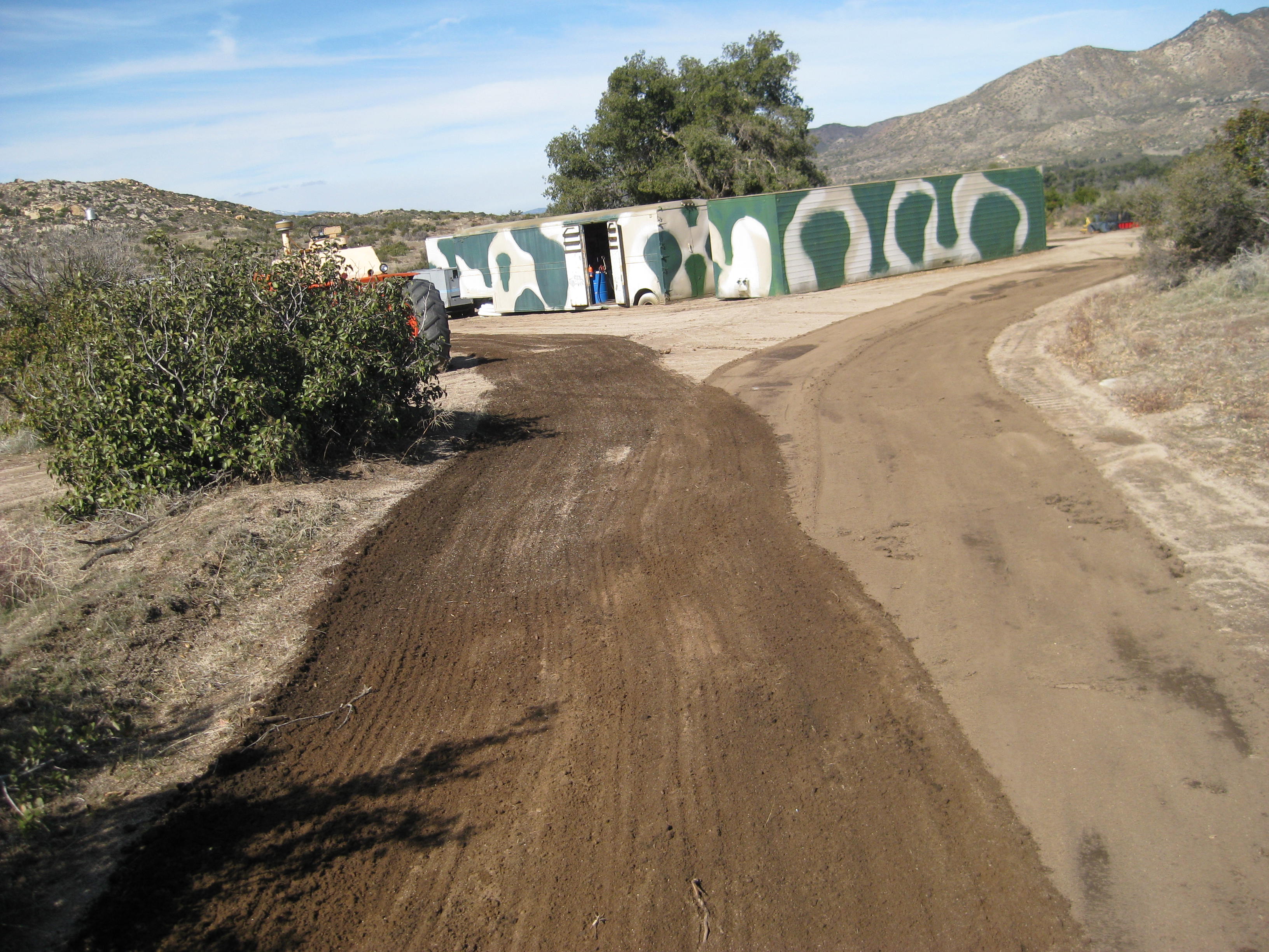

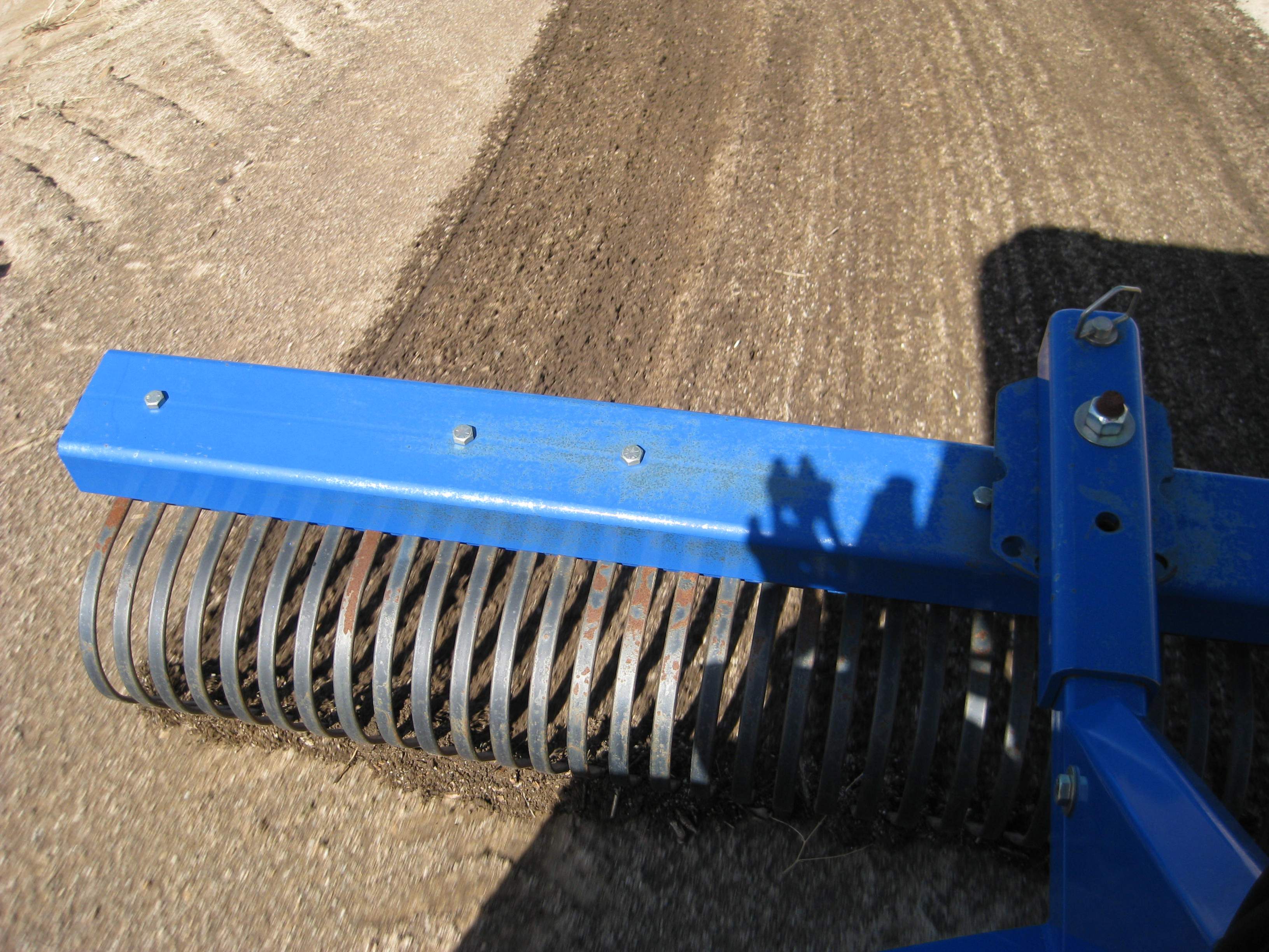

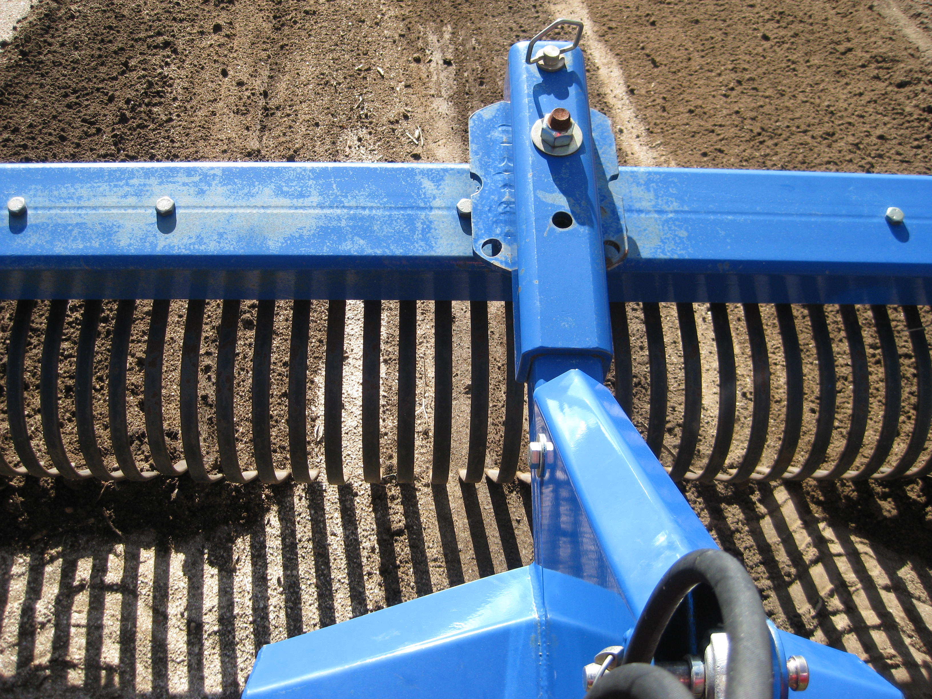

Brian (MtnView)...ever try using a good rake instead of a blade for gravel road maintenance? I don’t have any fines...its all #34 rock. Anyone else have any input on this?
/ Scraper blade - how wide? #60
Brian (MtnView)...ever try using a good rake instead of a blade for gravel road maintenance? I don稚 have any fines...its all #34 rock. Anyone else have any input on this?
I have only used my rake on the roads for final dressing, not for actual maintenance. I would think that a good heavy rake rake would work very well. I have not had a reason to use mine for that task.
In fact my rake has been apart for many years awaiting time to build a good hitch frame for it and install hydraulic offset and angle. :cool:
Someday when I have some spare time. ;)
