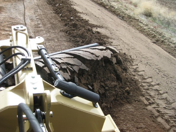

If you go this way, purchase the blade with no angle adjustment at all and get the cylinder from me. I can provide a 3 1/2" dia welded cylinder with a 1 3/4" dia rod with the proper length hoses and couplers shipped to you for less money than what LP charges for their tie rod cylinder and hoses that are to long with no couplers.

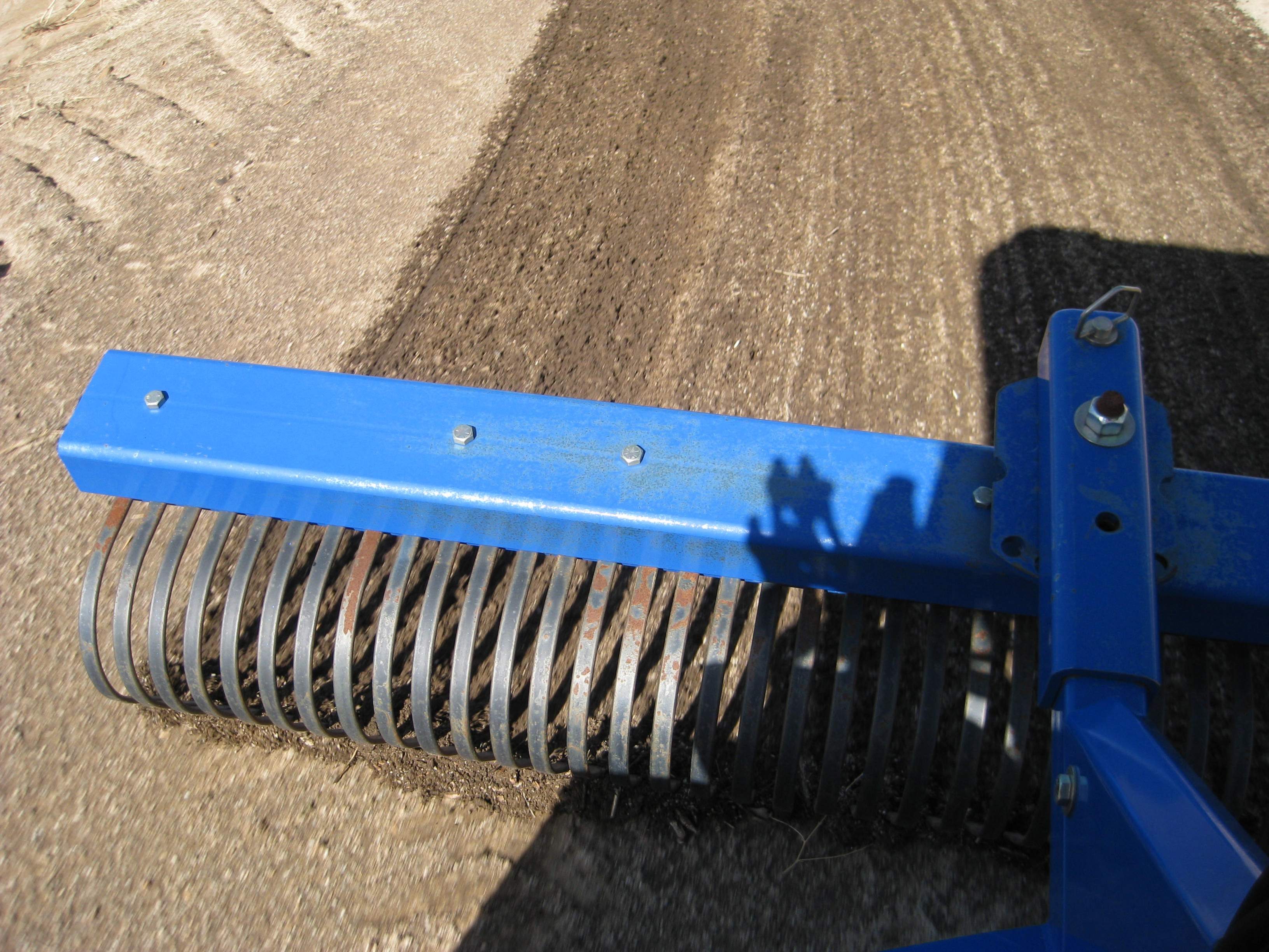

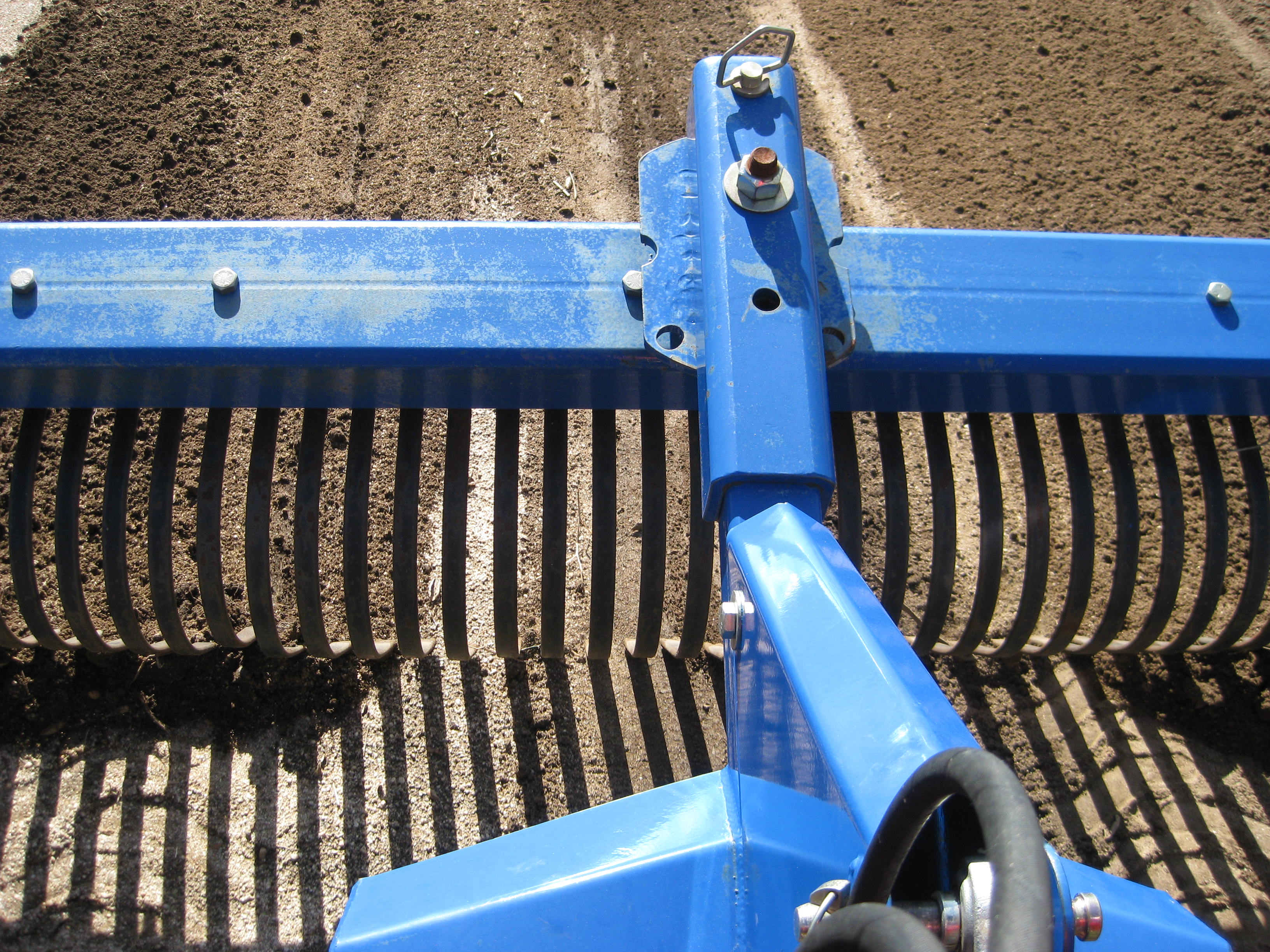

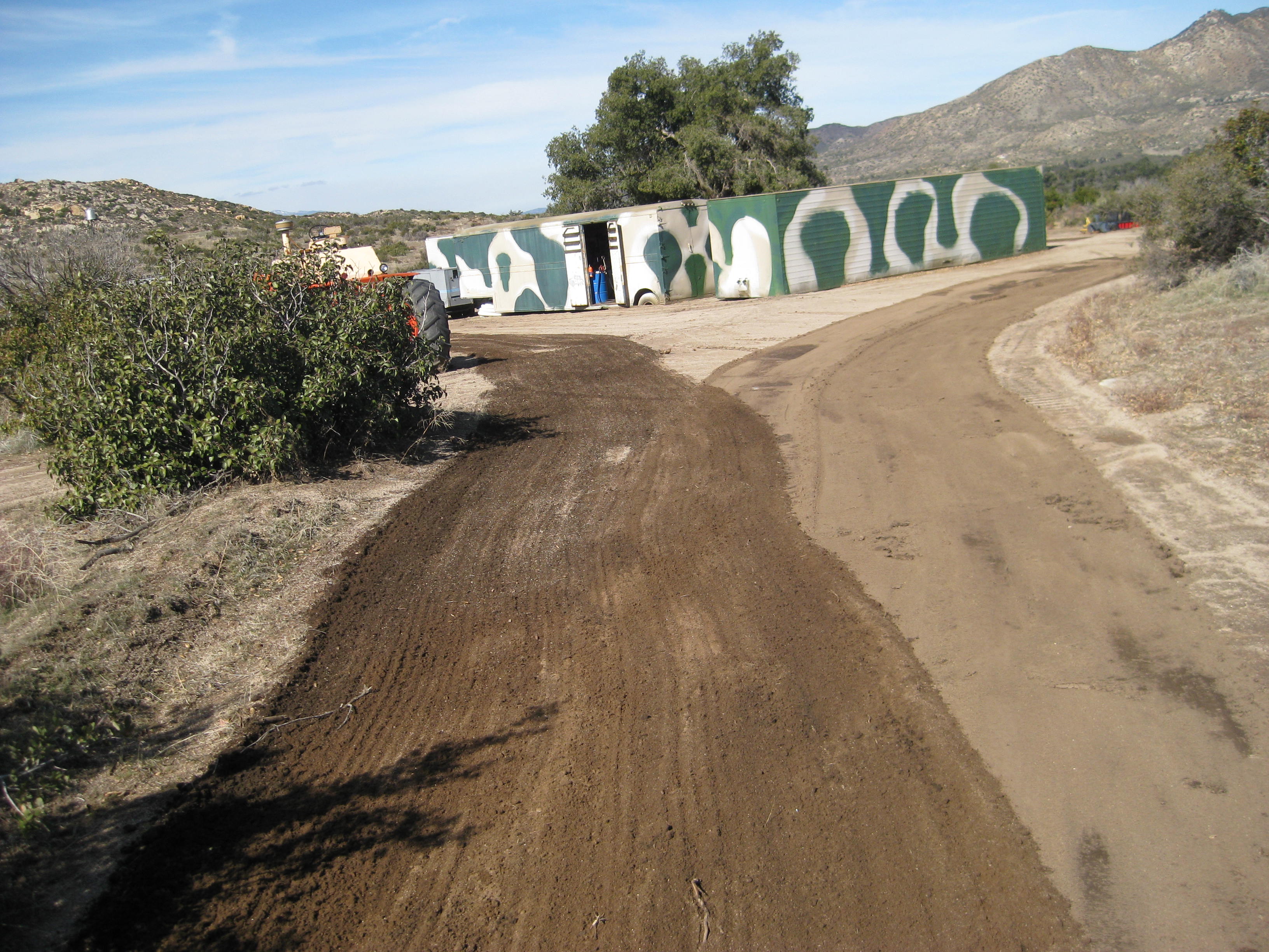

Brian (MtnView)...ever try using a good rake instead of a blade for gravel road maintenance? I don’t have any fines...its all #34 rock. Anyone else have any input on this?
/ Scraper blade - how wide? #60
Brian (MtnView)...ever try using a good rake instead of a blade for gravel road maintenance? I don稚 have any fines...its all #34 rock. Anyone else have any input on this?
I have only used my rake on the roads for final dressing, not for actual maintenance. I would think that a good heavy rake rake would work very well. I have not had a reason to use mine for that task.
In fact my rake has been apart for many years awaiting time to build a good hitch frame for it and install hydraulic offset and angle. :cool:
Someday when I have some spare time. ;)
