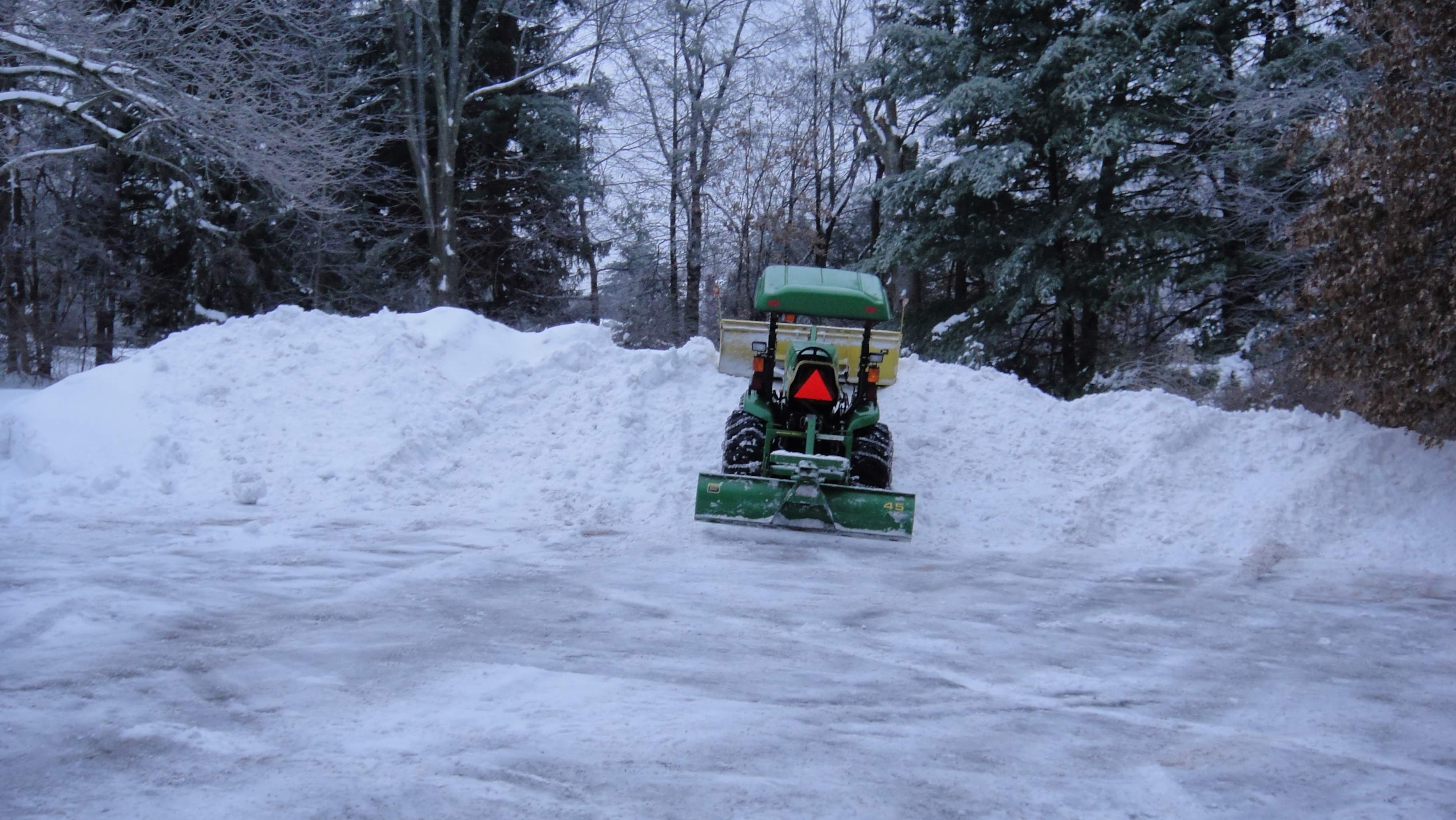

i need to know if i can use one of these on my b3000? it will go on the quick attach fel so i can go from bucket to snoww push with the flip of the levers. the push is 72 inch rated for 30hp, its weight is 400lbs. any help would be great thx, tony:confused2:

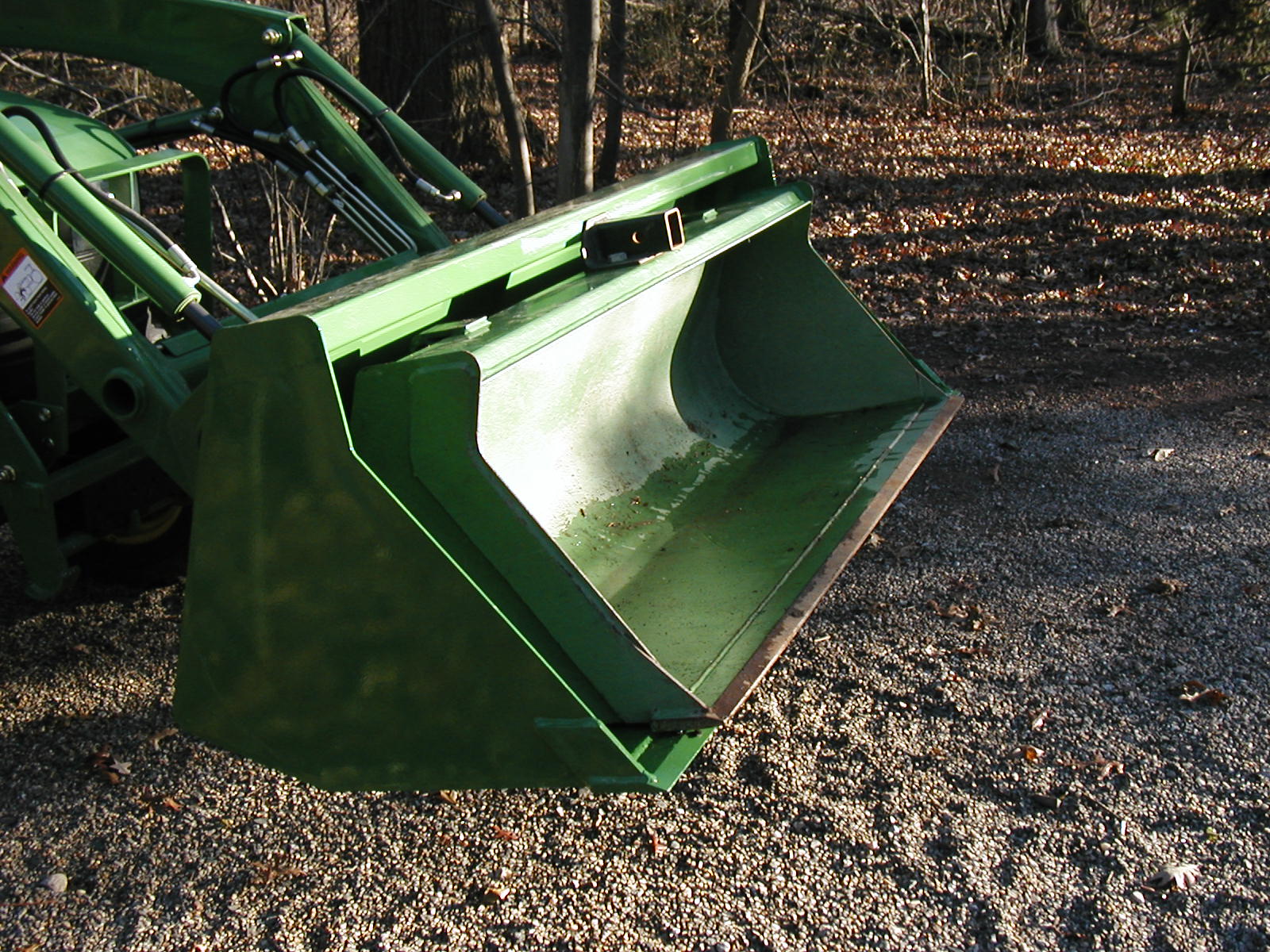

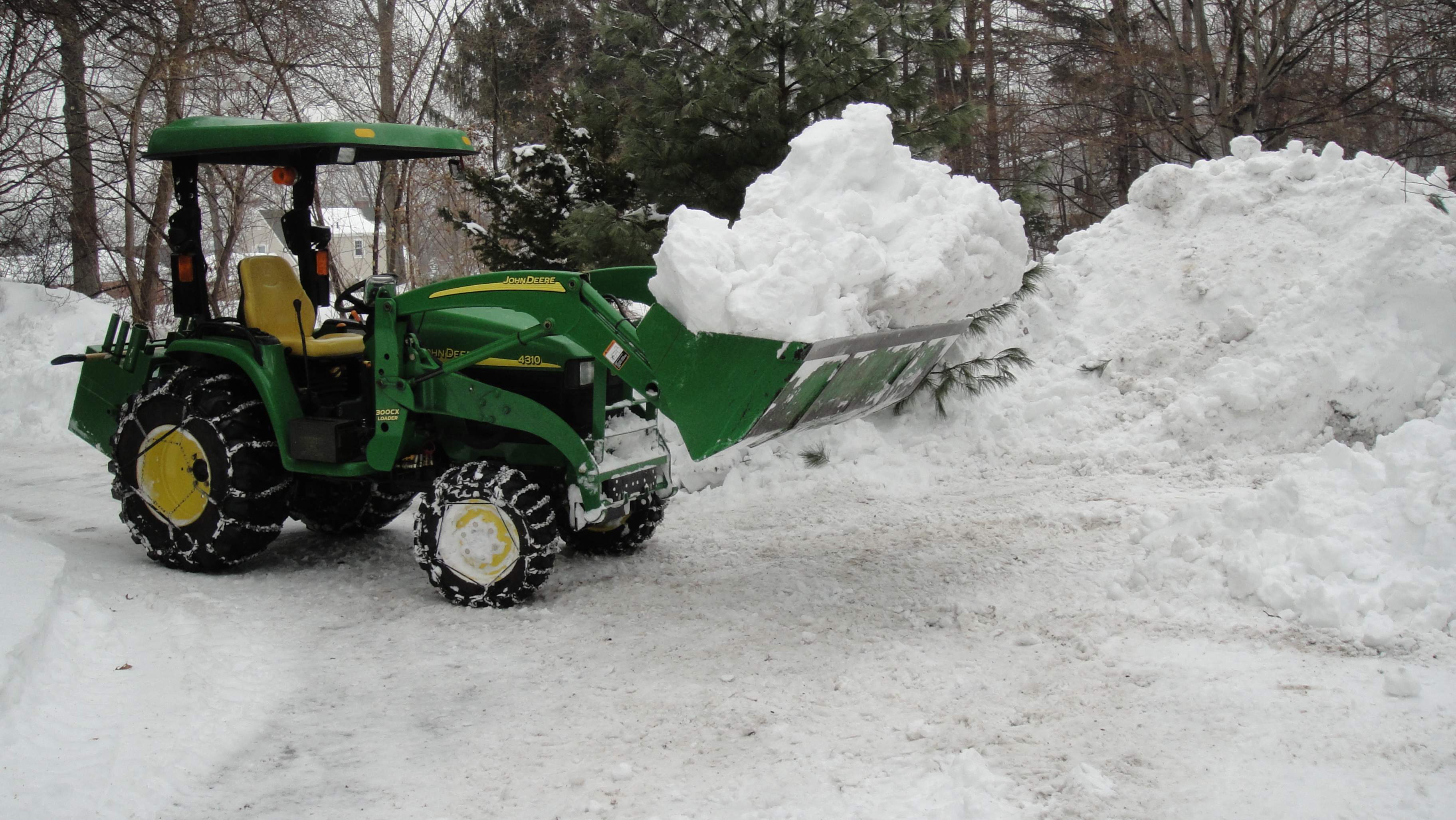

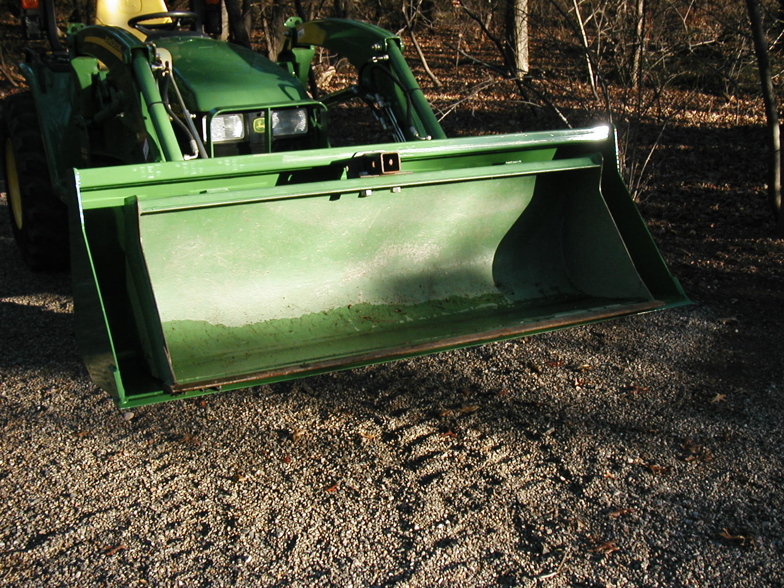

I thought of a pusher box myself, but instead chose a 73" high volume light materials bucket. Standard bucket for my tractor is 61"
It will do almost as good a job pushing snow but is way more versatile for other tasks, especially yard clean up.
So unless you are doing commercial snow removal I would recommend against it.
Going from the 5 ft to the 6 ft bucket made a huge difference, but now I rigged a power angle snow plow, which makes things even faster, but eventually I have to put the loader on to move the piles back.
