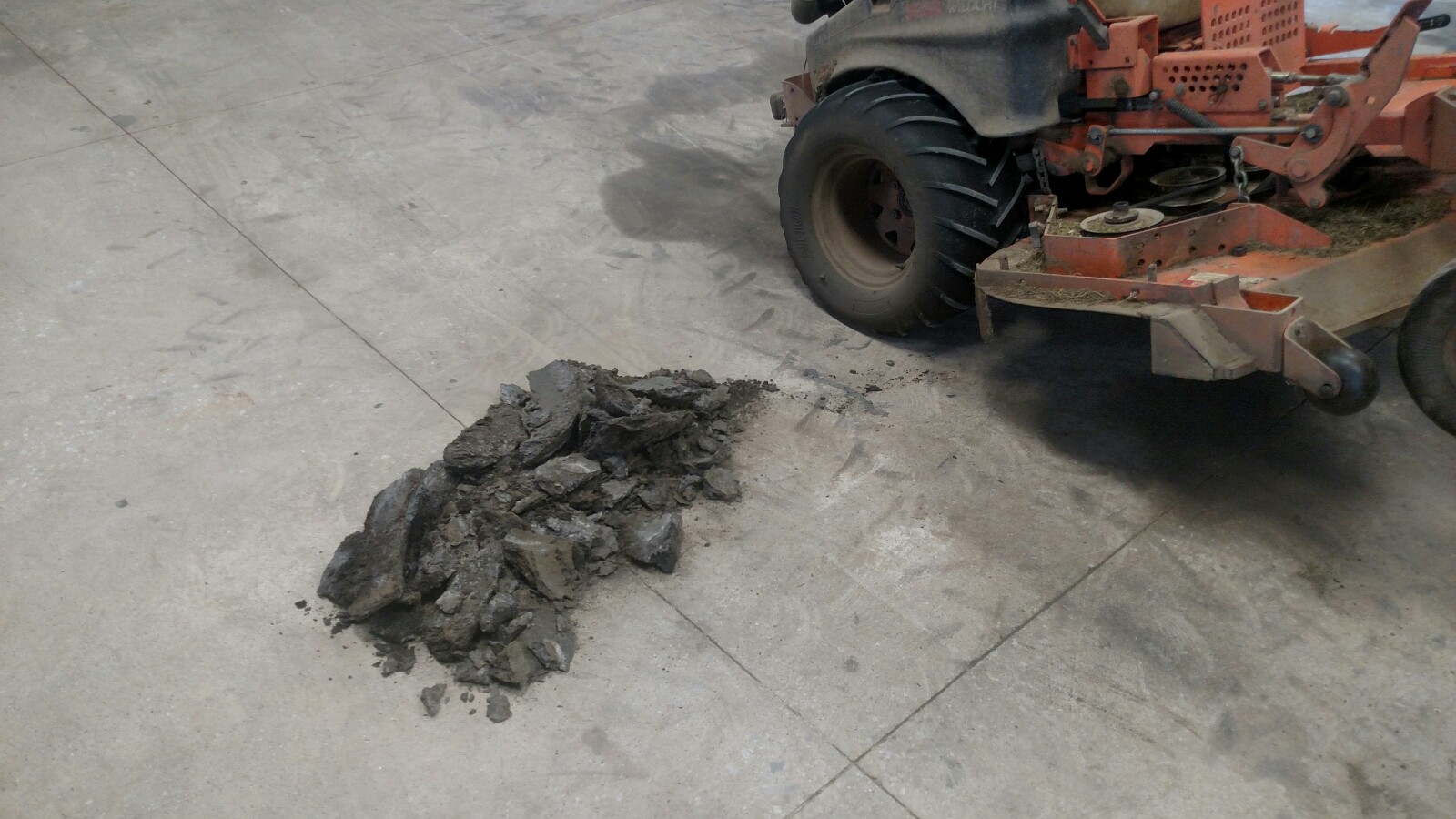

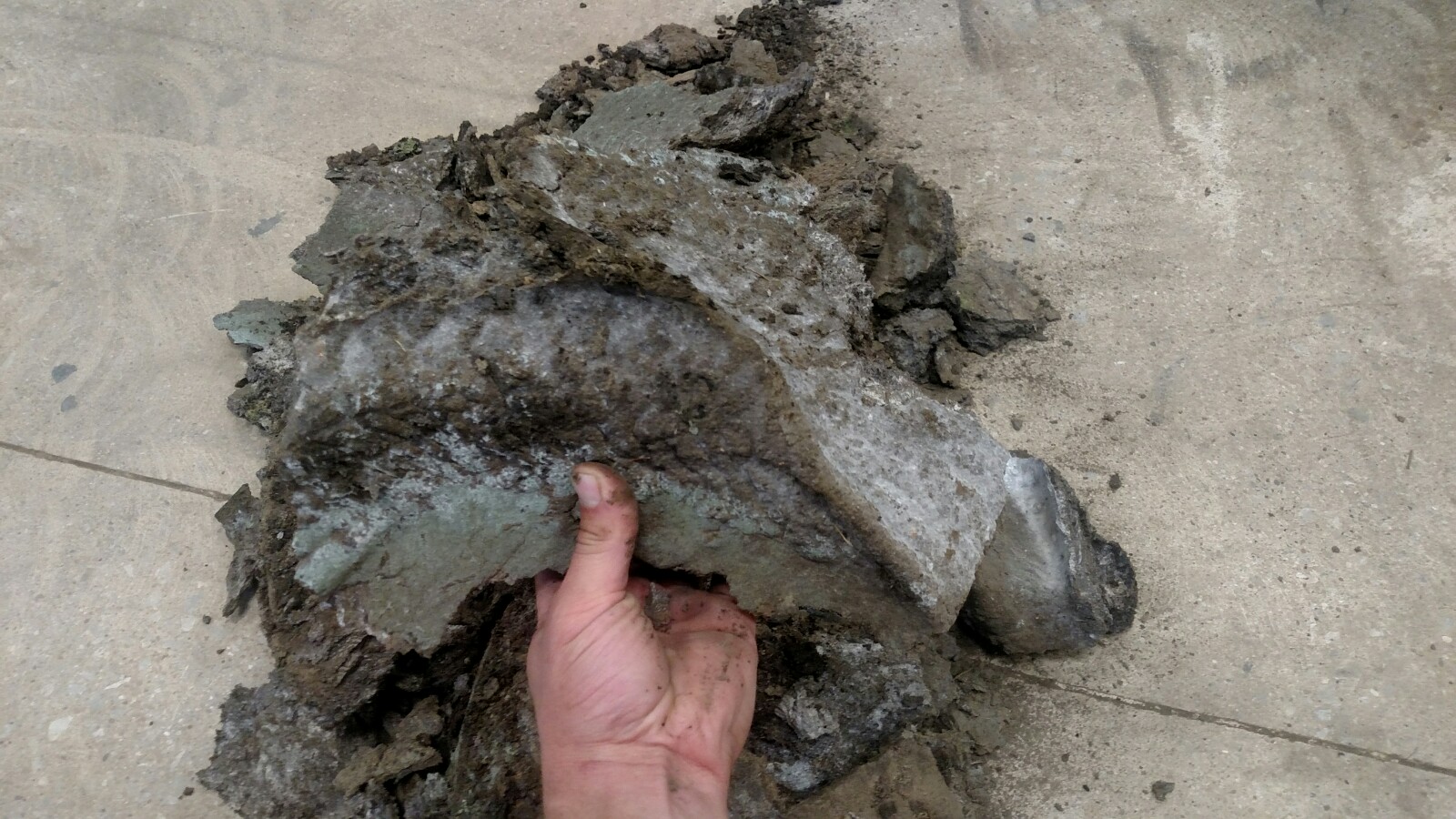

This is only from last mowing of my 6 acres last week. And not a drop of rain for over a week.
Dad's comparable bobcat zt223 doesn't seem to have the same issue

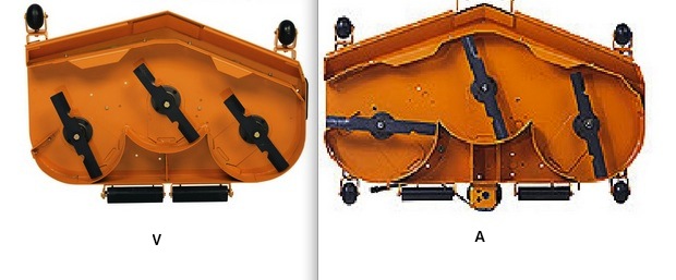

This is from another site: V on the left.......A on the right
I really don't see a noticable difference.
Maybe the difference is vertical? Like the mower blades are closer or farther from the deck? It the baffles are different heights or different height I. Relation to the blades?
I just don't see it.

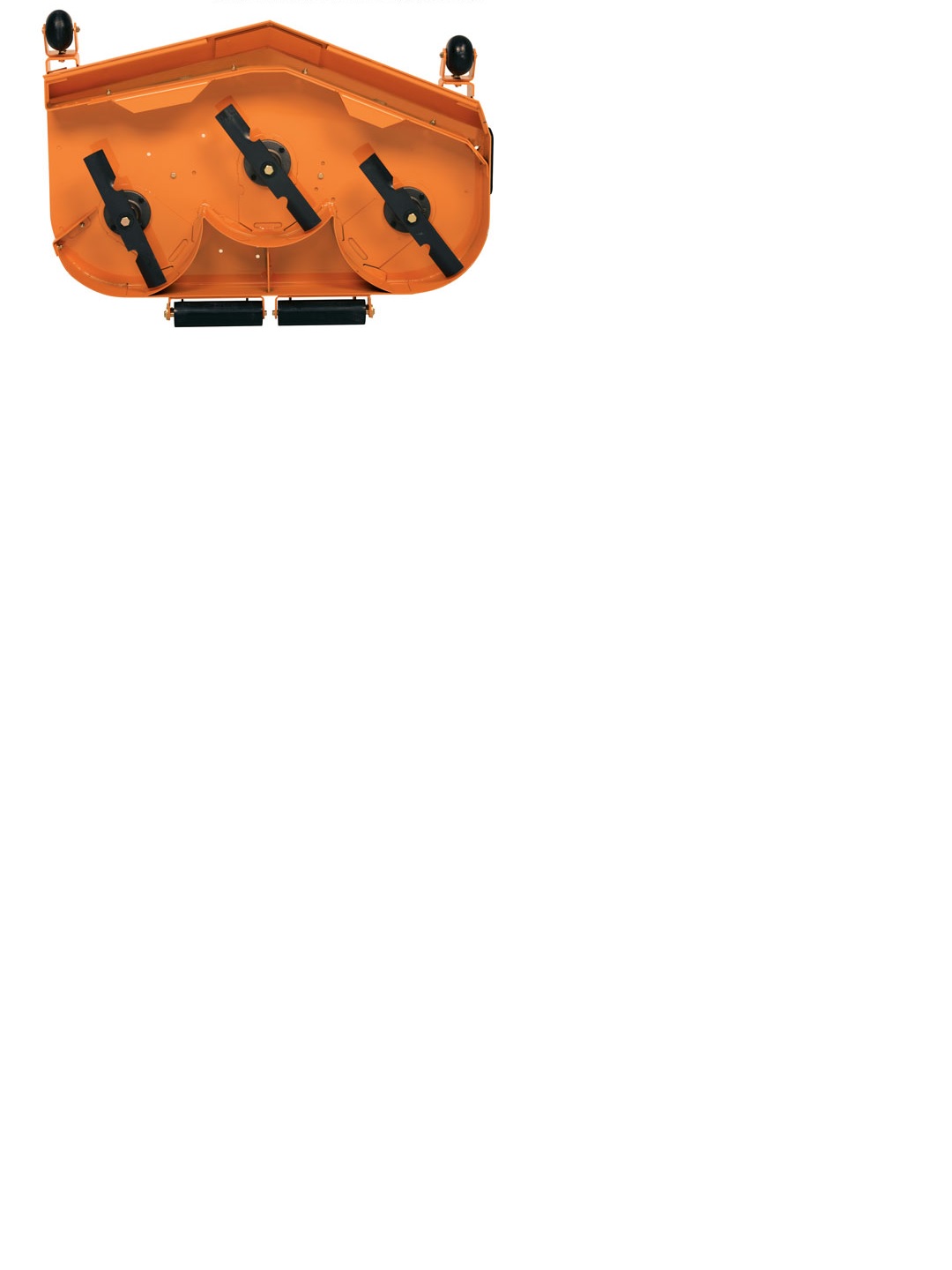

/ Scag Advantage deck just sucks. #17
The deck on the left widens a lot going toward the exit on the left of the photo, even in front of the center blade.
Bruce
/ Scag Advantage deck just sucks. #18
Thanks for fixing the picture. Never could get it to do that.
#19
I just assumed that was poor picture quality/angle.
Cause it also looks like the part/half of the blade pointing toward the front of the deck is much shorter.
Almost like the top of the deck on the left is tilted toward the camera more. Which would give the illusion of it widening more a d having more room in front of the blades
/ Scag Advantage deck just sucks. #20
It appears there's not much difference except the distance from the end of the blade to the baffle. In the front part of the deck its more and the back part is about the same on both decks. I think that was mentioned somewhere. Also the exhaust is about 2" wider. There's not much room for adjustments under there so you might have to live with the way it is and try different blades like you've been doing.
