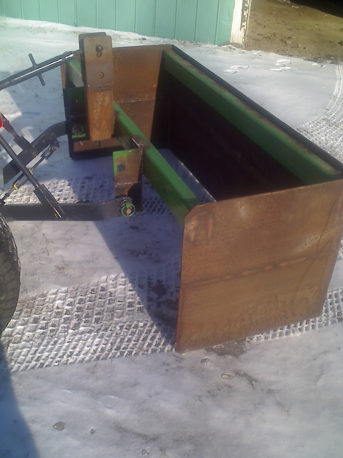

Started building a boxblade in the fall and had put it away for the winter as I do not have a heated garage to work on it. After reading some forums on here, I got it out and have been using it to move snow. I still need to install scafers on it in the spring and I was just wondering what I should use. I do not want to spend alot of money on this and I am trying to use scraps I have around the farm. I have some scrap steel and was going to try to make my own scafers but was wondering if I could use tines off a triple K that I have lying around. Would they hold up when I do my laneway or would they just snap in half? Here are some pics of the boxblade, I will need to make some modifications to the 3 point hitch in the spring.

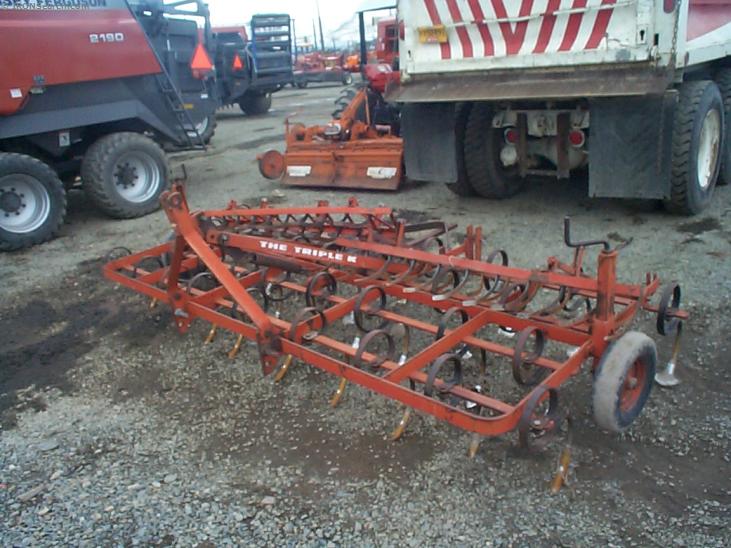

...was wondering if I could use tines off a triple K...
Not sure what that is, you have photos of what you are thinking about using???
   / Scafer for Boxblade
The tines look like what is on this culivator.

Those are designed to "give" I think they are called "S" tines and have spring to them. You could use it but it's very different from the very ridged box blade tines. If you are looking for aggressive deep digging, the S tines will not work that well. S tines break up dirt clogs very well.
Just want to use it to level out the driveway, I will not be using it on a regular bases. Drive way is based sand and gravel with 3/4 clear top.:D
   / Scafer for Boxblade #8
Should be good to go... :thumbsup: How many were you planning to use?

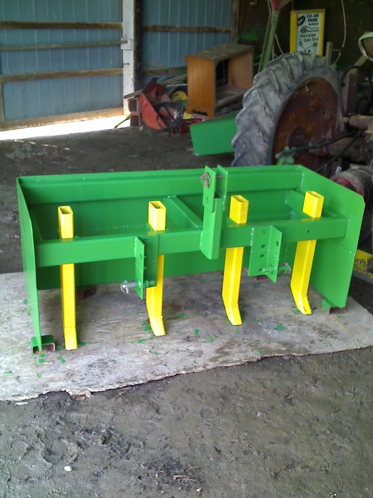

Well I made my own scarifiers out of 2X4 tubing, seems to work good.:thumbsup:

Got everything welded together, just have to paint. Took it out for a trial run and works better then expected.:thumbsup:
