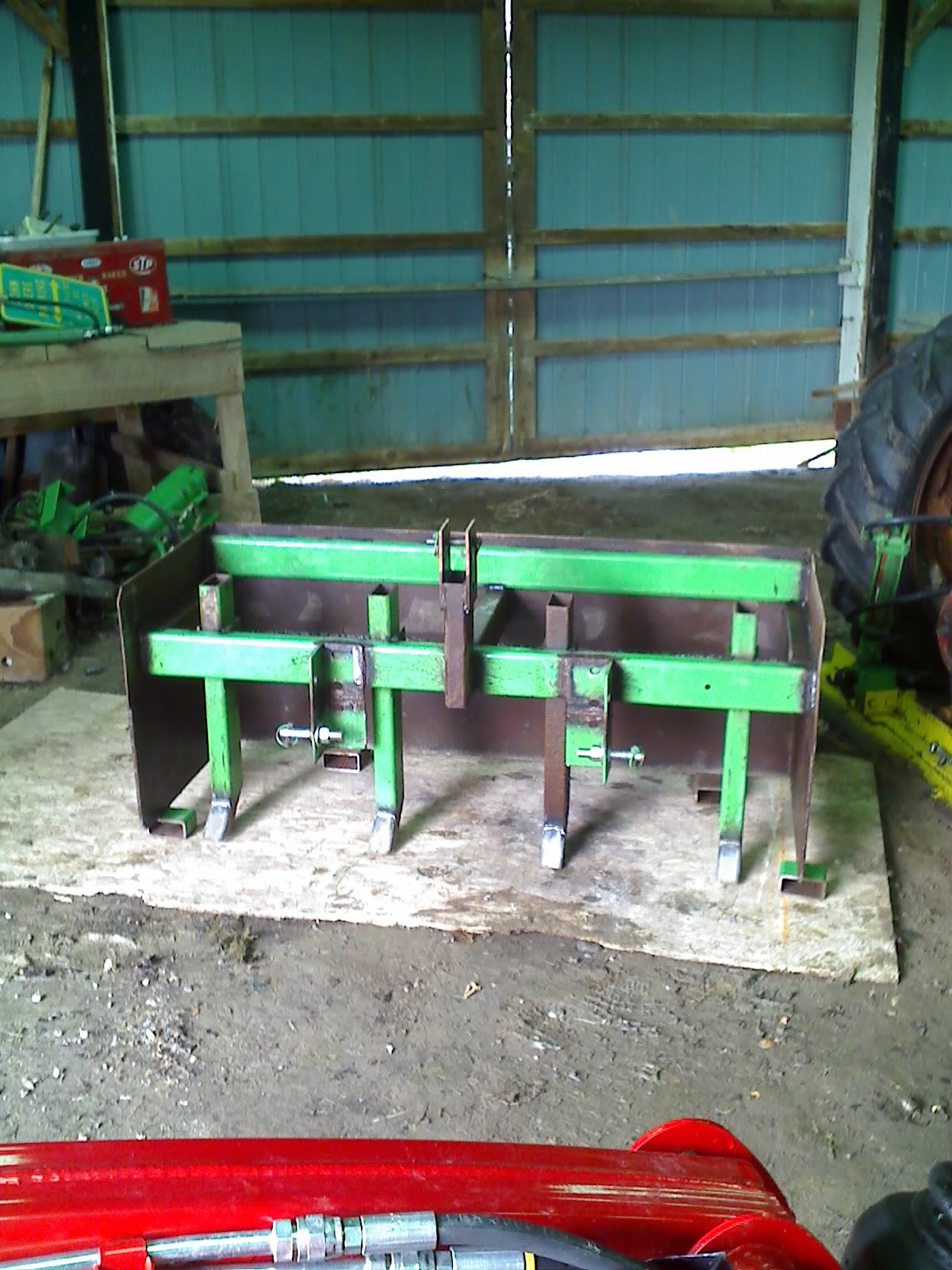

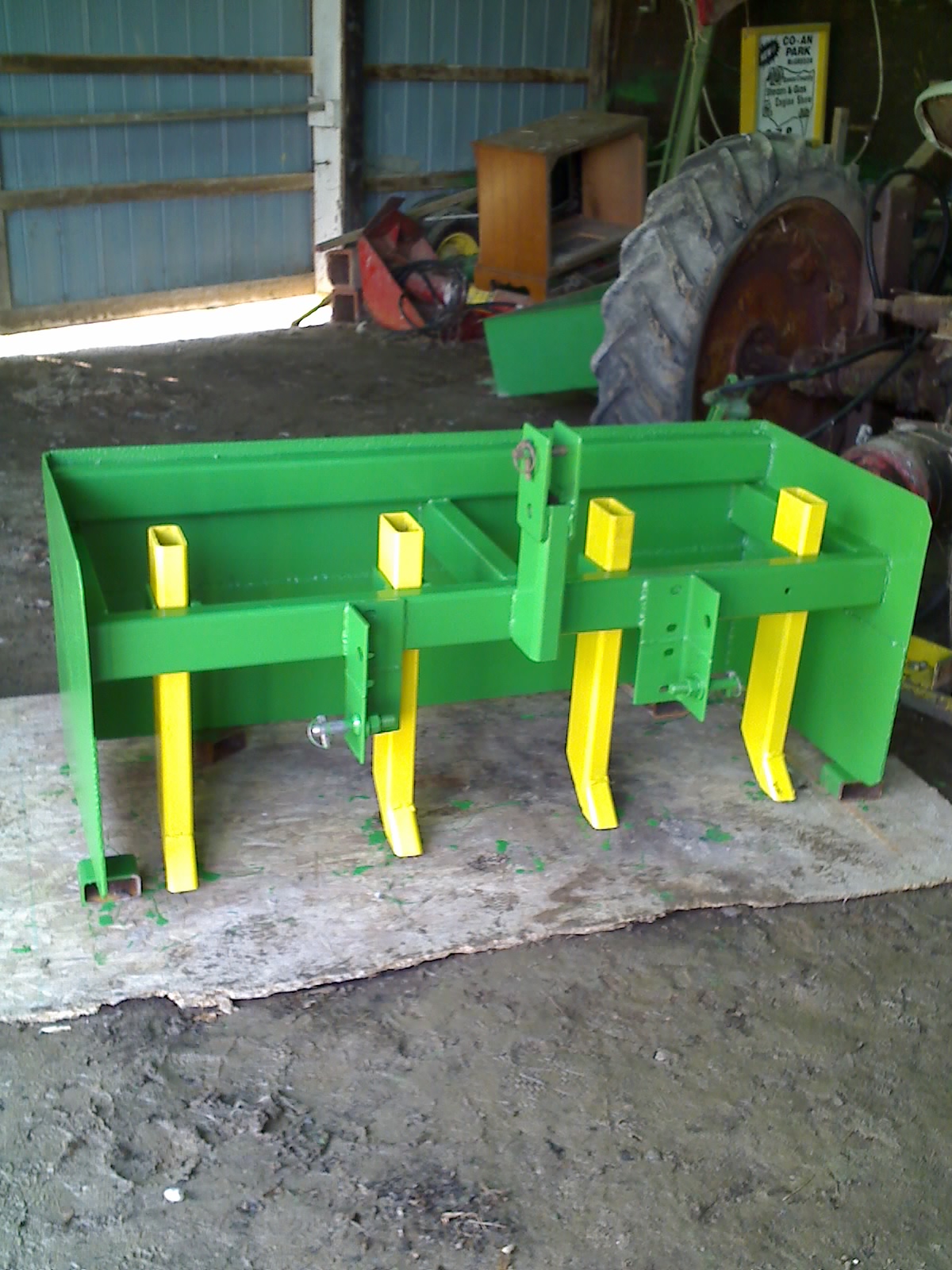

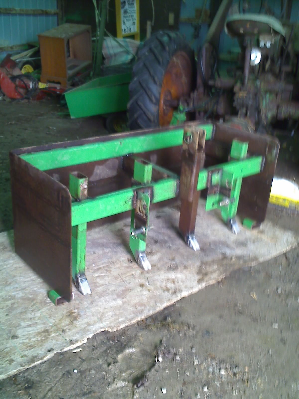

Wanted to add some extra weight to the box blade, so I bought some scrap plate steel from work, 2' X 1/2" X 5 '. The added steel weighs close to 225lbs.:cool:
Laid it out on the back side of the box blade. :D
Uploaded with ImageShack.us

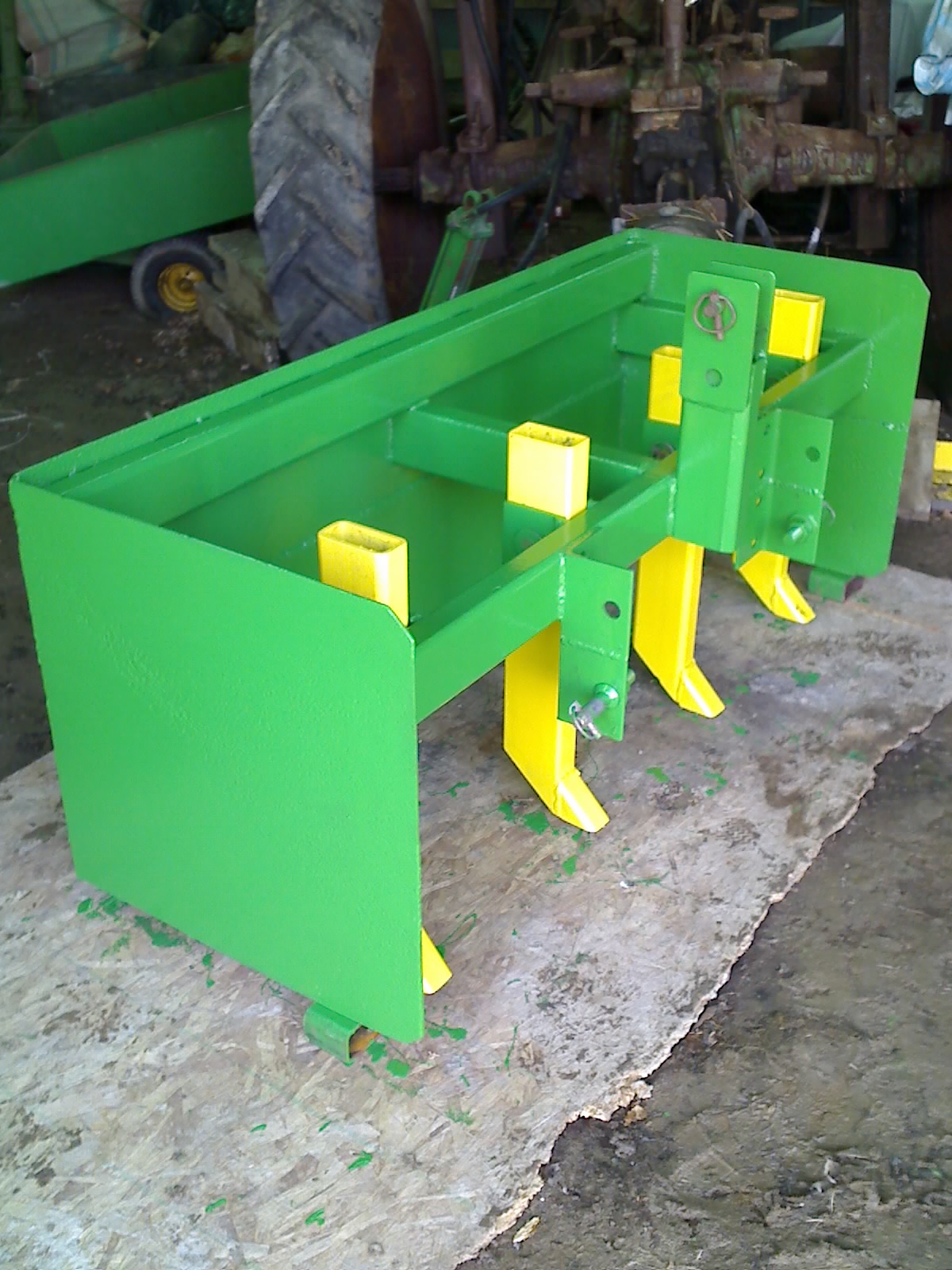

Welded it all around. ;)
And painted it. :cool:
With the extra weight I should be able to use the box blade as a ballast box also.:thumbsup:
