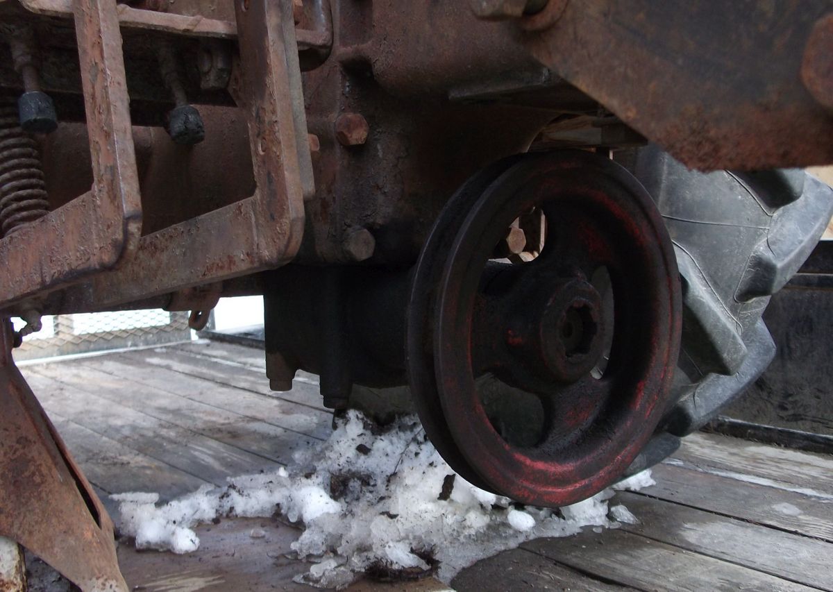

So, now I have a problem. I now have a Satoh Bison (S-560G) and I need to find out what year it is, (Under 1000 serial number) and a good clear version of the service manual. It needs work! It is a restoration project that I hope can bear some fruit for this summer. If I can get it running and be able to use it while I'm doing parts of it that don't the affect operation then I can do the major work next winter, of I can make a place to do it. So here's some pictures.

Looks like a good match, but I'm concerned about the CCAs. It was bitter cold up here this year, and that includes within the last week. Today it was over 40 degrees, but last week it was in the teens. I'm just glad we didn't get the big storm they were forecasting. I'm slowly moving down my list. Here are a couple of pictures from the last couple of work days. One comes with a question. Do any of you, (S-650G owners) have a mid mount PTO? I haven't seen it listed as part of the tractor configuration, but as you'll see I have one on my tractor. The second set of pictures is my tar filled gas tank.
Looking at the middle picture there is a lever that engages the PTO? It doesn't seem to lock front or rear at this point I'm wondering if it has to be under power? In the pictures of the gas tank and filter you can see why the previous owner thought it was shot. Looking into that filter you might guess a new tank was in order as well. I just happened to know that there was a filter there.
