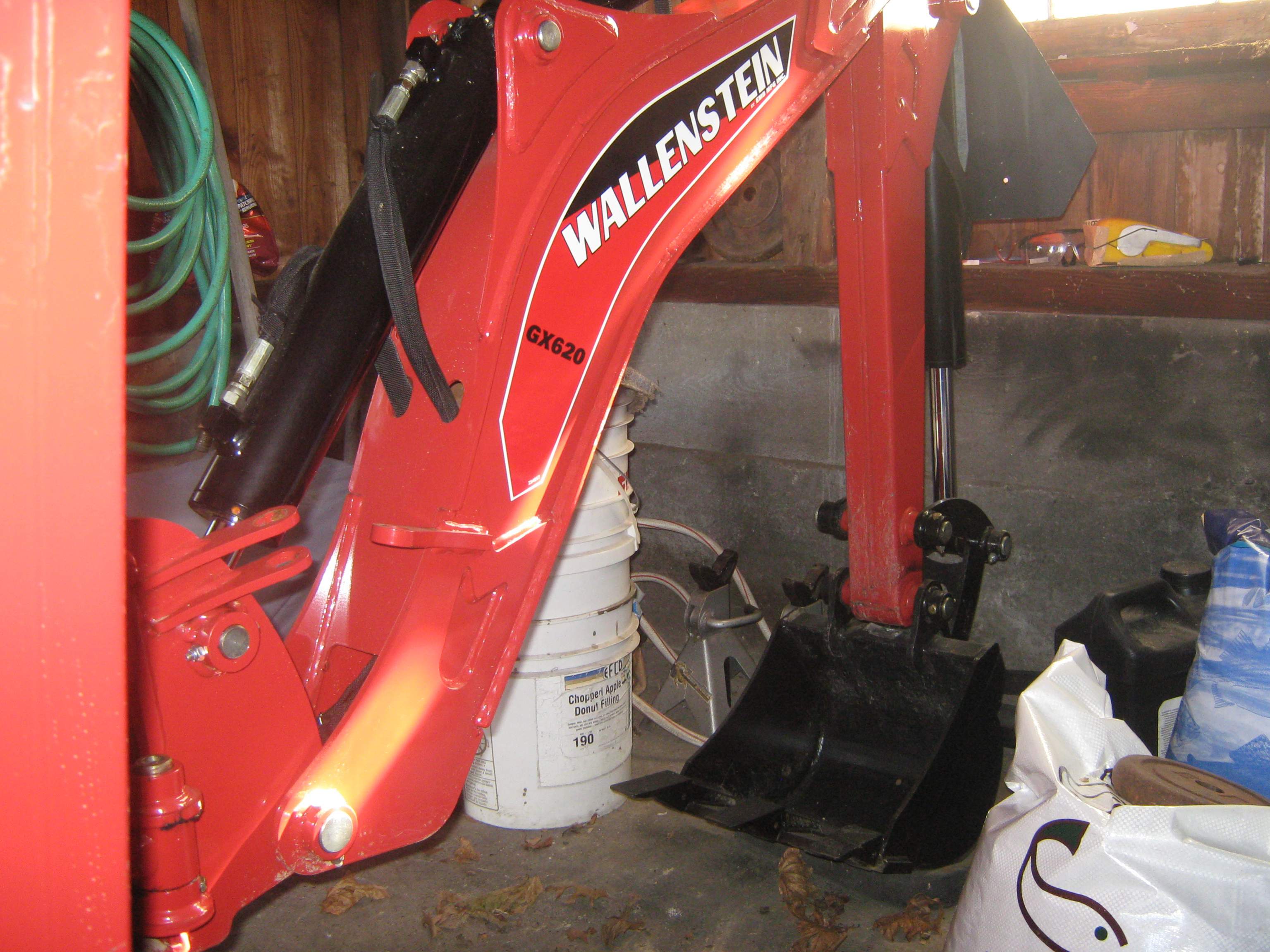

In theory, it shouldn't happen, but the weight of the backhoe is fairly considerable, especially when you consider the leverage of it hanging out the back of your tractor. For this reason, most of them have a lock to keep it in position and take the strain off of the cylinders. It's even worse when bouncing around while driving.
Eddie
In theory, it did happen to me. As you can see in the picture, i had my hoe a half of a inch above the pad i rest it on. I forgot to lower it, 24 hours later i went in the garage to get something. The backhoe was still a half a inch above the pad yet. Of course in the picture i had lower it before i took the picture. But it shows the stress on the boom cylinder. How many people could say there backhoe could do this. I was shocked.
