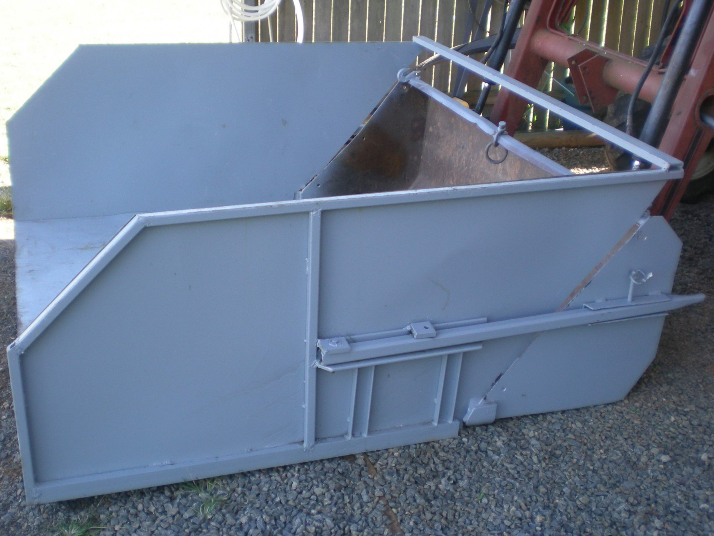

From HollyRidge campground that we go to... used for leaves and sticks. Only thing attached to the bucket at the angle iron on the sides.
That's bigger than I want but I like the design. I'm gonna copy it. Sort of. The open top would really let me pile up the bushy stuff. And it can be easily dumped.

So I think the main side bars, swing out from the one bolt that holds it on. Look at the bottom lip of the bucket, the outside edge catches on the inside and may (?) supports some weight from tilting forward.
Whatever you come up with, make sure you post back!!!
I will post pictures. The front lip will for sure need to fit into a slot to help support the weight. I want my extension sides to butt against the existing bucket. Then I think I will run a bar on each side of the extension to the hooks I have on the top of the bucket at the sides for clamping to the bucket. The bars would run from the front of the extension to the hooks. No, I have a better idea, instead of bars I'll use chain binders. I'm not sure yet how to pull the bottom of the extension tight against the front lip of the bucket, maybe use a chain that wraps around the bottom of the bucket and connects to the center hook welded to the top of the bucket.

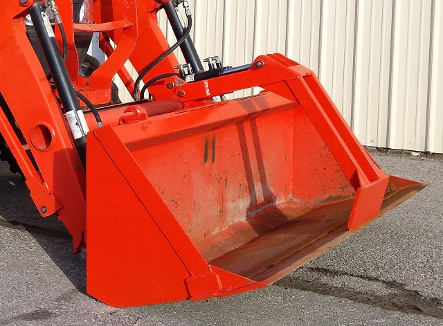

I have something similar for leaves and very small brush.... IT was some sort of guard that turned up in surplus material (junk) pile....
dsfel-basket-jpg.714717
