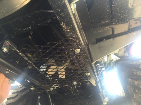

Just a reminder for owners of early SA tractors, if you have done your own maint you should have noticed the plastic fan that is located at the end of the driveshaft from the engine to trans. Customers found that the fan blades were being broken by tall grass and or small twigs, thus once broken there was no cooling for the trans. It took Yanmar a long time to come up with a factory housing to keep the debris from the fan, in the mean time a lot of dealers/owners installed a piece of chicken wire about 20 by 20 " square under the shaft to keep grass & twigs from hitting the fan, also a few used a small pipe from side to side that would keep the grass bent down before the fan but not twigs. The Yanmar unit is expensive to purchase & install, last known was 400 plus. While you are checking this make sure that the cooling fins on the trans are clear, and not packed with grass and debris.
/ SA TRANS FAN #2
$400+ for what, the fan blade? o_O
I made a new fan blade for my Eaton trans on my Kenbota. I think I have about 25 cents in sheet metal in it.
That's a good idea for the guard screen. (y)

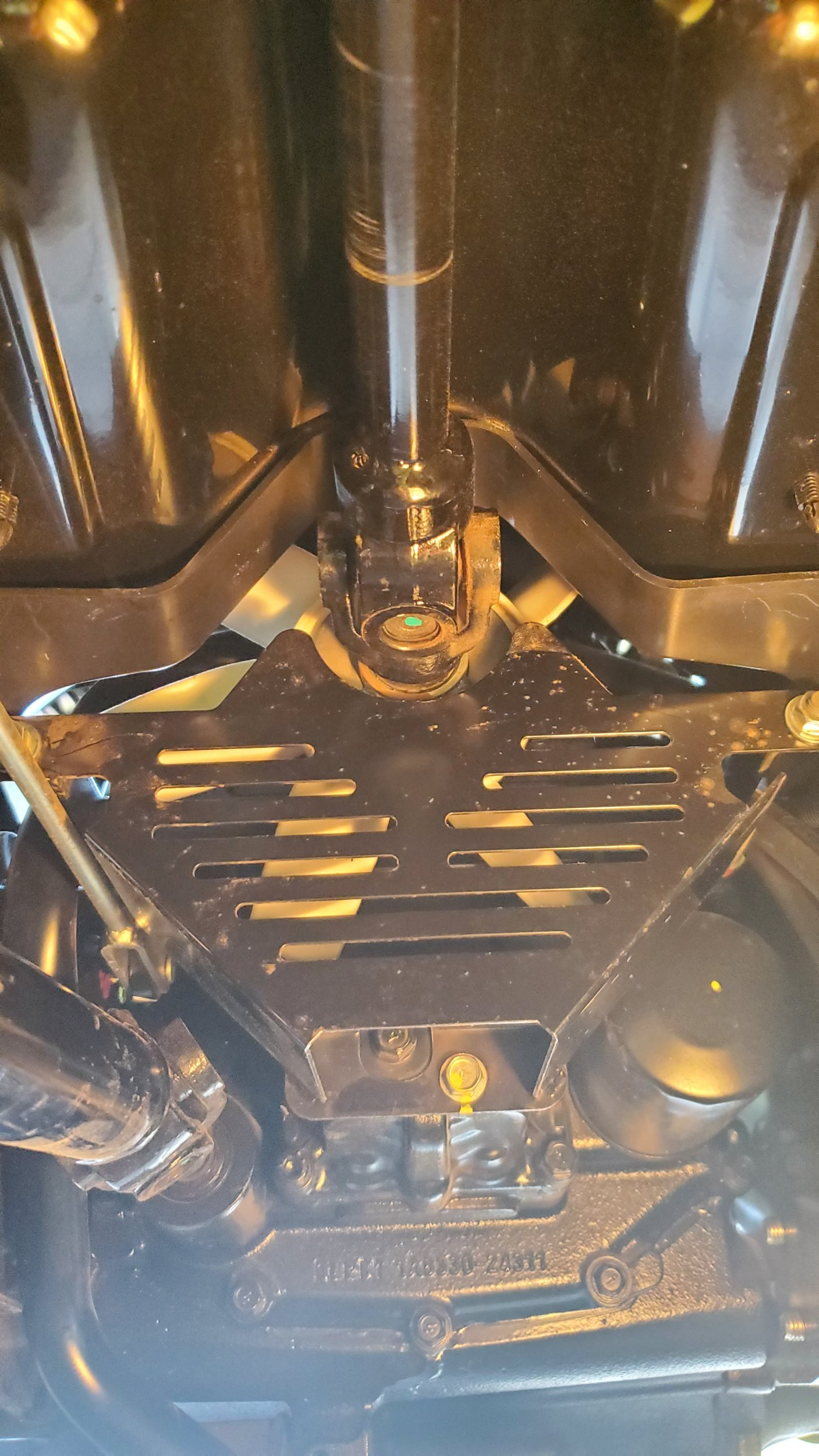

The SA-325/425 now come standard with a guard covering the Trans fan. I was going to make one for mine until I crawled under it and looked. This part should fit the 324/424 also.

For what it is worth, my 424 that I took delivery of in Aug 2020 came with the guard shown in the photo above installed. Not sure when it became standard equipment but it would appear to me to have become so.
/ SA TRANS FAN #7
I have 2021 324 with the guard on it. Last week I managed to get a stick sneak by the outer edge of the guard. Shredded the fan blades right off. Going to buy the fan and try to install it myself. Fingers crossed, 🤞. Not wanting to pay 400.00 or so to get it fixed.

Shoot, was expecting my replacement fan to get here today but didn't, meanwhile I was taking the cover to take a look at how this is going to go but unlike other videos I saw on doing this, the shaft doesn't collapse/extend and there is a welded beam under it, so how is this supposed to be replaced?

No idea on how to replace it, but several on how to make it better.
While you have it apart is a chance to improve that poorly designed Yanmar fan guard. There's really no excuse for such poor design. Having made the mistake, I'm surprised that Yanmar doesn't provide an upgrade for free.
If I had one of those plastic fan SAs, the addition of some small mesh stainless steel hardware cloth pop-riveted over the OEM Yanmar guard would be an improvement worth doing. That one is a no-brainer. Amazon has the SS hardware cloth. Mesh size is rated by number of openings per inch.
Another improvement requiring a little more thought would be to fit a fan with metal blades. McMaster.com stocks a variety of metal fan blades. Most water pump fans on older cars were made of sturdy metal for good reasons - the same reasons also apply to Yanmar fans.
