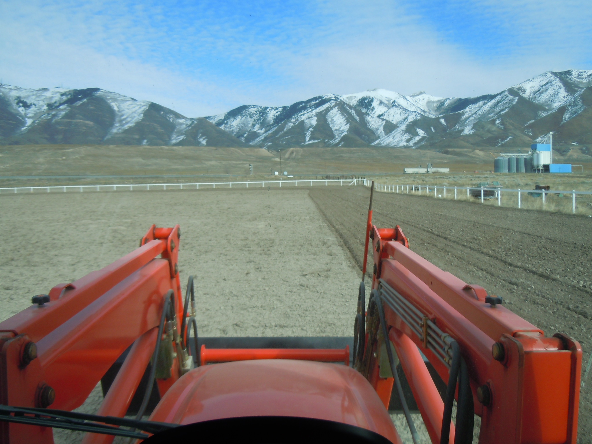

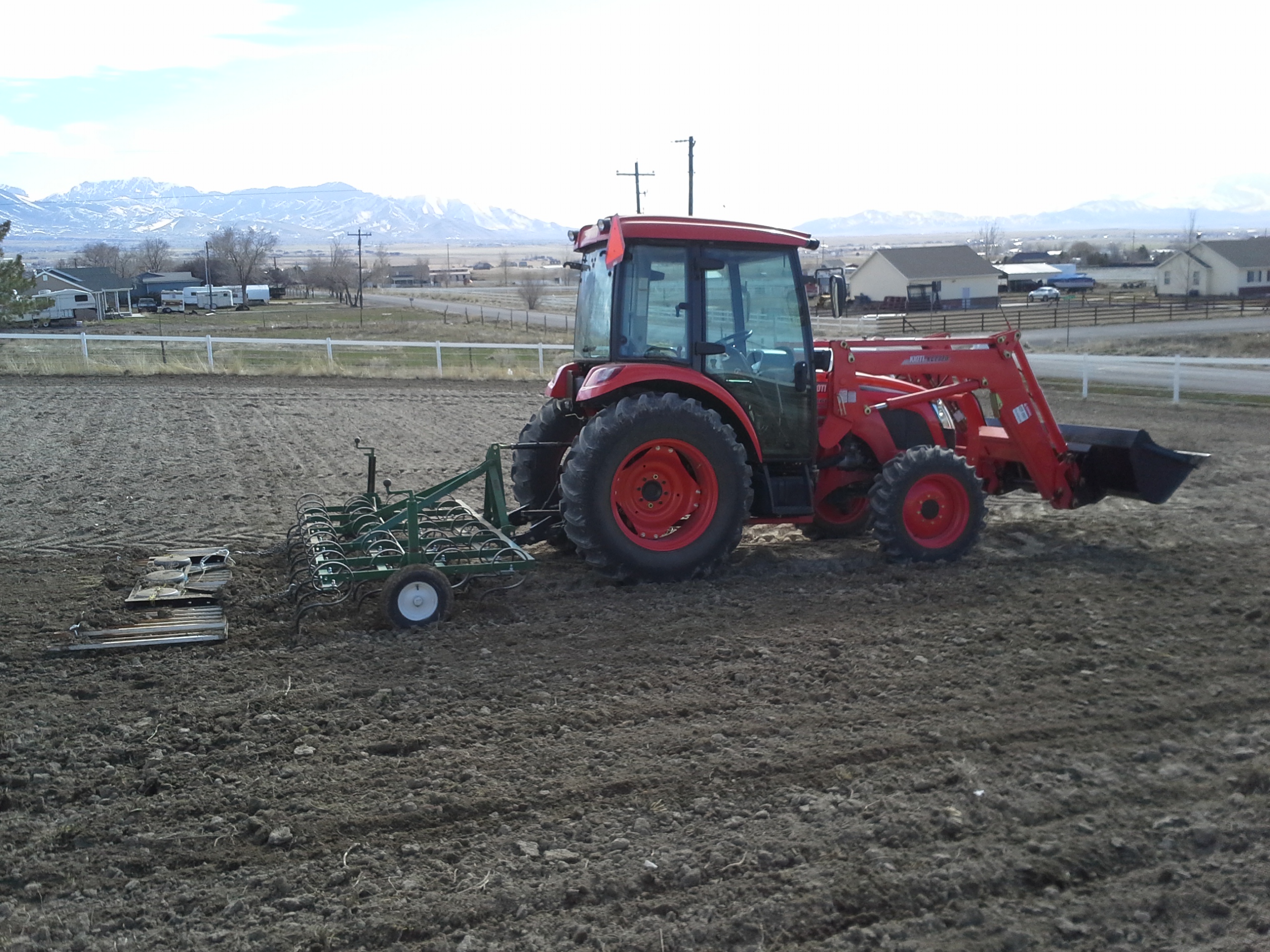

If your goal is to smooth out your field, a spring tooth harrow with some sort of drag behind it would work great. Like the one I showed in a earlier post. I always thought plowing was to uproot unwanted vegetation. But hey, I'm just a hobby farmer with no real long term experience. Maybe others could add to this.
This is what my field looked like using the method above.

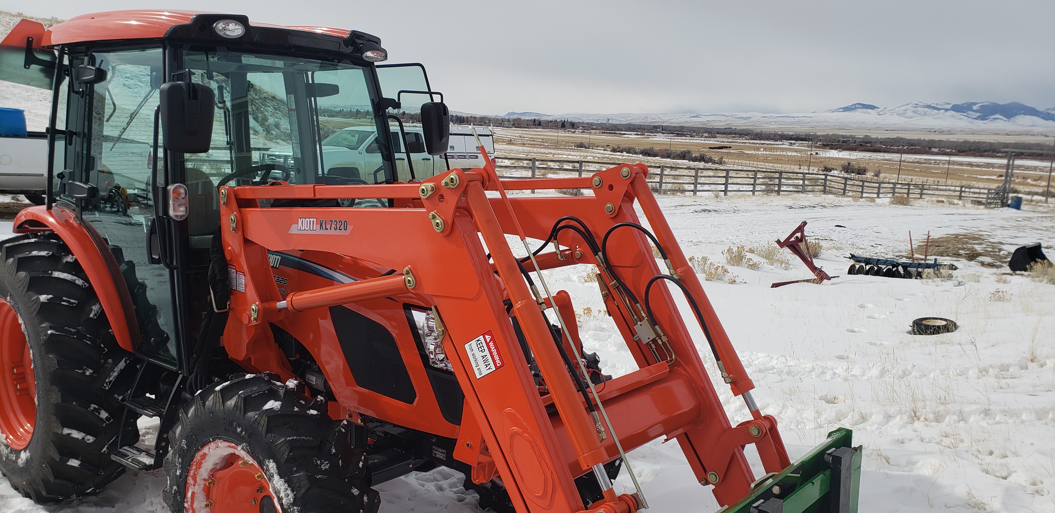

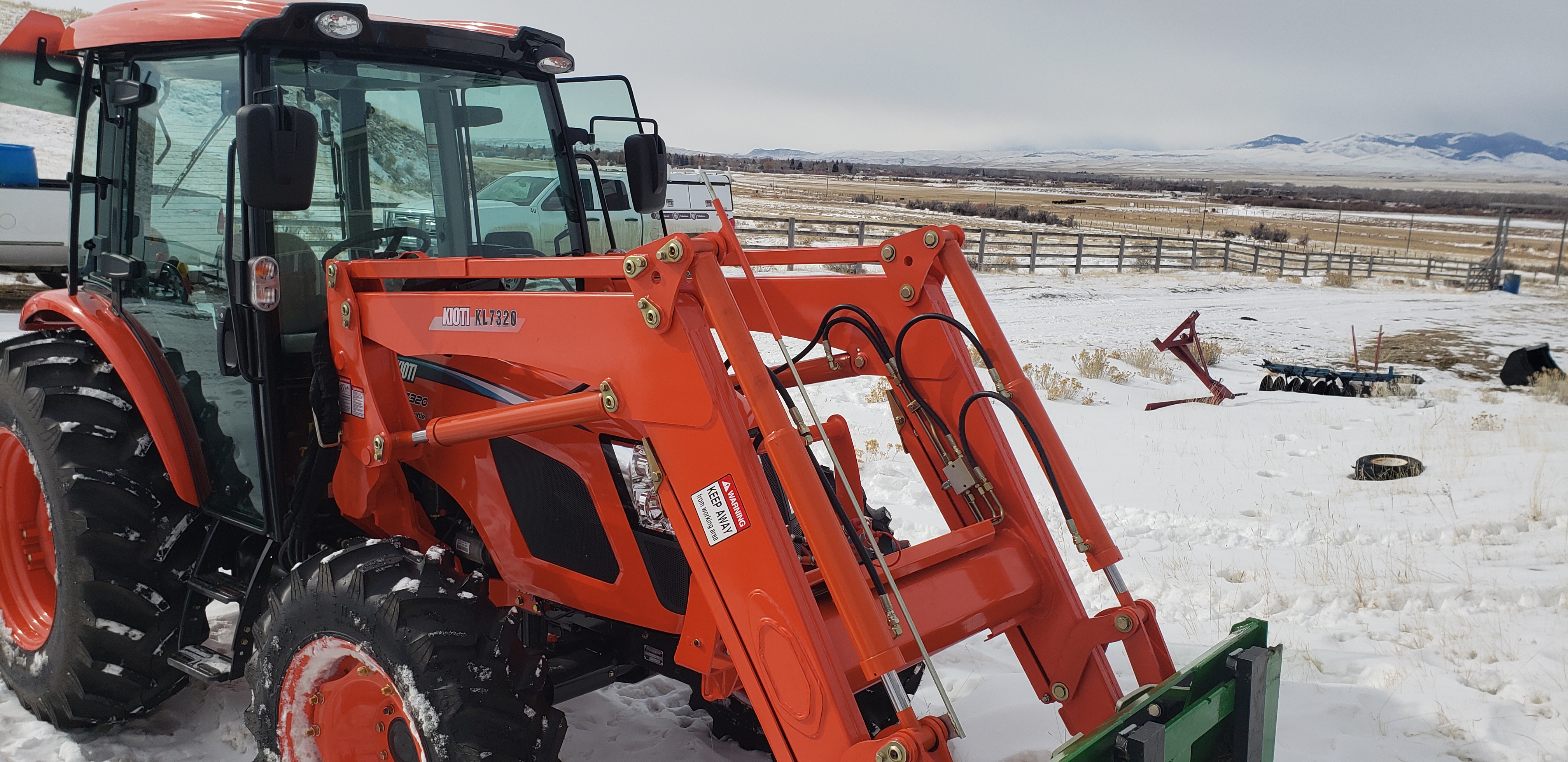

Here it is! The wait is finally over! I will have to repaint the forks to match the new brand, but it handled my pallet of firewood with ease!
