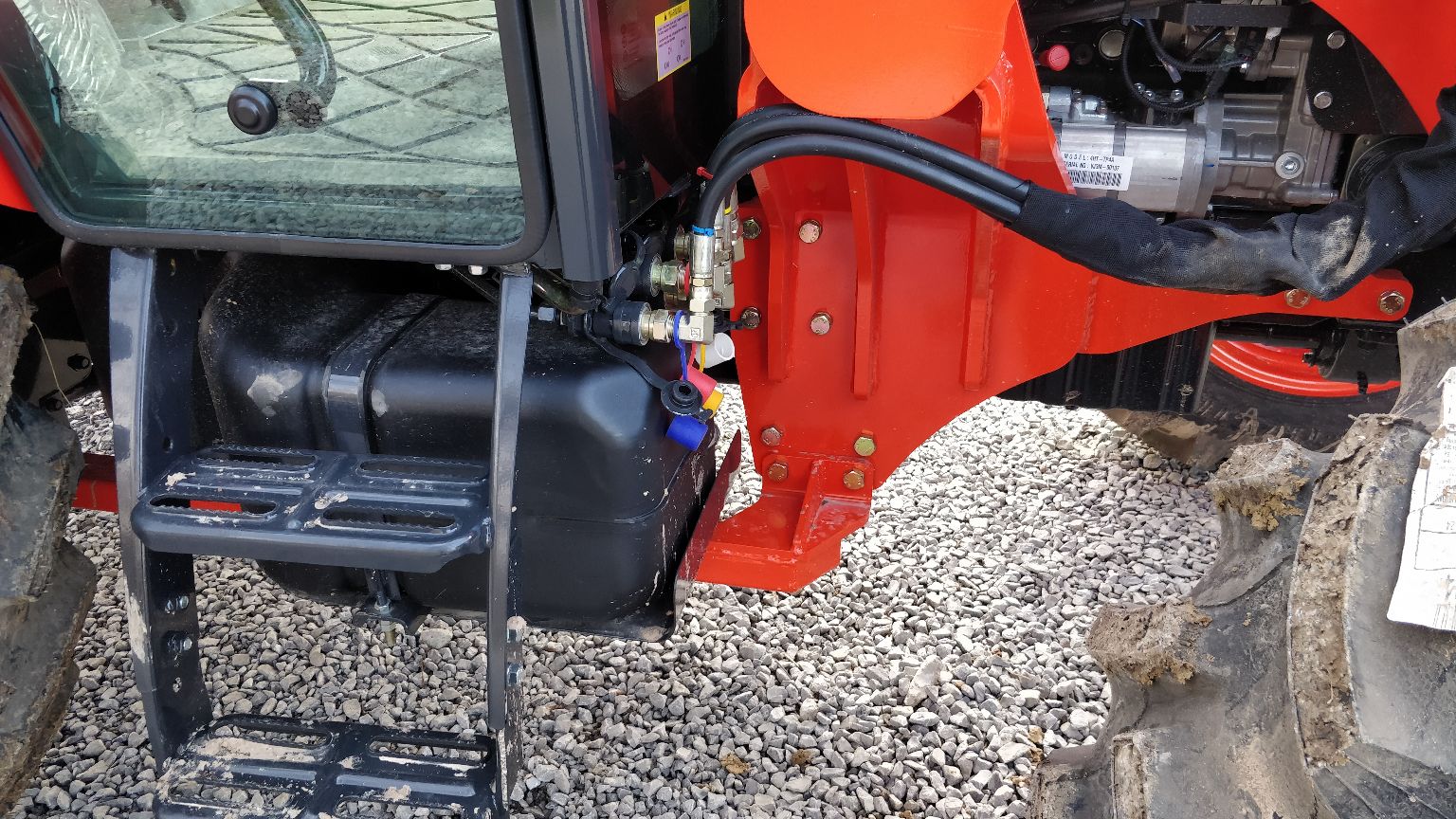

Thanks for sharing as I've been interested to see what Kioti came up with. I imagine their mounting the valve body on the side to avoid the labor of mounting it on top of the transmission.
More than welcome for the pictures.
That's what I was thinking as well. But at least on the NX line, it is pretty well protected from sticks, branches, etc. Fully enclosed, however, looking at it now, the only thing I might change is to have the (2) hoses coming into the box mount in the 'up' position rather than the 'down' fashion they are currently. Would just give them a little more ground clearance and less likely to get snagged.
I do know when I was the dealer looking at the CK & DK lines, one was NOT fully enclosed in the metal box like the NX is. Not sure exactly which one it was as I was primarily only interested in the NX. But either way, seems rather dumb to not put them all in the box IMO.

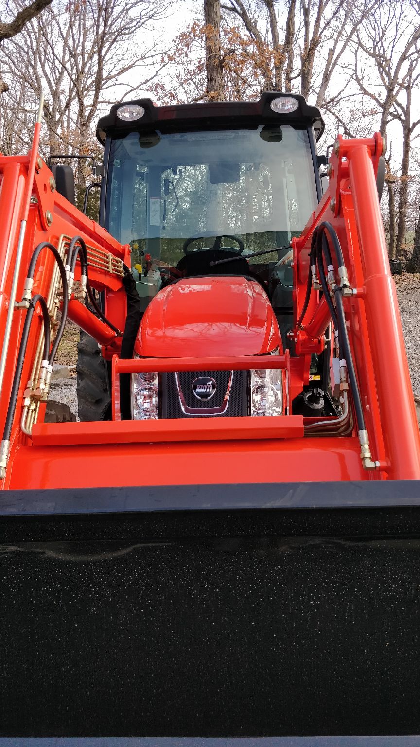

Ok made some tweaks today. I did happen to have some grommets and found one that fit perfectly in the hole. I also reran the loader hoses. This was a little more involved than expected. I wanted to have them facing down like pic provided and other pics I was able to locate. But with the hoses being fastened to the hard lines on the loader I couldn't get them to rotate in the right direction. So I had to remove the hoses from the hard lines, attach to quick couplers in correct orientation and then reattach to hard lines. Got very soaked in hydro fluid. Even after I ran them facing down I still had a problem with hoses hitting the tire when turning sharp. I noticed there were two holes in the loader and I was able to put a zip tie through the holes and hold the hoses up and out of the way of the tire. Not sure what these holes are for, maybe for the forth coming 3rd function? Anyway, resolved for now.

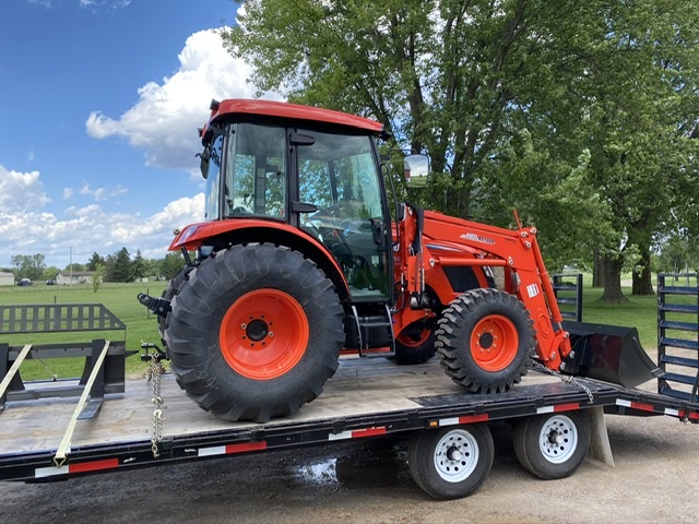

Nice looking tractor, the loader frame looks pretty substantial.
Quite similar to the one on my Branson 8050 which makes it very difficult to check the oil.
The loader frame is taller then the frame rail and makes it difficult to reach down to the engine oil dip stick.

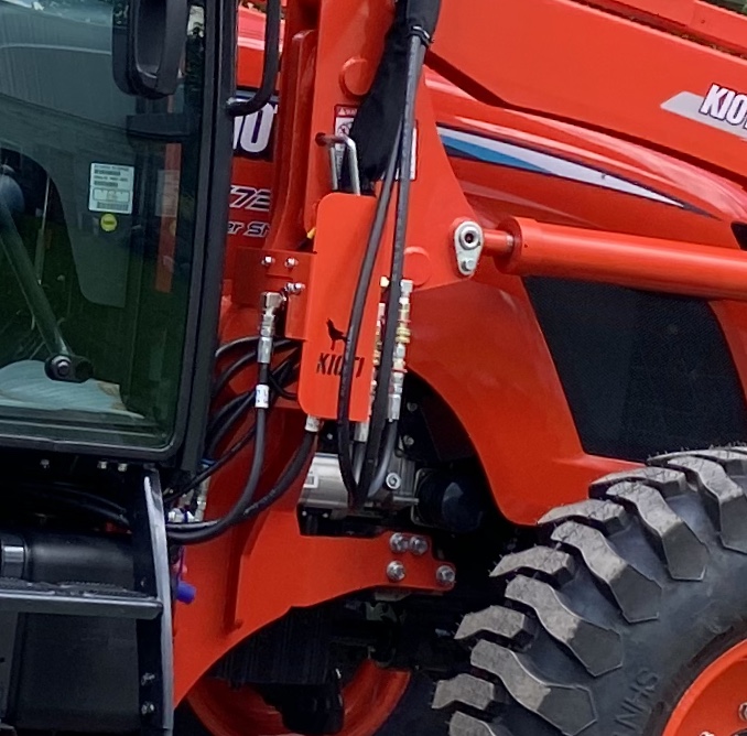

So, weirdly my factory 3rd function doesn’t look like anyone else’s here. New design already?
The loader bracket is now orange and looks better IMO. But instead of it being hidden on the side, I have a fairly large bracket that says Kioti with the valve behind it. Odd!

Yeah, that is a bit odd. My dealer installed the WR Long version before I took delivery last month; the solenoid valves are mounted under the cab and all the hoses are inside the boom. I think it is 'blended' in so well you really have to trace the hoses to even see it is there. I'm sure the Kioti kit is nice, but I'd be watching that setup for snags. I can take and post a pic if you think it helps.

So here are the pic's of the Kioti 3rd function for the RX7320. It is a very nice clean setup. I only wish it included hard lines along the loader arms like the other hydraulics.
