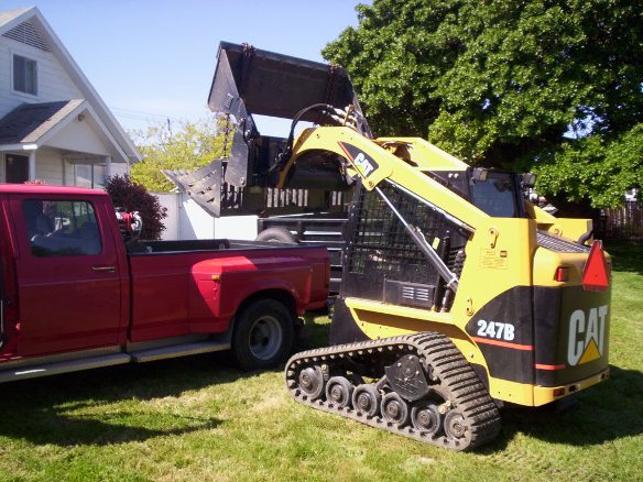

I try to avoid as much road use as possible, but my CAT 247B tops out just over 7 mph, so I trailer whenever distance is an issue, just for time issues if nothing else. I've driven a few miles to quite a few local cut and grade jobs though, and the wear isn't much.
You can reduce wear by making very gradual turns, and avoiding pivot turns by doing a 3 or 4 point turns. This will definitely reduce wear.
I would avoid doing a lot of high speed distance runs if you have steel bands in the tracks though. The steel really heats up from continual high speed flexing which can cause early track delamination. The CAT tracks use a kevar/fiberglass/rubber bias ply which is less prone to this type of heat up. A similar construction is used in the huge CAT Challengers that top out at 24 mph.
IIRC, the ASV track is virtually the same as the CAT since they share undercarriage technology. Don't forget the slow moving vehicle triangle on the back when running on the road. It's cheaper than a ticket. :D
See the fancy triangle?.... :D

Hey Shark, the Cats already have a "built in" triangle:rolleyes:
