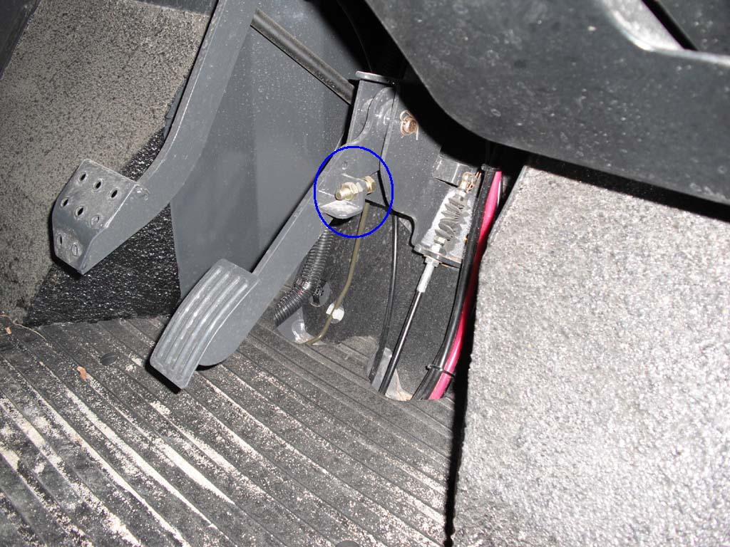

I have posted bits and pieces of my thoughts on the RTV500 cable adjustments in various threads and though I would consolidate everything here. Some information has come from discussions with the dealer but most is just my figuring on the RTV500 transmission works. If you have doubts, talk to your dealer mechanic.

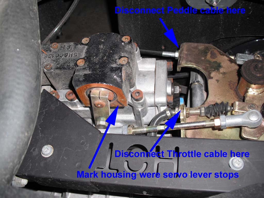

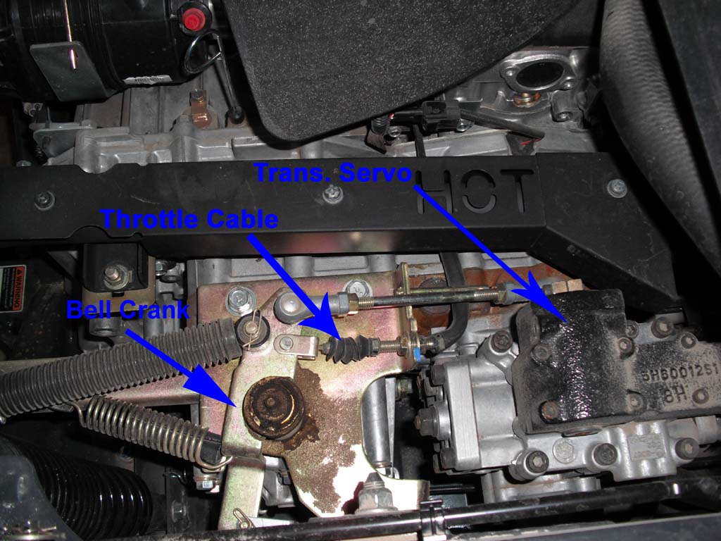

The throttle peddle operates both a servo valve on the transmission for controlling the transmission ratio and the throttle cable to the engine governor. The cables and peddle stop need to be adjusted so that when the peddle is pressed to the stop, the servo valve reaches its maximum travel and the engine throttle is pulled to the stop on the governor.
First, find the maximum travel of the transmission servo. Disconnect the peddle cable and throttle cables from their stays near the bell crank (see pictures for where). Move the bell crank by hand until it stops. Mark the servo valve housing with a fine line so that you can see where the full travel point is for the servo.
Reconnect the peddle cable. When you press the peddle to the stop, the servo valve should stop just short of the full travel point you found and marked. Adjust the bolt stop under the throttle peddle if necessary to get the correct position on the servo valve. You want the bolt to be the stop in the system not the valve so when you ram the peddle to floor the stop bolt is taking the force of your foot not the valve.

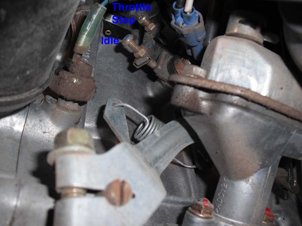

Now put the throttle cable back in the stay but leave the adjustment nuts loose. Have someone hold the peddle to the floor and adjust the throttle cable so that it just pulling against the stop on the governor.
There is an adjustable stop on the governor for the full throttle position. This stop will control the max engine speed that the governor will regulate. According the dealer, maximum unloaded RPM should be 3650 to 3875 RPM. I did not see where Kubota publishes a speed/power curve for this engine but that RPM range must be where the engine makes peak power. Since there is no tach on the vehicle, you would need a tach with a clamp on ignition probe to check the RPM. If you do adjust the throttle stop, then re-adjust your throttle cable.
