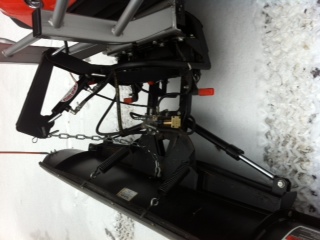

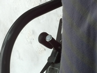

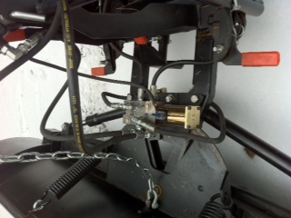

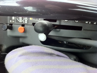

Sorry for the delay on the pictures but I forgot. Here they are. I used a doorbell button mounted to the hydraulic lever to switch the flow from angle to up/down function.

I'm trying to get my head around your set up...I like what i see so far.
/ RTV Plow electrical connection #13
Timswi.
Basically i just replaced the manifold that came with the Curtis plow with an 12 volt electric solenoid manifold that when I push the doorbell button it lets me angle the plow otherwise the lever operates the up/down function of the plow. This works much faster than the electric lift that came with the plow.
