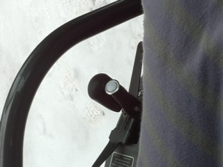

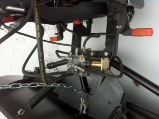

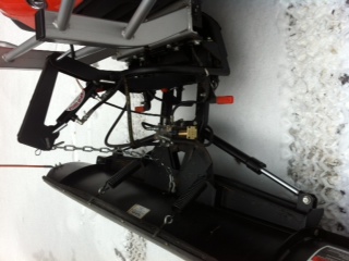

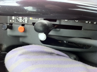

Sorry for the delay on the pictures but I forgot. Here they are. I used a doorbell button mounted to the hydraulic lever to switch the flow from angle to up/down function.

Basically i just replaced the manifold that came with the Curtis plow with an 12 volt electric solenoid manifold that when I push the doorbell button it lets me angle the plow otherwise the lever operates the up/down function of the plow. This works much faster than the electric lift that came with the plow.
Randy

Curious - with this set up, do you need to worry about down pressure or does the plow 'float' in the down position? I've been thinking of doing this mod but concerned about about the additional wear on the plow board and the driveway.
/ RTV Plow electrical connection #15
Stuckinnj,
The plow floats since the hydraulic cylinder only controls the lift chain so there is no down pressure on the plow except for it own weight. If I could use the cylinder for down pressure I would have a bulldozer but thats not possible with this setup.
