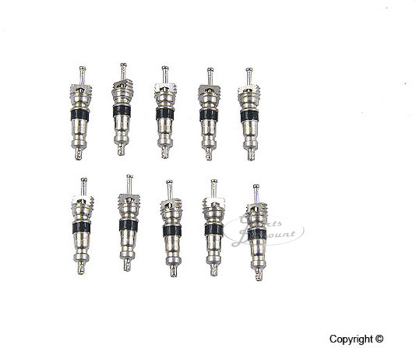

Another thing to check is the schraeder valves (the guts of the valve stem). I have found that many times a slow leak was caused by the schraeder not tightly seated.
I'm old enough to remember valve stem metal dust caps with schraeder keys on the end for removing / tightening the schraeder valve. (Still have a few.)

not tight.. or just leaky.
they are so chep to replace.. it's worth a shot.
they sell tools to rethread and recon the seat area... it's a multi tool.. removes, cleans seat and threads, then you can put a new one it.
no law says you can't put a lil thin ptfe paste on t he seat seal either.. :)
