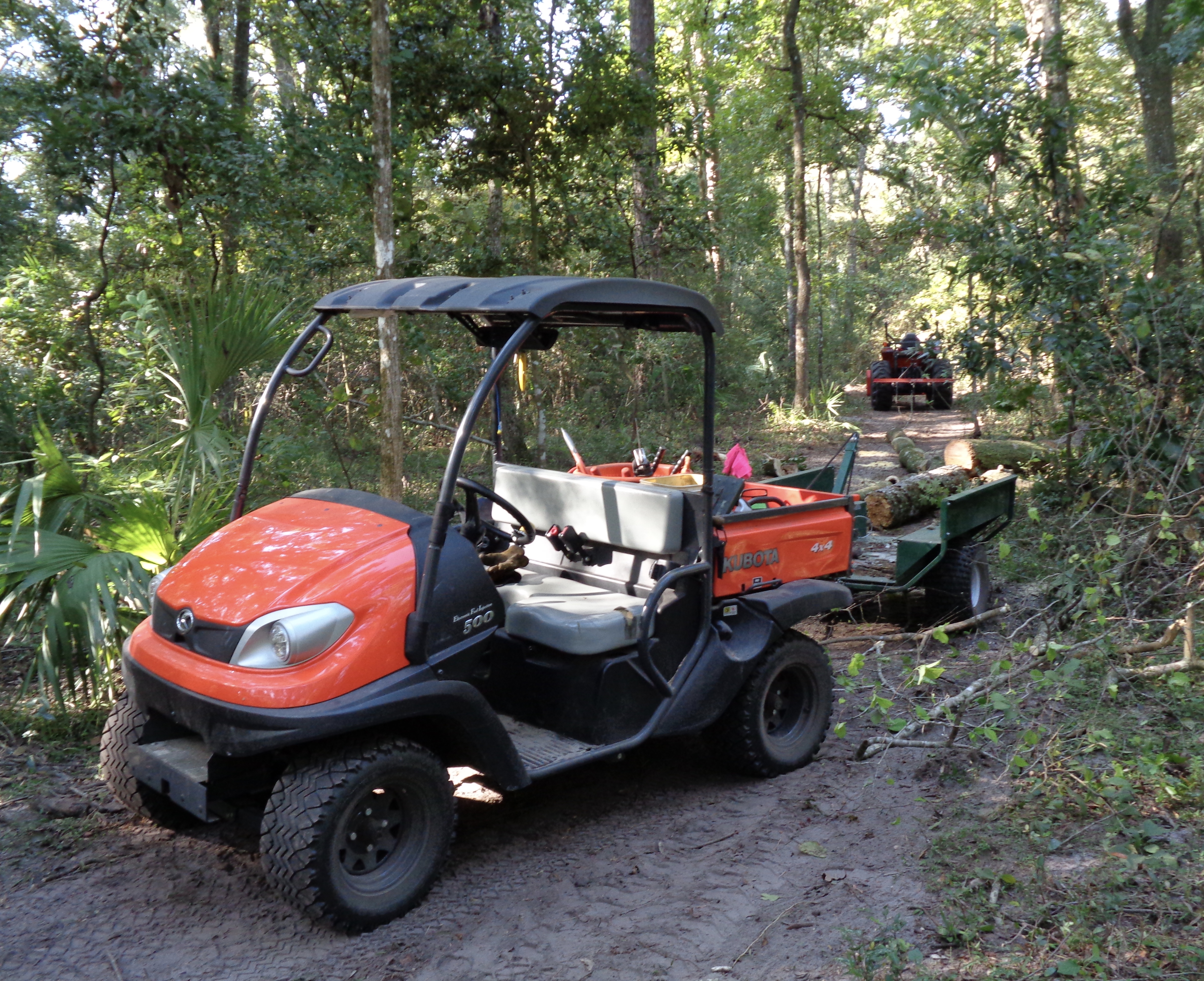

I've decided it's time to buy a utility vehicle. It will be used only for work around the farm, so I'm leaning towards a Kubota RTV. The RTV 500 only has a manual dump bed, so I think I may buy the 900.
I'm 66 years old, so whatever I buy may be with me the rest of my life.

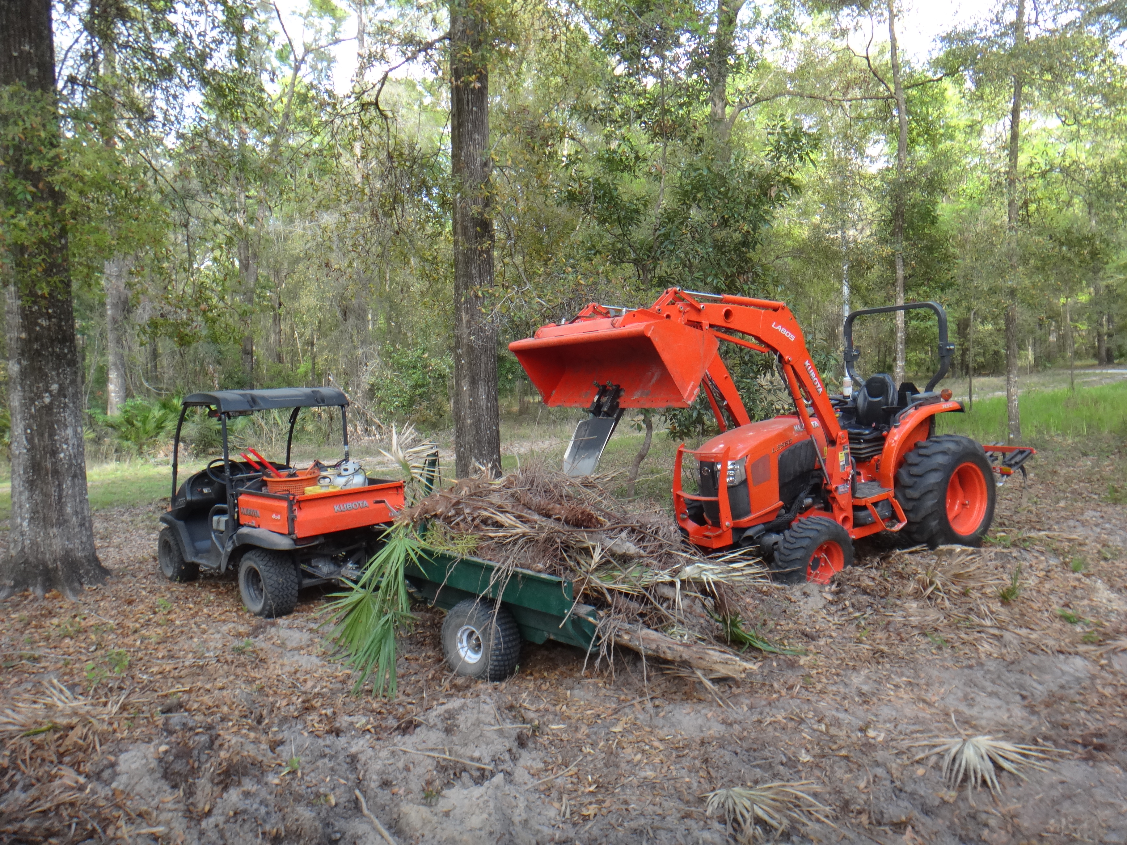

The gas RTV500 is quite a bit quieter than the heavier diesel RTVs. RTV500 has a tighter turning circle.
I did not plan it this way but the bed of my RTV500 has filled with two Stihl saws and an ammo box with saw accessories, saw fuel, chain oil, a Sawzall, two sizes of loppers, etc. Other tools ride according to need.
Loads go in my MUTS dumping trailer which is easier to load with dirt, brush, etc., because of its low sides.
The only time I tilt the RTV500 bed, which is load distribution biased toward the rear to assist dumping, is thrice per year when I clean the RTV500.
Consider the Turf Tire option on my RTV500. They are more akin to R4/industrial tires than turfs.
