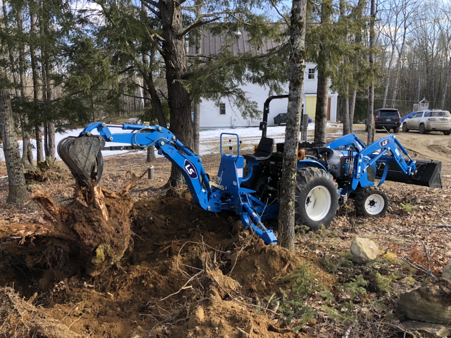

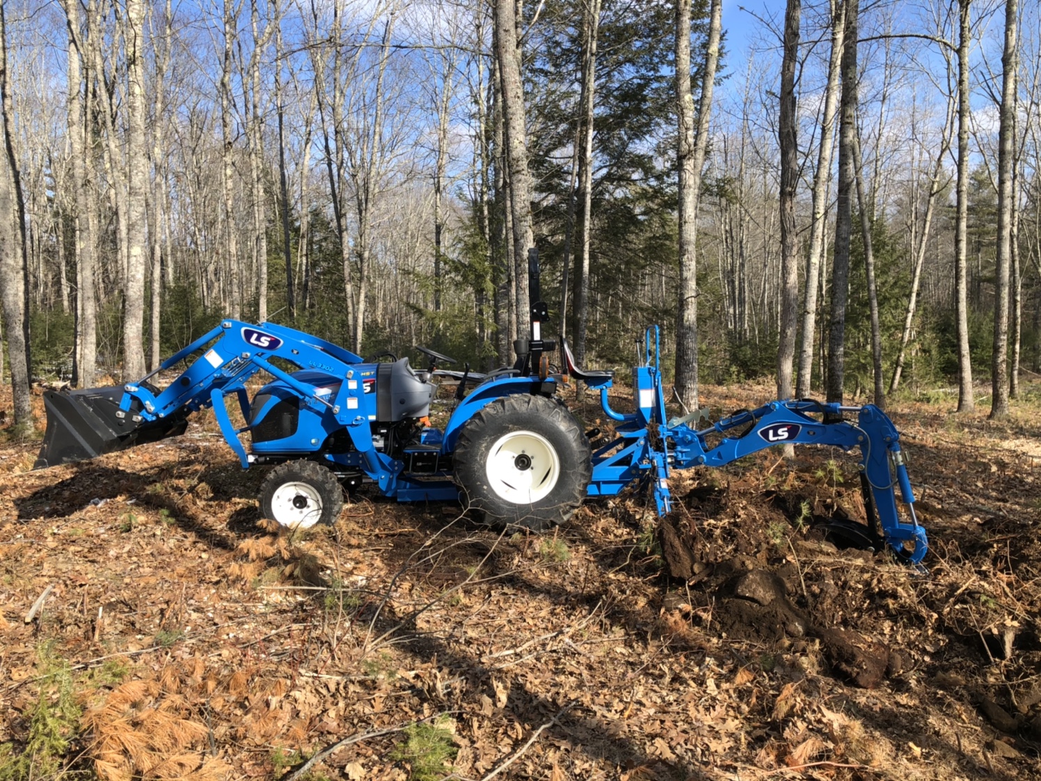

For my XR4140H, I run most functions at RPM above 1500. Loader work higher for power, BH work also slightly higher for better control. So, when I hardly notice when I get a regen every 40-50 hours---just keep on working. I get a "feel" for how well the tractor can handle the task staying comfortable within my operator capability.
   / RPM while using backhoe? #24
Duh, I did not think about the larger HP tractors with emissions stuff. I am below the 25 HP, so no emissions system. In that case, definitely run at higher RPMs. I could see the lower RPMs and loading the engine clogging up stuff quick.
If my BX had emission control where I had to run a PTO speed+ all the time I would be looking at putting a restrictor in the power feed to the BH to slow down the movement. I have full pressure around 1700 RPM. Over 2000 RPM movement gets fast and jerky. Working around obstructions like I do a lot it gets to easy to smash stuff inadvertently.
Ron
   / RPM while using backhoe? #25
What speed do you all keep your tractor at while running your BH? My manual basically says it up to the operator, higher RPM means faster movement. Anyone have a sweet spot? I don稚 think pinning the RPMs is the best idea either. It痴 on a MT240HE.
Thanks all.
