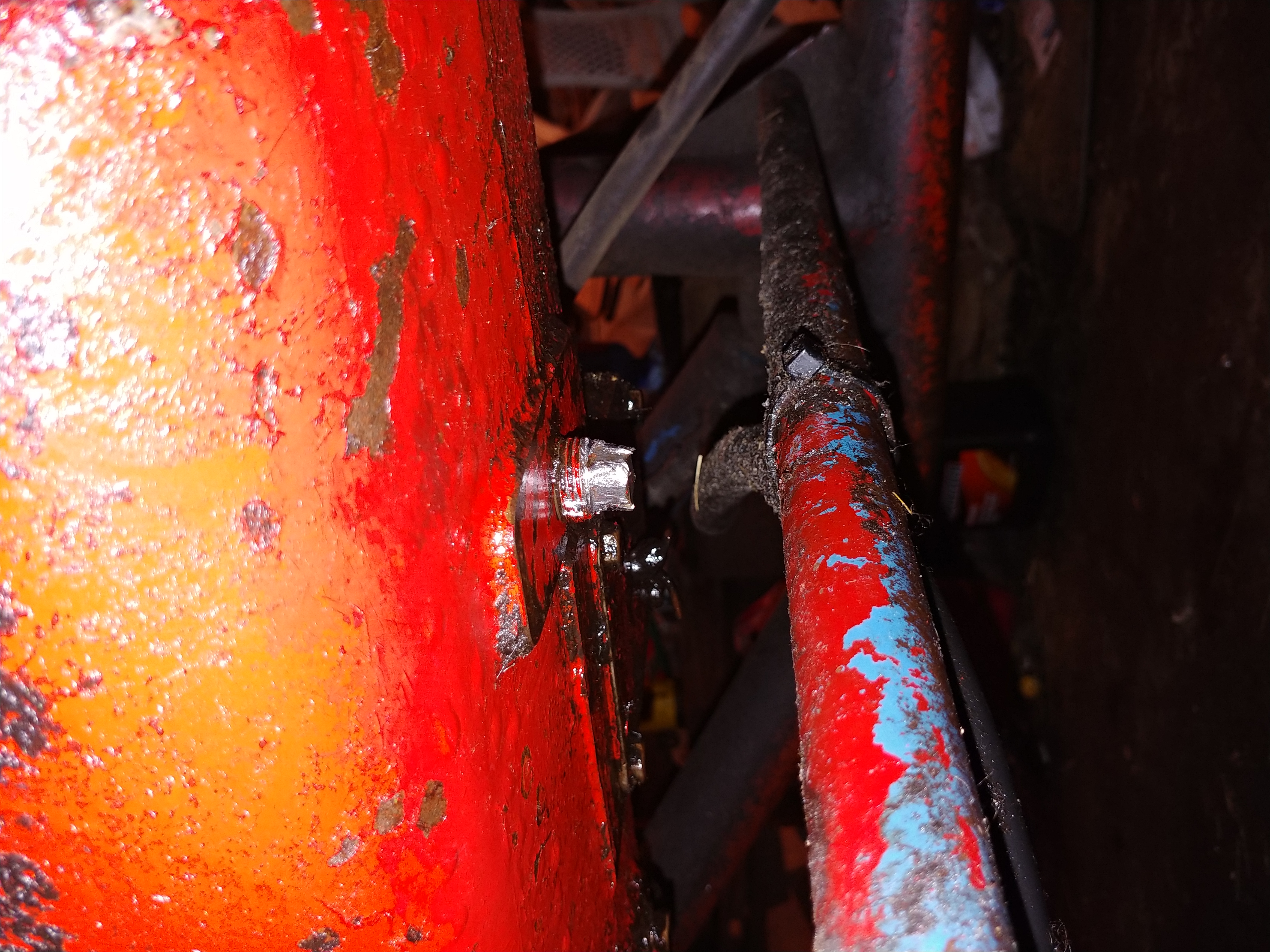

The problem with most pipe wrenches is the wide body of the wrench. The jaws are narrower than the body. Due to the wide flat bottom of the tranny pan and the short 1/2" length of the plug head, the body of the wrench will hold the jaws down far enough that they barely have any bite on the plug.
short wrench / long pipe
/ Rounded off drain plug #62
Agree; the trick is to not use too big of a wrench with a lot of bulk. Maybe a good quality 12-14" American made wrench with sharp jaws (not a wobbly or dull import).
/ Rounded off drain plug #63
^^^^ Also a piece of wood could be inserted between the pipe wrench and the pipe to help hold the wrench in place. If necessary a floor jack could be used to help hold up the pipe so that it doesn't bend. Now that pipe wrench is not going to slide off.
/ Rounded off drain plug #64
Years back I had an F510 Deere front mower with a plug situation like this. I've taken a number of bad plugs in tight quarters out before but this one was the worst. It took a couple hours, I rounded it off and still couldn't get it out. I finally did and welded a new nut on the bottom. The space was so tight almost nothing would fit. Even then, I had to grind the nut down to get the plug back in. These engineers should stick to trains.
/ Rounded off drain plug #65
That may all be true,..... but look at the amount of threads showing also.
The OP can put the pipe wrench jaws on the plug threads, instead of the smaller, and now totally butchered 1/2" long plug head.
The threads have a much greater surface area for the pipe wrench to grab.
This is NOT a machine shop necessary fix!
/ Rounded off drain plug #66
The way it looks to me, I'd try a basin wrench, backed up with a crescent wrench for leverage. The basin wrench will reach up/onto the threaded part of the plug, and the crescent wrench on the shaft of the basin wrench might give enough leverage the loosen it up

Kando: re the plug. Chances are your pipe wrench is too large, the fit is not set properly or the pull is in the wrong direction. There's is a lot of information on use on the Internet.
Suggest a smaller steel pipe wrench with a piece of pipe over the handle for extra Leverage.

Tried the smallest pipe wrench I could find, 8 inch. Cheap jobsmart one though. Looking into a trip to Lowe's to look through some better quality ones.

Maybe try a good quality 12 inch wrench.

No wonder you could not move that plug......an 8" cheapo pipe wrench?
Both Lowe's, and HD have decent pipe wrenches.
If you use a 12" or 14" wrench, you might also need a piece of pipe as a cheater.
#75
Problem with a larger wrench is the size of the jaws, more out of contact with the plug than on.
