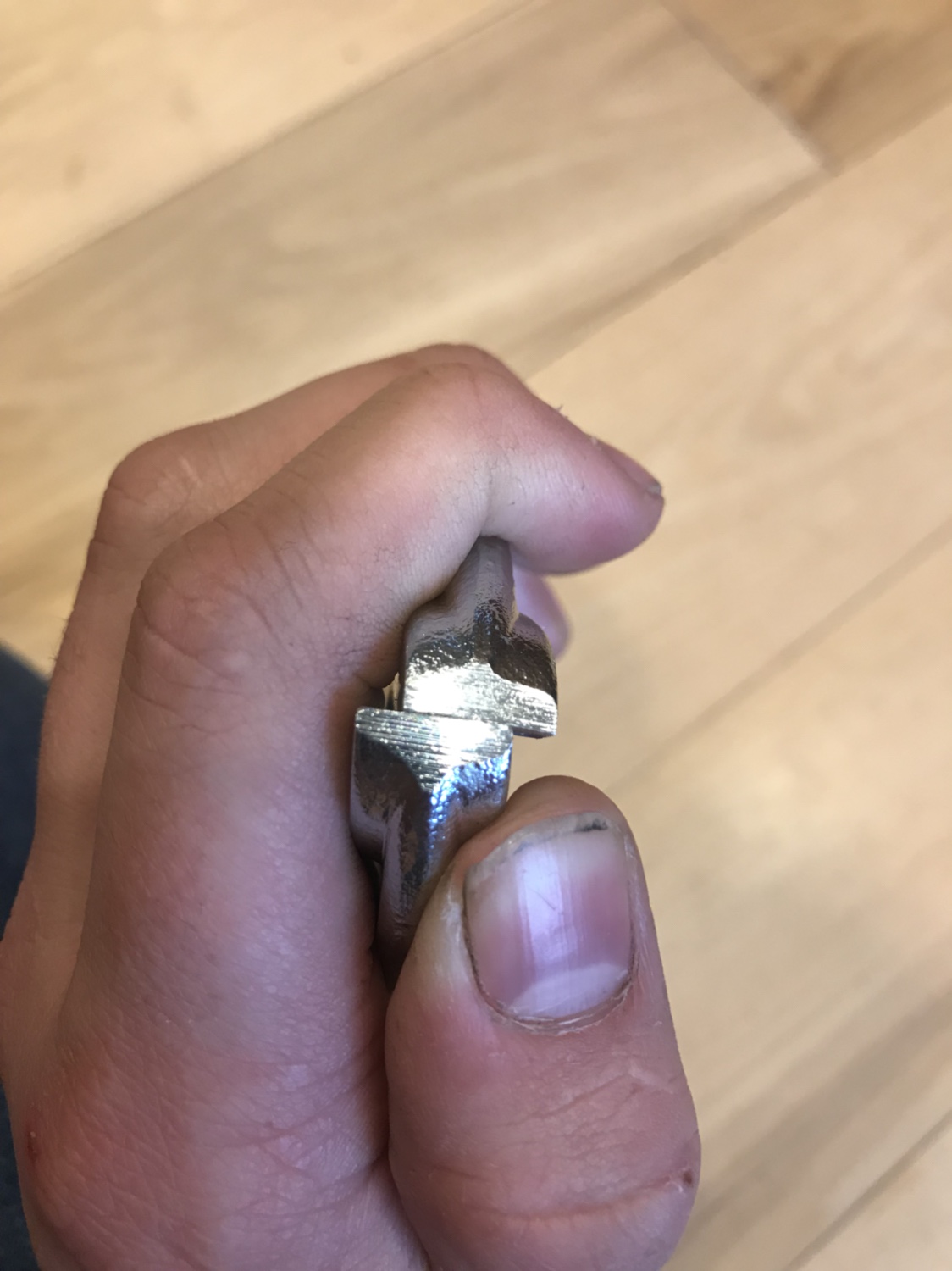

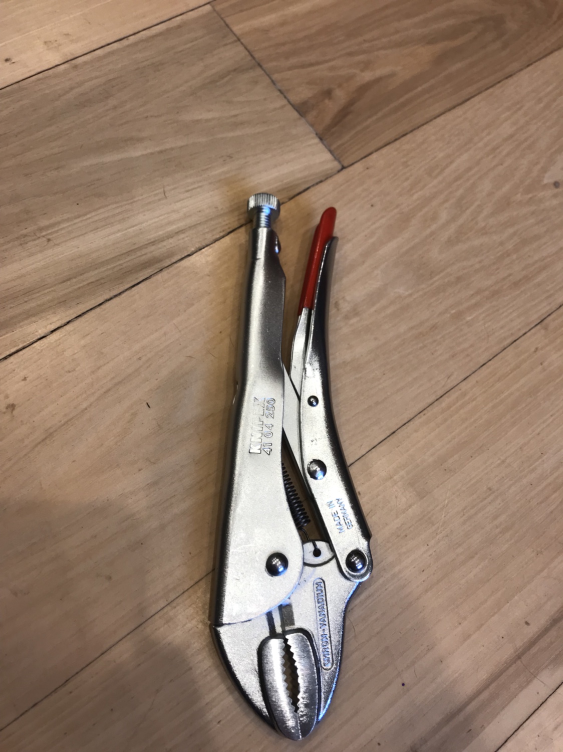

Here’s the first Knipex tool Im disappointed with. I own several pairs on knipex pliers of outstanding quality. My buddy is a snapon addict and in general I wouldn’t trade my Knipex pliers for his snapon. He bought a pair of locking pliers. I wanted to see how the knipex compared against vicegrip and snapon. I got these in the mail yesterday and I’ve never used them so I can’t say how the teeth quality is. The jaw rack is pitiful. I’ll be sending these back. If these were $5 China crap you could probably squeeze the body in a vice and tighten them up but these weren’t supposed to be crap.View attachment 592779View attachment 592780
Knipex is supposed to have 61 Rc jaw hardness. ... Clamp those on a dowel pin 1/4 turn tighter than you can possibly do by hand, Use a vise to operate the handles. A Vise Grip wont make a mark because the jaws are too soft. If it leaves a mark that is a superiority. If it doesnt, can you now close it at the SAME setting by hand? If you can, advance 1/4 turn and try again. Same result; it is inferior to Vise Grip.
