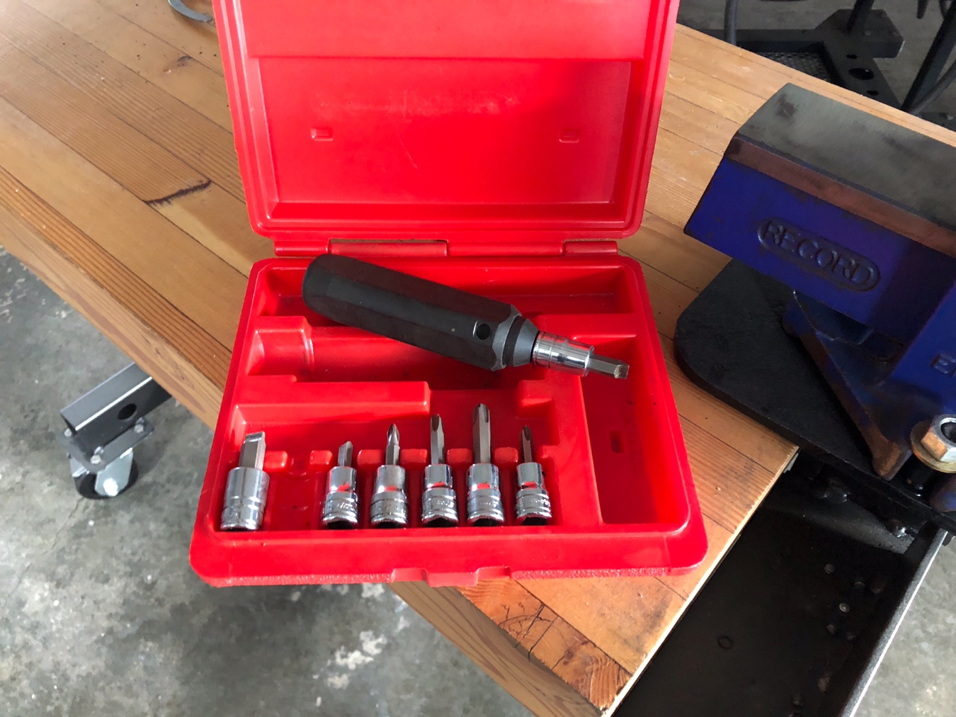

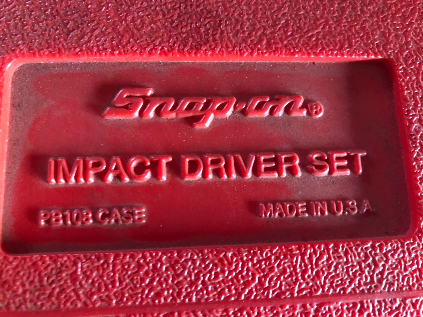

Is the screw head rounded or dome shaped designed to be driven with a straight blade or Phillips driver?
If so the Knipex will prob not work.
After soaking with penetrant I would use an impact driver.
Those impact drivers are the greatest device since sliced bread.
The favorite tool for motorcycle mechanics.
I like it so much that I have 2 in my tool box 'Just in case' LOL.
Steel screws in aluminum will always be seized and this tool will always persuade them to come loose with one simple rap of a hammer.

That's for sure,I discovered them when I got into boats, many years ago. Talk about a hostile environment for fasteners, take a little salt water and dissimilar metals and you need all the help you can get.I bought my first impact driver at a marine swap meet for $5 and still have it. It's the best of 3 that I have accumulated over the years.

What brand is the one you like the best?
   / Rounded off drain plug #1,307
My old favorite that I got at a marine swap meet is a BICO,I don't know if it's made by a big tool co. or what. The guy I bought it from said it had been his Dad's and that he'd had it for years. When he passed away the son didn't even know what it was or was used for.
I really like the feel of it and it works well.

Picture?
   / Rounded off drain plug #1,309
I'll try to get a pic if the rain ever stops and I can get down to my shop.
