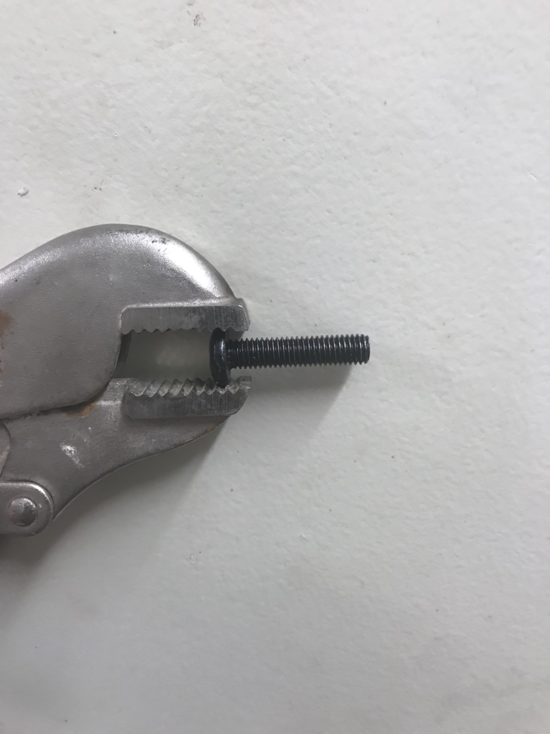

The Knipex don’t grip on the end like the first picture very good. They do grip on the side much better than some of the cheaper pliers. Vice grips grip a lot better on the end. Or you could just cut the 1/4 bolt with the knipex mini cutters. Btw, my knipex were at home so I had to use a crappy pair of Channellocks the picture. IMG_1506.JPGIMG_1507.JPGIMG_1508.JPGIMG_1509.JPG

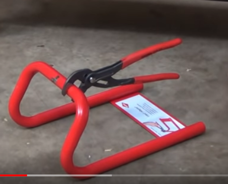

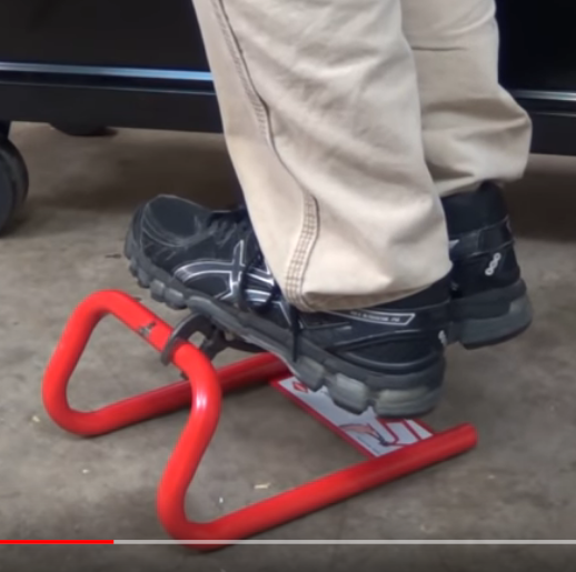

Right, they don't lock like Vice-Grips. But once you squeeze them where you want them, you can put all the pressure on the top handle, you don't have to squeeze the handles together like regular pliers while turning: Knipex Cobra Pliers - MADE IN GERMANY - YouTube

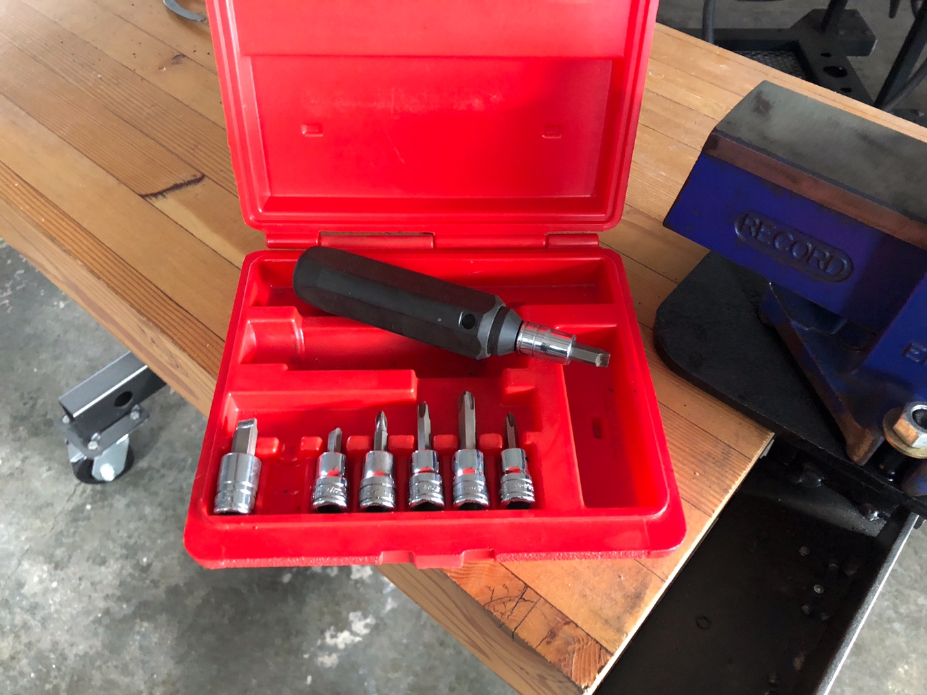

I tried the impact driver and vise grips before ordering the Knipex. The screw head is a slotted type and I've been very careful to not bugger up the head, even messed up the end of a cheaper screw driver. I'm kind of afraid that it is locked up due to electrolysis as the armature shaft is stainless,I think, and the screw is mild steel and pretty rusted and nasty looking.

There isn't room , and because it's in a slight dish and the head is so thin I couldn't get e good grip with an adjustable wrench. Also I have used a "good" screwdriver, the one I messed up was a cheapie though.The driver heads for my impact driver, which is over 40 yrs. old , are about as "good" as you can get and I widened the slot out to take the thicker of the heads.
