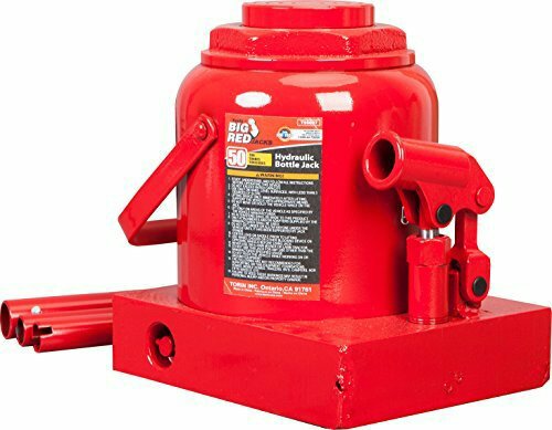

Last resort...
1) 50 ton bottle jack under plug
2) that will push plug up into case
3) drill and tap hole next size larger
4) fish old plug out larger hole with magnet
